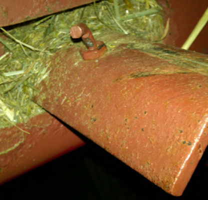

I had exactly the same trouble with mine cutting the string until I did a little re-engineering - I'm assuming that you have the older manual twine arm model?. I found the problem was the twine just wasn't on the "table" (the part the sharpened knife blade meets) when the knife closed down, it had been pulled off the outside edge by the arm. So it didn't matter how sharp the knife was - it wasn't touching the twine! So what I did was to drill a hole in the "table" and put a small threaded pin sticking up with a bit of a hook pointed towards the inside. It had to be low enough that that the twine arm cleared, but high enough that it caught the twine as the arm returned to the parked position. That keeps the twine right where the knife will hit it. With that small fix I went from about a 10% cut rate to darn near 100%. If that's not clear, let me know and I'll try to get a picture and post it.

Beef, yes I have noticed the twine off the cutter on the outboard side. I looked for some type of guide that I may have missed but there ain't one. A mod like you described sounds like what I need to do. Headed to fleabay now.......thanks for the info!

Just got in from baling with the 8420, baled about 75 bales over that past couple days, 100% success rate with the twine cutter.
Here's a couple pictures of my modification. The twine arm swings just to the inside of the hook, you can see where the twine has buffed off the paint from the hook. The hook holds the twine on the "block" so when the knife (first picture, in the up position) drops, the twine is right there waiting for it...

Thank y'all very much for all the info. I just got that Case manual off of fleabay. It shows a "Twine Guide" which is similar to yours Beef, but it's after the cutter. It looks like mine is broken off & I like yours better, so I am going to do the "Beefmod" to mine.
