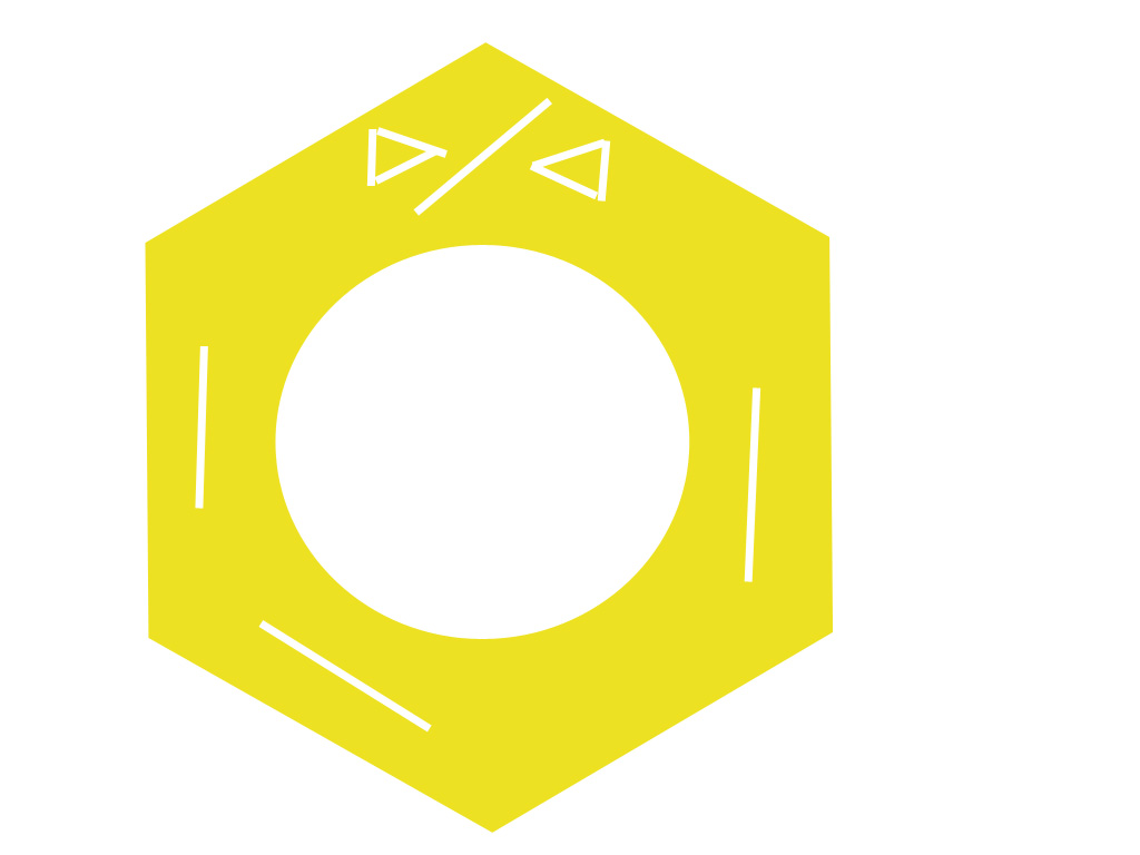

I have searched high and low to find the markings on a nut that I have.
i can identify the the meaning of the three slash marks. Grade c high carbon resitant to elements. But what the heck does the marking with the two triangles mean? Anyone know. see attached drawing.

You are correct about the grade mark. The other marking's are most likely the manufacturer's mark. Many nut/bolt manufacturers also mark all their hardware with a mark not unlike you find on gold and silver jewlery that has "hallmark's". I have a book around here somewhere that has alot of the manufacturers marks in it. I'll try to see if I can find it and look up the mark for you.

Those are still ASTM/SAE marking's though and not manufacturers marking's.

There are thousands of head marking's. Here is a very small 162 page listing of some of the different manufacturers head marking's. This list only covers some of the ones you might run across. http://www.dot.state.il.us/materials/fasteneridentificationguide.pdf
The triangle is found on Vermont manufacturing bolts and nuts. They normally use a single triangle though. Could be thiers though.

Those are BOLT markings and I can find all kinds of them in great detail. However none of the charts you show have NUT markings. Nut markings seem to be some great secret. I believe that the two triangles mean self locking but I can not find anything that verifies that. This site here is one of the better ones and has the slash marks but not the triangles.
American Fastener - ASTM, SAE, and ISO Grade Markings
The reasonI was asking was because they are on the lug nuts that came on my new horse trailer. But they seem to be the wrong size or they have some sort of self locking on them. They will not just screw on and off like a normal lug nut does. You have to use a wrench all they way on and off. It is either that or the factory put 17mm nuts on a 1/2 in lug. This is kinda what I suspect also. Because when I take a regular 1/2 X 20 lug I can just screw it on with my fingers.

If I remember correctly,Those have a interrupted fit, a slight squeeze or miss fit to not let them fall off if they come loose, kind of like a lock nut but not as much so, just a safety factor. John

Did you actually look at the IL state PDF link? It has hundreds if not a thousand NUT marking's. They start on page 82 and continue to page 162.
You can also check the US Patent Office Fastener Insignias Register. http://www.uspto.gov/web/offices/tac/fqa/active.pdf

One triangle is the ID for a Canadian manufacturer.....I just looked through my world list of headmarkings and didn't come across a double triangle.
It's not any known Grade marking that I'm aware of.
I also see 3 lines on the face...are they really as drawn or do they match the curve of the ID?

They match the curve I just could not draw them that way.

If the male threads are 1/2x20 the nuts aren't metric, and certainly not 17mm.
Most likely what you have is an 1/2 SL nut where the self locking feature is obtained by intentionally deforming the threads to obtain a slight interference fit.
Standard metric threads jump from 16 to 18mm and that size nut (.630 to .709 nom. dia) would fall off a 1/2" (.500) stud. The closest metric nut to that size would be a 12 mm (.472) which would be too small to fit. The next larger standard size, a coarse thread 14 mm (.551) with 2.00 mm pitch, might have a minor diameter small enough to engage the threads, but the pitch would be the equivalent of 12.7 tpi. So even if it were a 14 mm nut, and you did manage to wrench it on and off a 1/2x20 stud, either the stud or the nut would be damaged by the attempt.

I guess you are correct. I called the factory they did not have clue what I was talking about so I guess they may indeed be interference fit. I am going to change them all anyway. last thing I want is to be on the side of the road in 100 degree heat twisting 8 of them all the way off and on with two horses stomping all over the place.

I`ve came across those same type nuts before.The triangles indeed are signs of a type of locking or as some of ya`ll are calling them interference fit. They are a pain to get off but never have to worry about one working loose.
