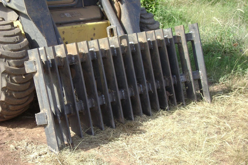

Mowing is out as the owner specified that he wanted all vegetation scraped off of the surface. Letting the piles sit for a while and dry out (thereby reducing volume) may be a viable option.
I am now thinking that my best bet is to windrow the debris. Then I can get a better idea as to how many containers I will need. At the end of the job I can call for the needed containers and load them out with a grapple fork on my skid. I can windrow with this:
I have an appointment with the owner next Tuesday for an onsite walk-around. I should have a better idea what I am up against then.
I appreciate all of your ideas and suggestions.
I am still looking for a way to get a rough estimate of the volume of brush (in cubic yards) that will need to be removed based on the pictures I have provided and the acreage (8 acres) if anyone has any ideas.
