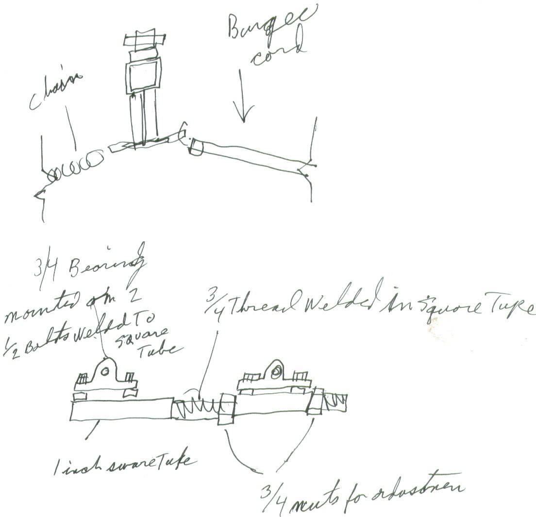

I made a crank from a 1" cold rolled rod welded to a 3/4" bolt with head cut off offset to one side mounted in 2 1" pillow block bearings
then mounted the pitman arm in the sketch to crank and to bolt welded to angle welded under screen frame
a v belt pully on shaft and engine or motor and your in business
the chain and bungee cord are to stabalize pitman arm
an eye will have to be kept on bungee, you may want to have a spare handy

my screen takes no weight at all to shake just the crank
its more important how fast than how far
mine has a total travel of under 3/4"
