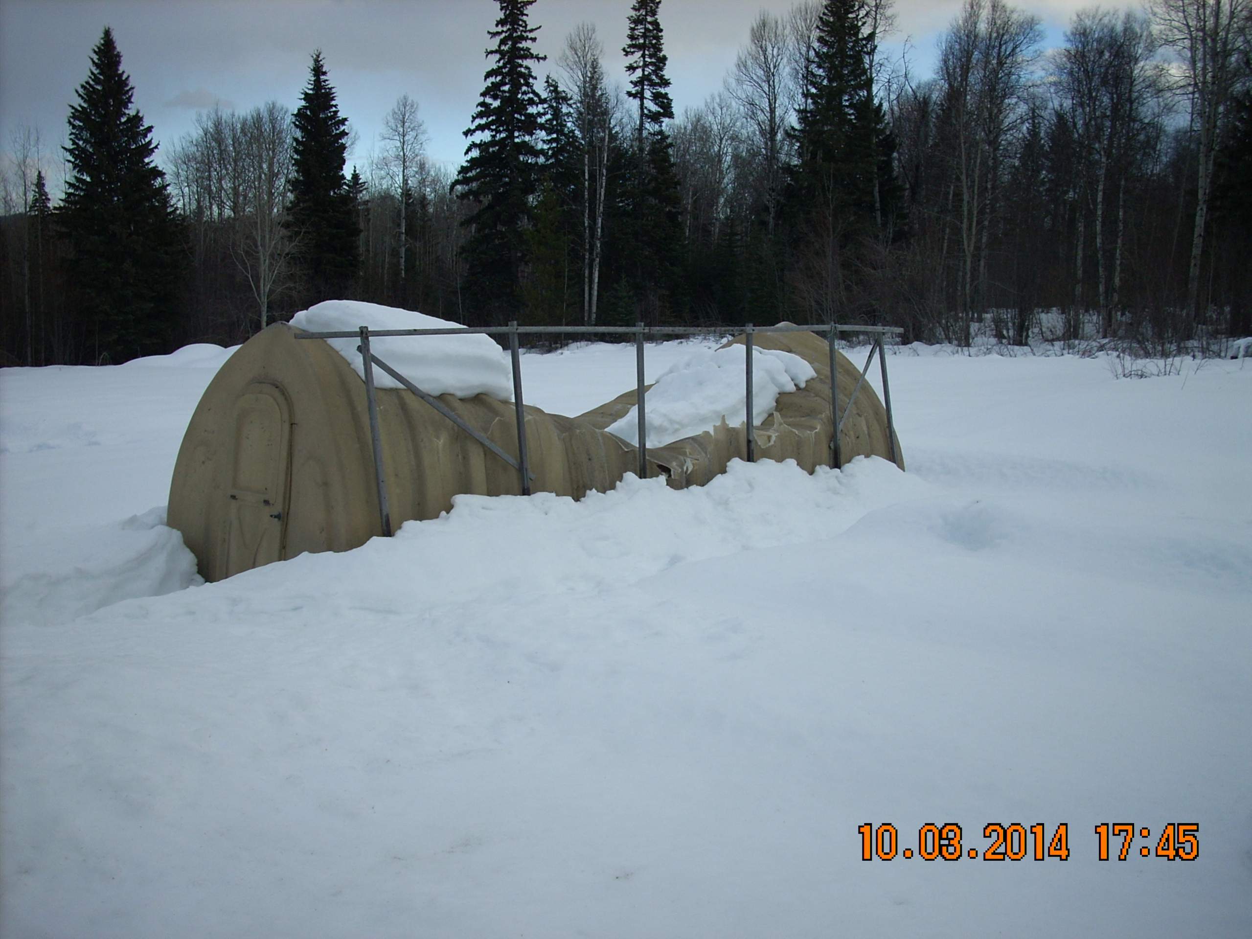

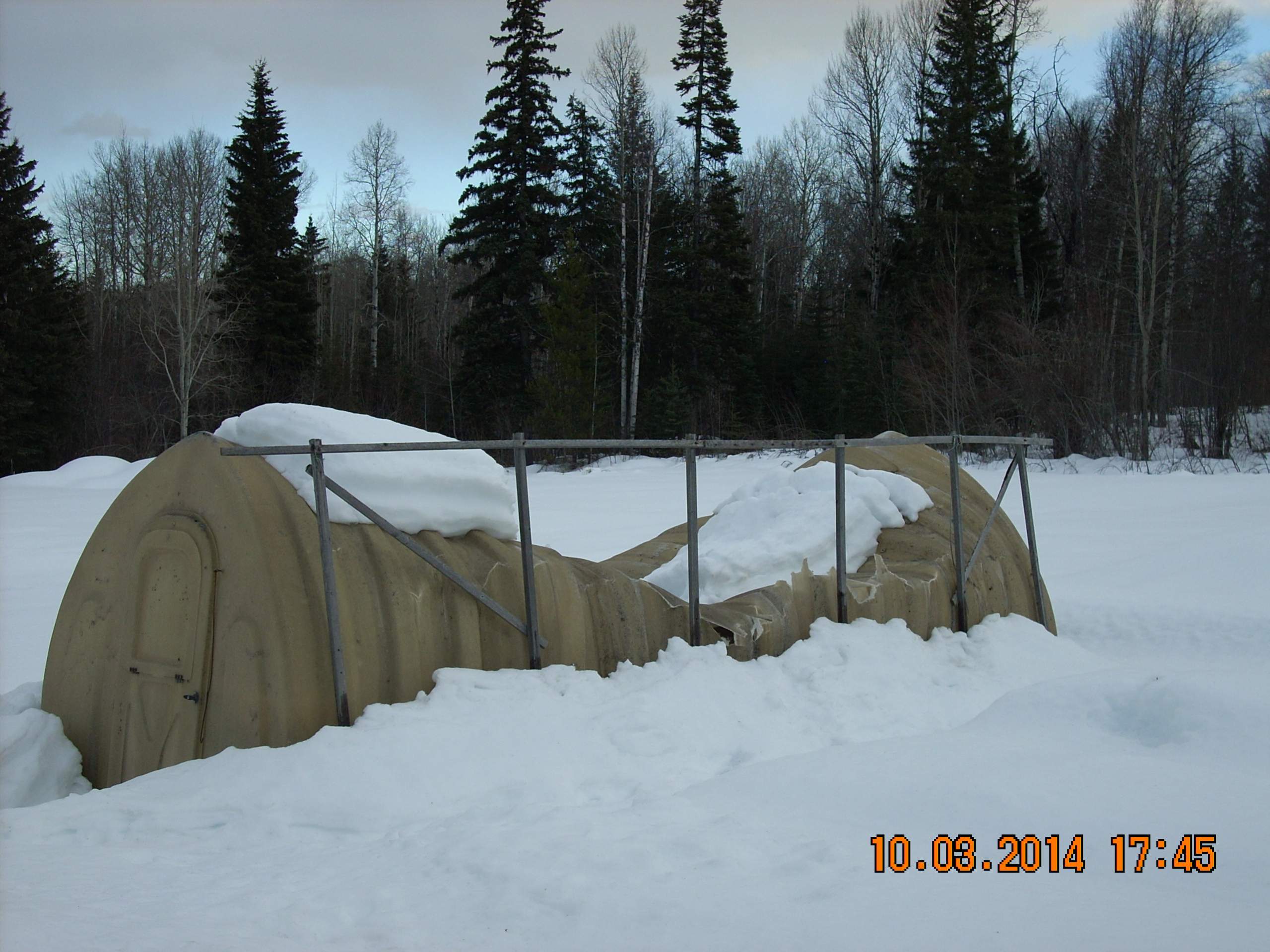

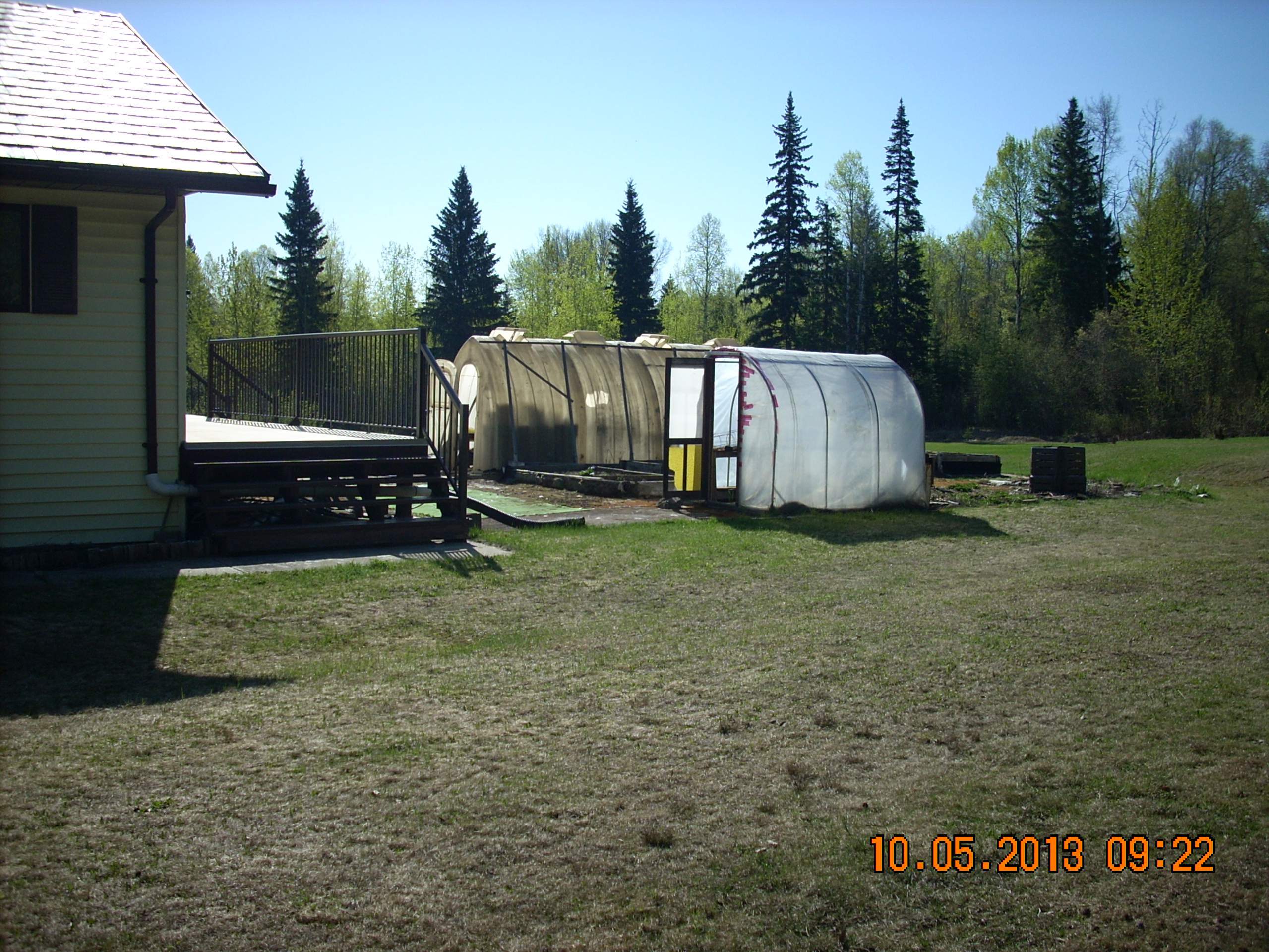

I would add some centre supports inside to handle any snow build up on the roof.
We just had our 20' long fibreglass green house collapse under accumulated snow weight. admittedly the greenhouse is probably 30 years old and weathering and UV rays have taken their toll. However, it never occurred to me to put in some centre supports for the snow load - duh :mad::ashamed::shocked:
Have attached before and after pictures.
Note that the smaller aluminium frame, plastic covered green house did perfectly well :eek::eek:
