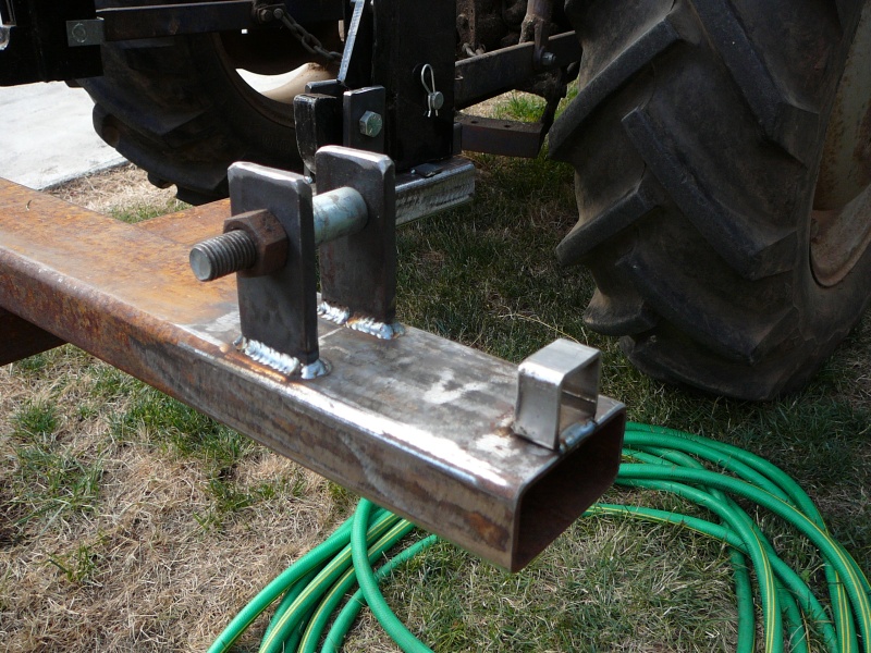

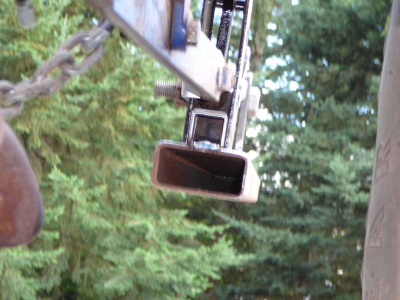

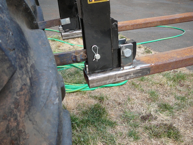

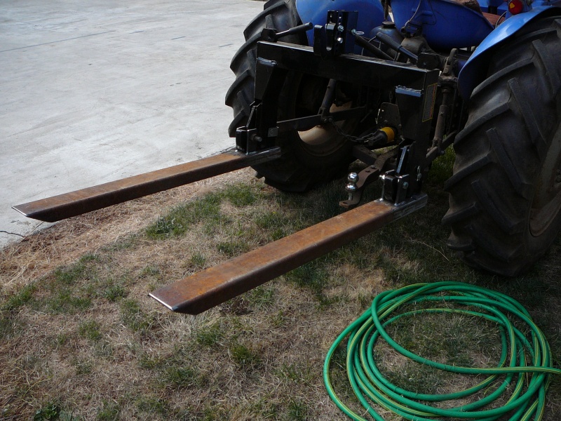

Here is a little something I whipped up for some light hauling. I almost just bought a carryall at Coastal for $125, but came up with this using some scrap I had. I might want to add additional support with longer pins if I think I want to try and pick up some substantial weight, but mostly this is for a box or platform for light items and hauling some lumber from my bandmill. The forks will fold up to a vertical position, a pin could be added from the rear to lock them down.Let me know if you think of any additional mods.

Very clever!! And nicely done as well. Good use of a minimum of materials. :D
/ HF Quick Hitch Ford Mod #3
Very nice work, one of the best I've seen here. Add the pins for fold up and I'll tip my hat to you.

That is just plain nice. After seeing those welds I need to go back to drilling and bolting stuff together.

What size Bolts did you use for the pins?

For as much as I have used my pallet forks thie would have done the job for a lot less money. I would add a small brace to keep the back of the rectangular tubing from collapsing under a heavier load but other than that what a great idea.

I agree with the rest, pretty cool idea and nice fab skills. I haven't got a quick hitch but the way I have been changing equipment on the 3pt lately, I think I might invest in one and this will come in real handy. I wonder how much weight it could handle. I was thinking about going the carry all route for firewood hauling but this would be a lot more versitile. Great job
