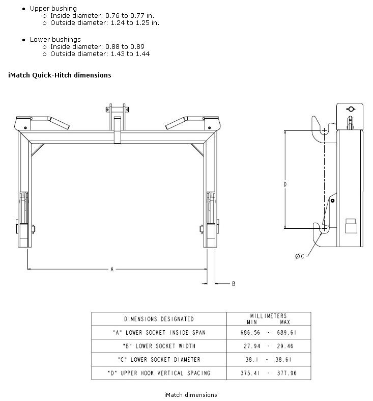

Any pros/cons to the HF QuickHitch when compared to iMatch? Don't have either but figured they look almost identical.
I can not find a dimensional drawing for the HFQH. Here are the dimensions stated on the HF web site:
Inside clearance: 27-1/2". Draw pin adjustments: 18", 19", 20" and 21". Overall dimensions: 30" W x 24" H.
By draw pin adjustments do they mean upper hook vertical position? iMatch hook is welded at 15", see dimension 'D' in attached. If this is correct then the two do not share the same dimensions and therefore one would not be able to interchange attachments without altering the attachment.
I wonder if someone who owns a HFQH could measure and posts all the dimensions shown in the iMatch drawing so we could compare the two side-by-side.

Also, in reply to the question above about the HF dimensions, I think the listed dimensions for the top hook are incorrect. With the hook in lowest position, it is 15" above the bottom pins, which is the standard for quick hitches. In the top or next to top position (I can't remember which) it is 18" which is the standard for cat 1 3 point hitch top link pins. (Some implements have the QH pin also at 15", some only have the 18" top link position.) So from that perspective, the HF is compliant with the QH standard and adjustable to work as a quick hitch with implements without a QH pin.

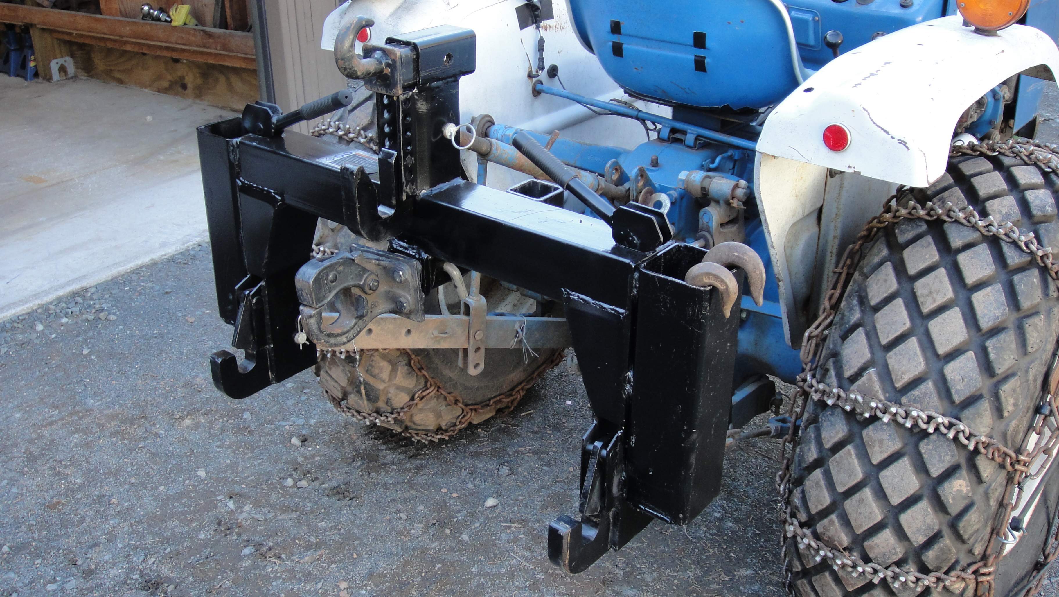

I have both, and as mentioned the HF model top J-hook bolts interfere with some implements, so I removed the bolts (actually just cut them) and peened them in place, now there is no difference in the dimensional specs between the 2.
I wouldn't put the HF model on a brand new Deere, but not because it wouldn't do the job, I would spend the extra money just for the better looks/color of the imatch.
The HF model is definitely worth the 89. it cost me.
Easter Sunday, 25% off single item at HF. Don't know if you will go to he11 for shopping on Easter Sunday though :eek:
You can see in this pic how I cut the bolts and set them as flush pins,along with some other mods :)
JB.

jb4310- I like your mods on the HF QH. I have one and was thinking of adding that 2" receiver like underneath like you did. MY favorite add on I am gonna do is the tubes to hold the chains like you did! :thumbsup: Is there any changes you would make?
Just make sure the receiver tube wont interfere with any PTO powered equipment you may use. I only have a genny and there is no problem with mine.
The box tube I used is 4x4, I wanted 4x6 but couldn't find any, it only holds about 8-9 ft of 3/8 chain. I'm working on my imatch with the same mods, custom making the box a little bigger, maybe 4x5.
JB.
JB.
Oh good point on pto shaft. hmm I think I might have issues. I am gonna have to hook my tiller up, I suspect it's too close.
darn! I was hoping a small square is enough for a 20 ft chain. I'll think of something along those lines.
Yeah someone warned me about the clearance so I tried my genny and had enough clearance in all positions.
If you use 5/16 chain you could fit alot more in there.
JB.

JB4310, I really like the idea of the flush pins. I was thinking of modifying my hook so it would extend farther back, but that looks simpler. Did you weld the pins in place or are they attached somehow so you can still remove them and raise/remove the hook? I can't tell from the photo.

If you zoom in you might see where I took a pointy punch and peened the metal around the studs, to jam them in. Can't think of the right term for this.
I might as well of just welded them, cause nothing I have needs the top hook in a different position, but I wanted to be able to move it if ever needed. The more expensive JD imatch has a fixed top hook.
