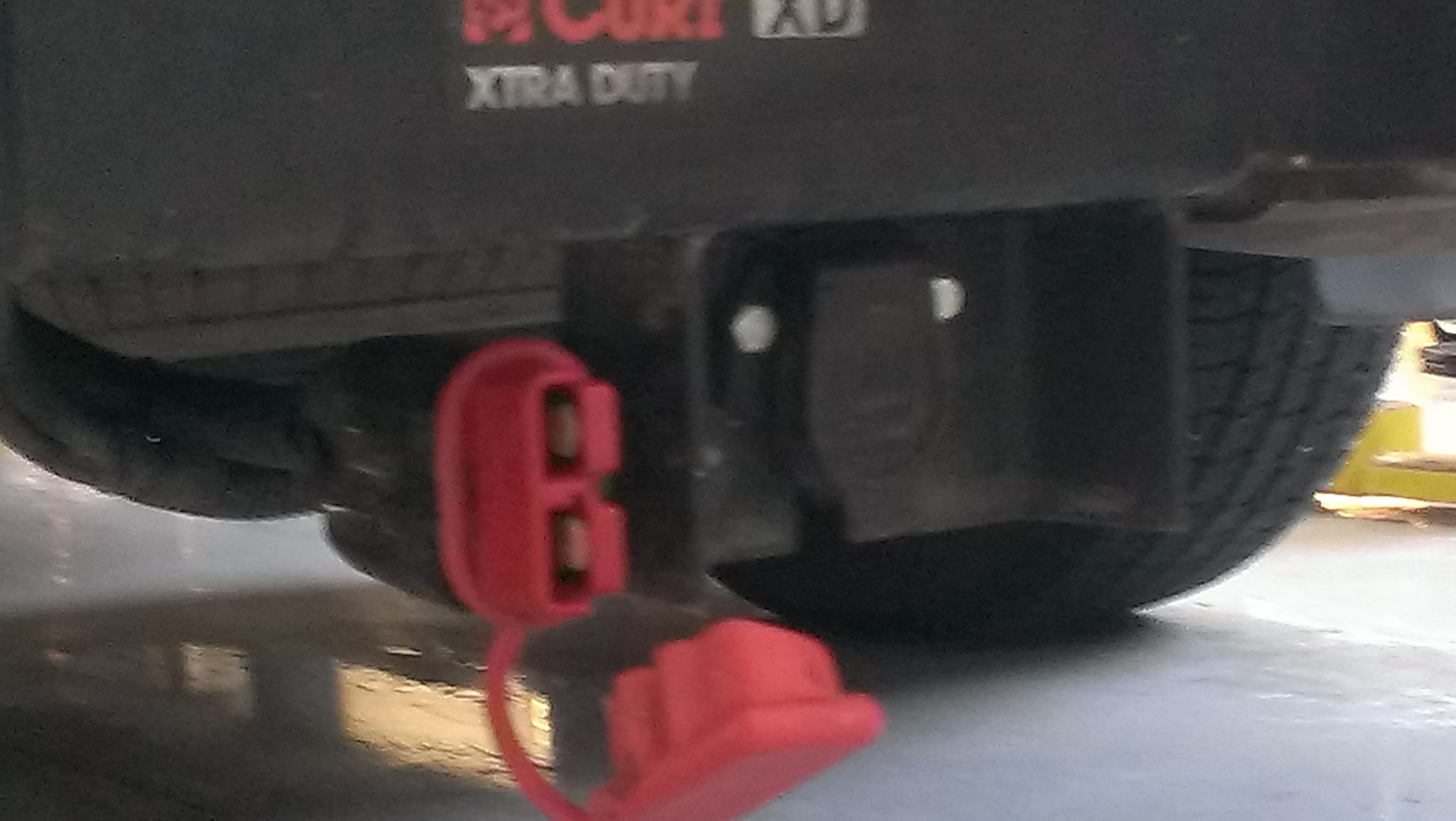

Last week when they were on sale I bought a 12000# winch. I plan on putting it on the back of my truck.
I am thinking about using 1/0 welding cable with twist lock connections at the winch. Running it from the battery to the back is about 25'. Does this sound ok electrically. Or am I going to burn something up.

You need to tell us the amp load specification for the motor. All wire heats up when current goes thru it. NEC tables show the maximum allowable amperage to prevent the heating from damaging the insulation. The fine wires of welding cable will help with current capacity. I think 1/0 will be cod, but look for a spec. It is pretty simple, if the cable gets real hot, like above 60 C then stop and let the cable cool off.

The cable is going to have a better duty cycle than the winch, 1/0 sounds like plenty. Sometimes it's better to mount another battery near the winch with an isolator and some #10 wire for charging, if you are going to be frequently using it for stuff.

I like that idea even better than stringing welding lead from under the truck. I am going to use welding lead plugs for the connections. I said twist lock but I meant lead connectors.

It draws 300 amps at full pull. The table I have only goes to 200 amps. At 30 feet it calls for # 2 wire.

I would use Anderson power connectors. They are used on electric fork lifts to connect the battery. They have polarity (+/-)but not gender(M/F). Might be important if there is any electronics in the forward/reverse parts.

I will second CNC Dan. Forklift connectors are the best suited for this application, as well as for boosting cables purposes. 1 gauge wire is just perfect for your application. Check your owners manual, to see if they talk about it.

Could someone double check me on the wiring. The first pic shows the long wire going to the motor and the breaker on the short wire. The parts breakdown calls the long red wire the battery wire and the 3 wires with the rubber jackets motor wire. The first one seems wrong even though it shows the breaker on it. If someone could look at theirs I would appreciate it.

Something like this? I have a much smaller winch and only use it to pull a car up on trailer. 4 awg wire and 125 amp breaker. Using a breaker is a must! I've seen a couple trucks burn to the ground because there lift gate motor stuck.
It is an Anderson connector you can get a boot for the backside and the rubber cap to protect from water.
