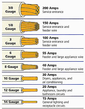

This is what messed me up in the guage size....
[/FO
Welding Cable #6 wire guage /30 amps 75
Welding Cable #4 " " /30 amps 100
Welding Cable #2 " " /30 amps 140
Welding Cable #1 " " /30 amps 160
But here comes 1/0 ?????
Welding Cable 1/0 wire size /30 amps 190
Welding Cable 2/0 " " /30 amps 223
(this is where I got that...http://wesbellwireandcable.com/Welding.html)
Don't know what the "ought" did but it reversed the size vs. amp capacity....more to confuse me:laughing:
One more question about the connectors....You said that you like to put solder into the connector and push the wires in......how do he do that?
IS the connector metal inside and the housing in the photos plastic? Can the metal part come out to solder....cause it would melt a plastic housing...
Lots of questions, I know...sorry....I am, really...:D

the metal legs pop out of the plastic housings. then you solder them . after they cool, you pop them back in and they lock under a tab.
1/0 is smaller then 2/0, which is smaller then 3/0 etc
   / Hi Amp wire connections #14
1/0 is 0 Awg
2/0 Is 00 Awg
3/0 is 000 Awg

All the #1,#2,#4,#6 and so forth are smaller than the 1/0,2/0,3/0.4/0 cables
all the ?/0 IMHO would be way to big for what you are doing we use these on
36,48,72 volt forklifts and are way to big for 12v!! Oh and if you are going to run cable any length along the chassis make sure it is either fused with a fuse or circuit breake at the "START" of the run so if you get a short in the line it will not burn along the frame!!
