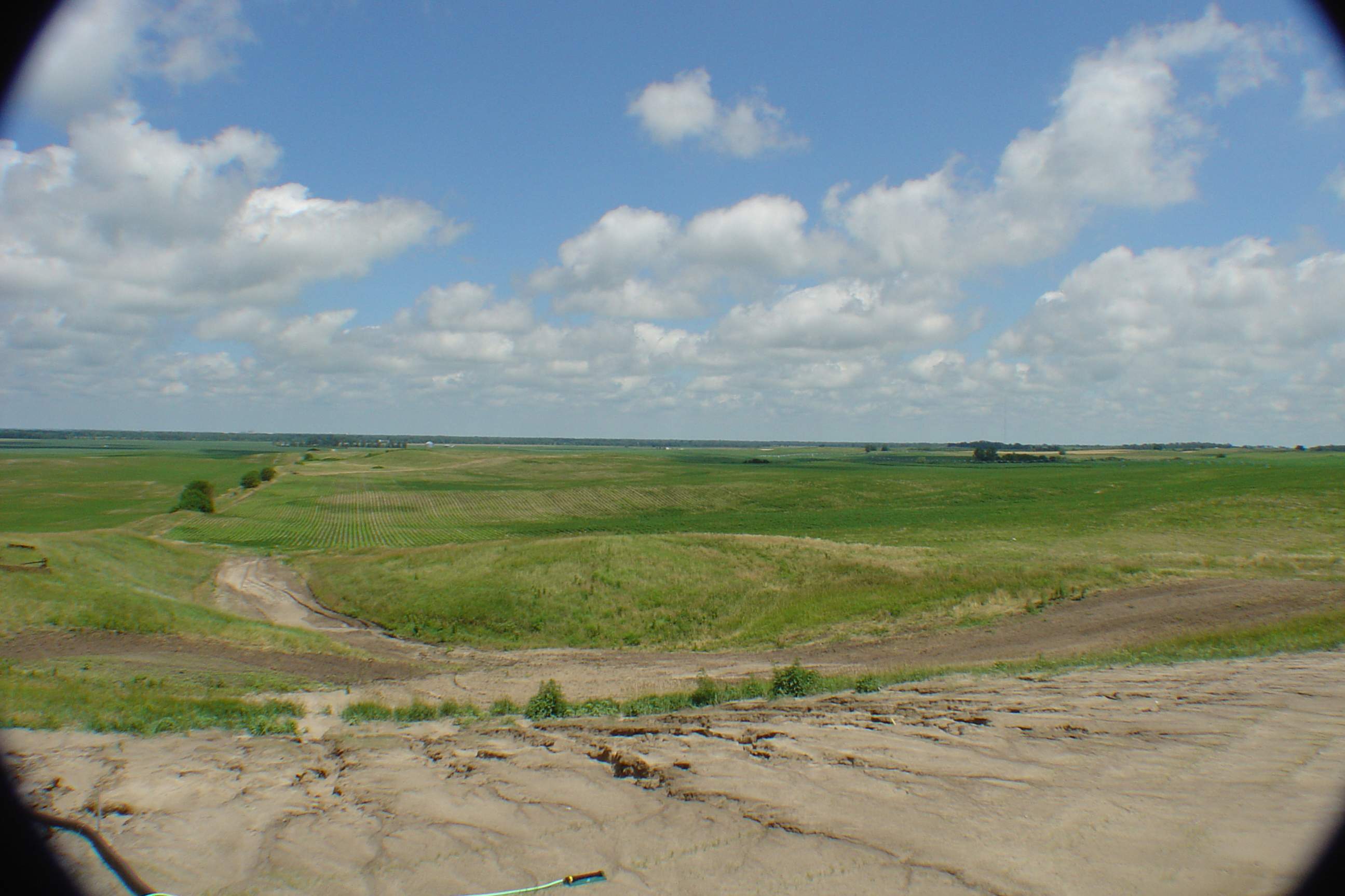

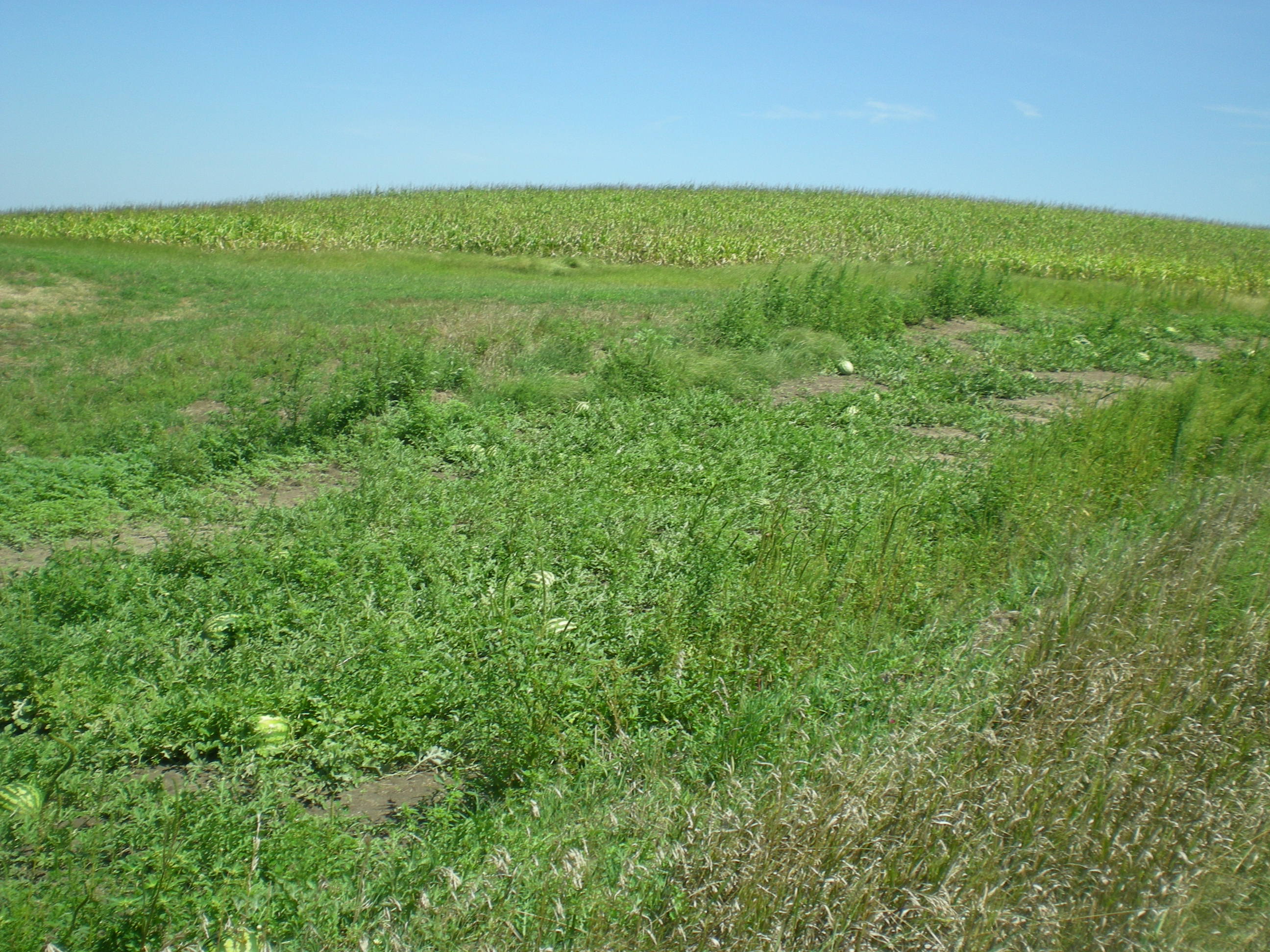

I did feel bad asking such an open question without even having tried any of these models. I just hate showing up at a dealership not knowing what I want. I haven't even really looked at other brands because when I look at their web pages they are not nearly as easy to get info off of as JD and 2 I don't personally know anyone to talk to that owns anything larger than a riding mower that isn't a John Deere.
As far as the gardening goes...the corner we bought came with the family water mellon patch. My Great Uncle says they have been growing on it for 90 years. So I just attatched a picture of it for fun. The first picture is just of some of the patch I took last year before construction started. The second picture I was messing with a lense I found. The upside down "T" shape is the area that was planted. We planted 42 watermellon plants this spring. Half of them got washed out from the run off of my backyard (which you can see the rutts in this same picture) but that is a topic for another site...My wife and I planted a pumkin just for fun also. I know we got 1 that already is too heavy to pick up. My Great Uncle (who is 87) handles the disking work now with an old Internation H.
So I didn't get into that too much in my first post. I would love to keep the garden going and even grow more of our food. But it doesn't come natural to me and after working 12 hour rotating shift with 300+ hours of OT a year it is easy to blow off. Mowing and snow removal are still going to be the primary useses. But since somebody asked, as a whole other deal...If I do take on this garden as it should be done, like I would like to, is the X748 enough machine in the long run?
