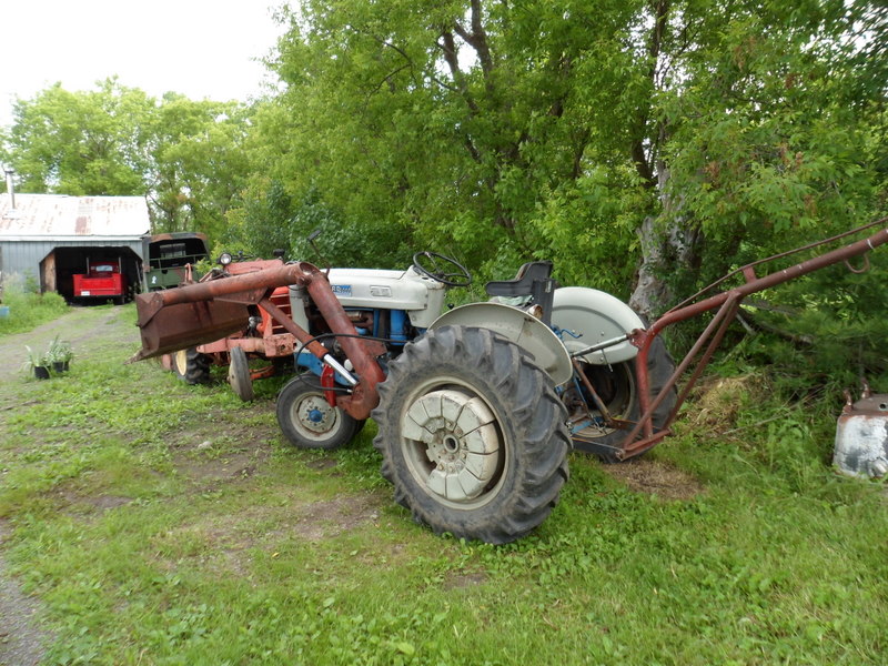

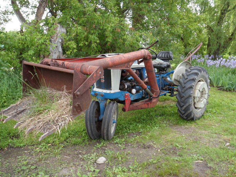

Soundguy, I took a couple of pics of the old 961. I'll attach them.
As I said; it's not too pretty!

Hey it works! Welcome! Thanks for the pictures.

DO NOT USE THE LOADER untill you get ALL 3 BRACKETS in place!!!!!!
the front hanger bracket, the trans hip bracket, and the lower strap bracket with attaches the bas of the laoder tot he onttom of the trans!!!!!

I also fabbed up a piece of plywood in the shape of what I think the bottom brace should look like. I made it 4 inches wide and drilled 3 holes...lines up good. I'll dig around my scrap pile and see if I can find some plate. Do you think 5/8 inch thick (4 inches wide) will do it?

3/8 plate and 1/4 plate..

Thanks for the plate info; all made up and installed now. I'm tempted to make a "one piece" bottom bracket.
Loader seems quite strong; but looks a little delicate; like I should try to be gentle with it.

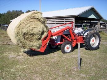

2500# breakout rated, and 1000# lift to full height for that model.
the full hyd later model is ratd a tad higher at 3000/1200# respectively.
farther you move away from the bucket pins the more the weight capacity decreases, same as in a 3pt.
I move round hay bales on my 1-arm loaders.
here's my 660 with 1-arm laoder and a very large tifton bale that rolled off the wagon and half way split open.
i estimate it to be near 1000#
soundguy
