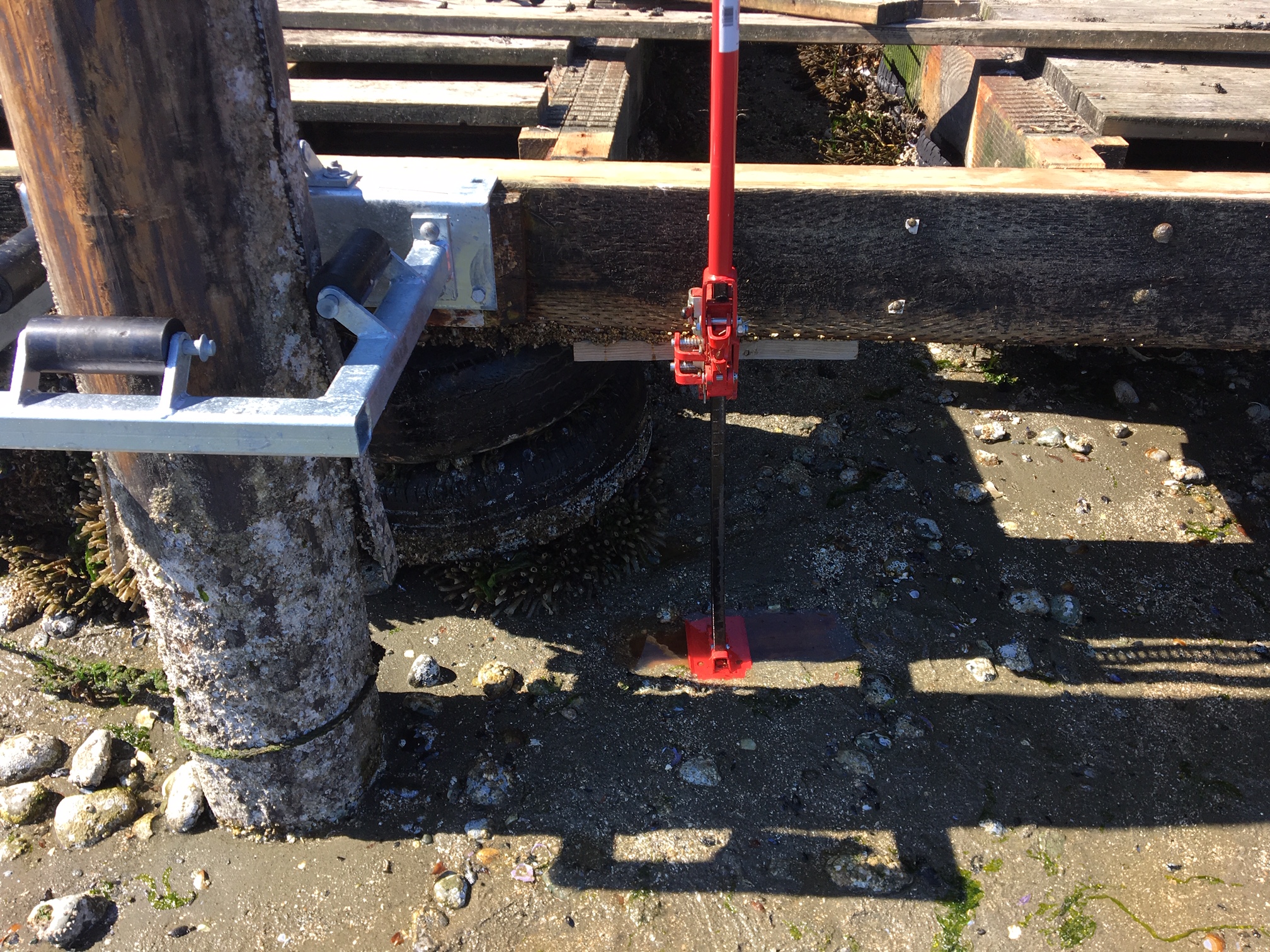

A little unusual use of a red bumper jack but I have been overhauling the floating portion of my dock. One of the floats (stack of tires filled with closed cell foam) had broken loose. On low tide today I used my red jack to lift one end of the dock so I could get the float back into position. You cannot see it but I have a 2x6 under the jack that compressed into the sand. I had to put my full weight onto the handle to get a ratchet up, but it did it. I have another red jack at a remote property that I was kicking myself to not have grabbed to double up the jacks. I have no idea what weight I had lifted but my I weigh in at around 200 lbs so whatever that computes to I was lifting.
Oh, and yes, I rinsed the saltwater off of the base so it does not start to rust. :thumbsup:

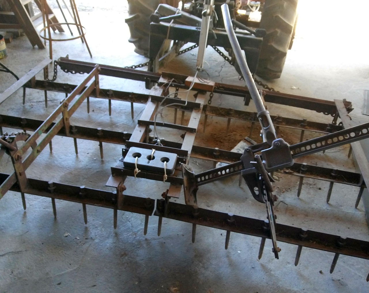

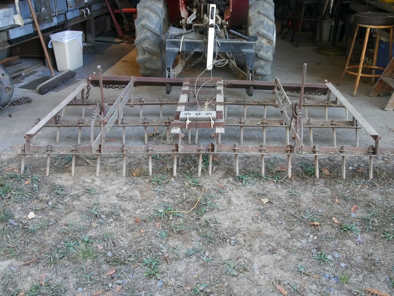

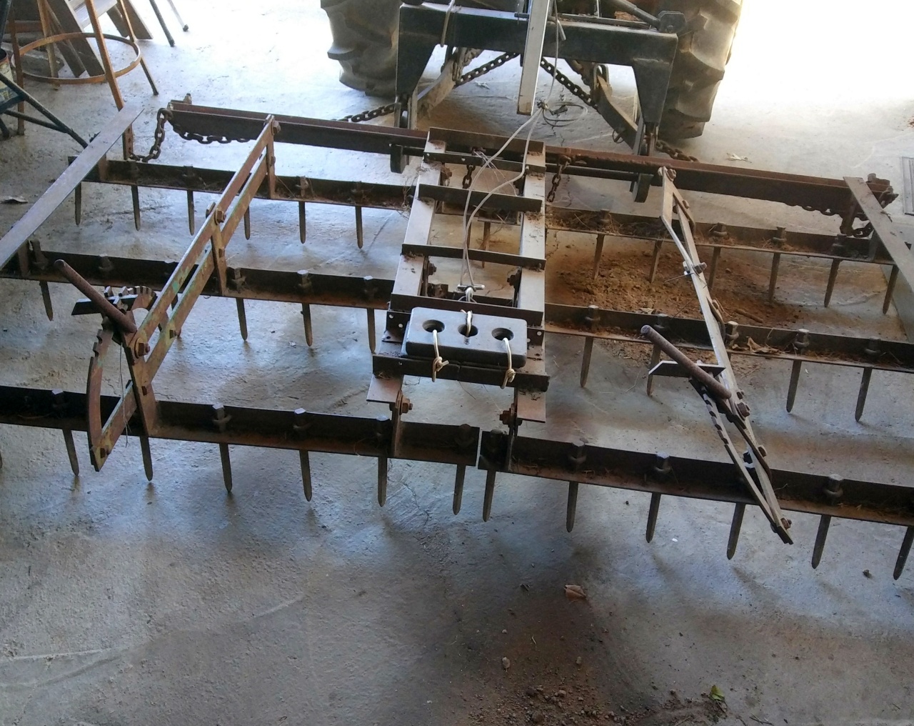

Rainy day so here's some pix of a HiLift ('farm jack') project.
Some darn fool :))) ran the corner of the loader into the spike harrow where it was hiding in tall weeds.
These photos show straightening it.
Yes these are dangerous. I'm cautious, I've had it fall when lowering something but I was a safe distance away. As I finished this project it got me, I reached underneath to switch the lever from Lift to Drop and that lever moved with such force it bruised my finger between the lever and the jack frame. I should have poked that lever with a long screwdriver.

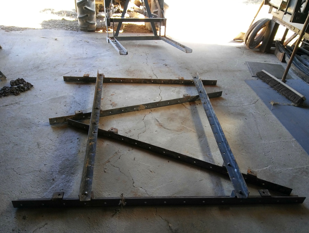

And a bonus pic, another project underway. Some snowplow edges were in in a friends surplus-auction win. He gave them to me, I bolted up the iron parts to make a simple land plane. It works great. I'll improve the design a little then weld it solid. I pull it from the drawbar under the differential, plus have loose chains that go over the ends of the loader forks to lift it for turns. Anybody need the rubber edges that were bolted to these pieces? (They're visible under the workbench).
