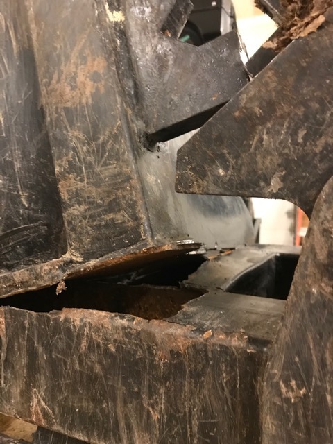

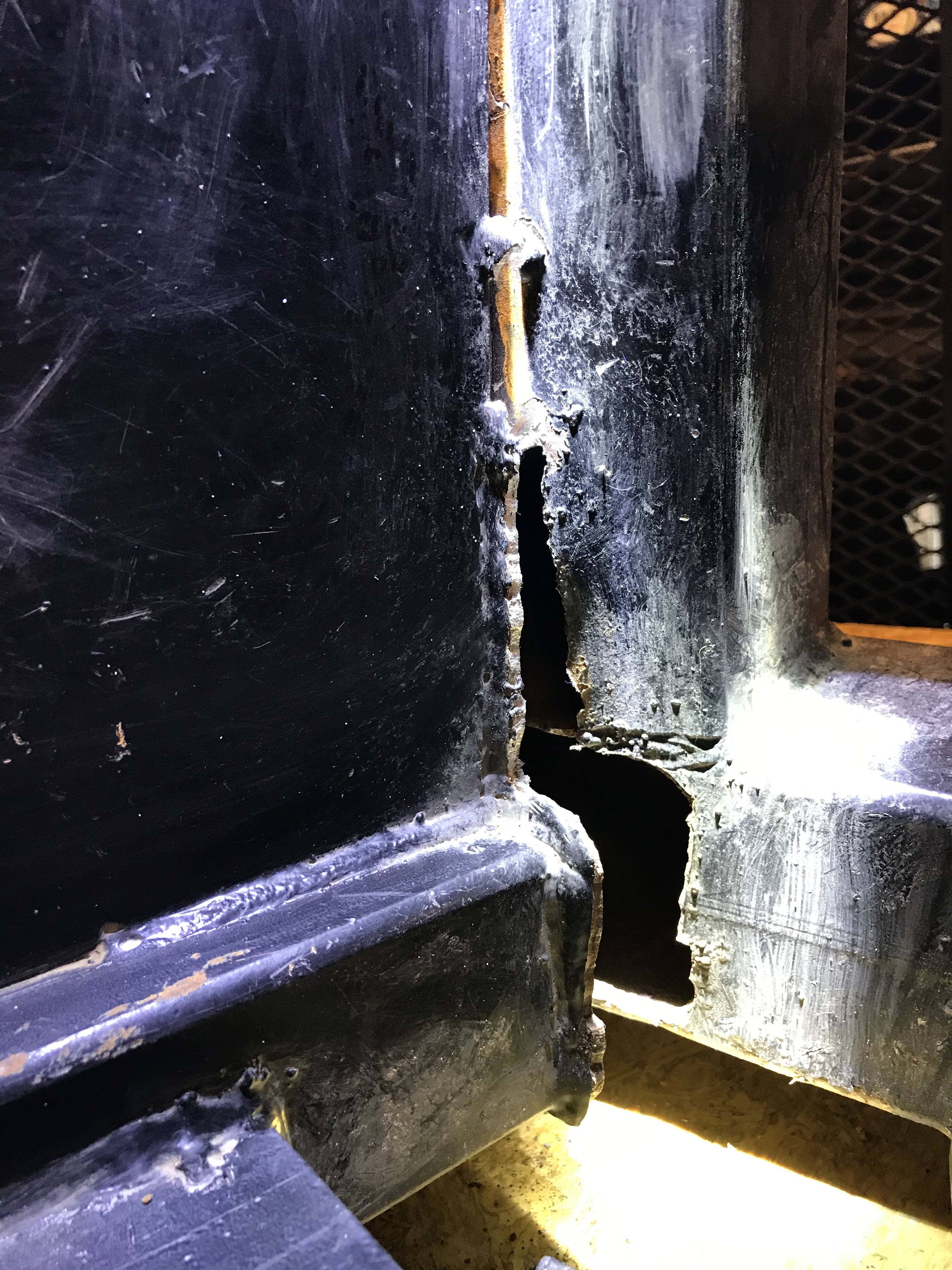

In August of '18, I purchased a "Heavy Duty Tree Puller" from Titan Manufacturing and Distribution for use on a John Deere CT322. As with most attachments, it sits more than it is used. Prior to the catastrophic failure shown in the pictures, it was in use approximately 40 hours. I had installed zerk fittings on rotating parts as added insurance against wear and tear, to no avail. I had owned the attachment for 16 months, four months out of warranty. Emailing Titan, I was told "he has seen this kind of issue before", "your JD CT322 is not overpowering it". After looking up the appropriate part number, I spoke with "Barbara" at Titan regarding a replacement part. She needed to speak to her higher team leader and would call me back. The following day, after not hearing back, I contacted a rep who had her call me. It was quickly noted that they had used a wrong part number. Then it was "we do not stock that part", finally, it became "you are not able to buy the part from us or anywhere else".
It is now better than two weeks and seven emails, later. I have spoken with Barbara, emailed with Hezron, Paul, Cameron, and anyone else that would respond. Curiously I am unable to post a verified purchase review on their website.This morning,I was told "the system is down for maintenance", "don't know when it will be back up", "check back later next week".View attachment 643009View attachment 643014
Look closely at the base metal: I measured thickness at 1/8" or less. As a former welding instructor, the failure of the base metal at the edge of the weld metal in this case is not at all surprising. You be the judge. I question the use of "Heavy Duty" used in their advertising. As it is, I am now the proud owner of a 300 lb. powder coated boat anchor.

That's crappy maybe you can make a new base for it:confused3:

You know, when I purchase things like this knowing full well it is a knock off, it shouldn't surprise me when it fails. In this case, being the only one who used it, I am surprised at how little it took to have it fail. Perhaps they could re-think their "rating" and classify it as "Lawn and Garden". Live and Learn.

I would get a new 1/2 plate and 3x3x 3/8 tube and do it over .

Will be picking up the material tomorrow. Unfortunately 4 sq. ft. of 1/2", 1 sq. ft. of 3/4" plate, and 114" of 4" sq. tube steel .250 wall thickness, is just North of $300.00 here in St Louis. Throw in 10 lb. of 6010 and the same or more of 7018, couple hours on the plasma torch, some flap disks and a coat of paint and I'll be back in business. No idea how I ever had time to work for a living.
