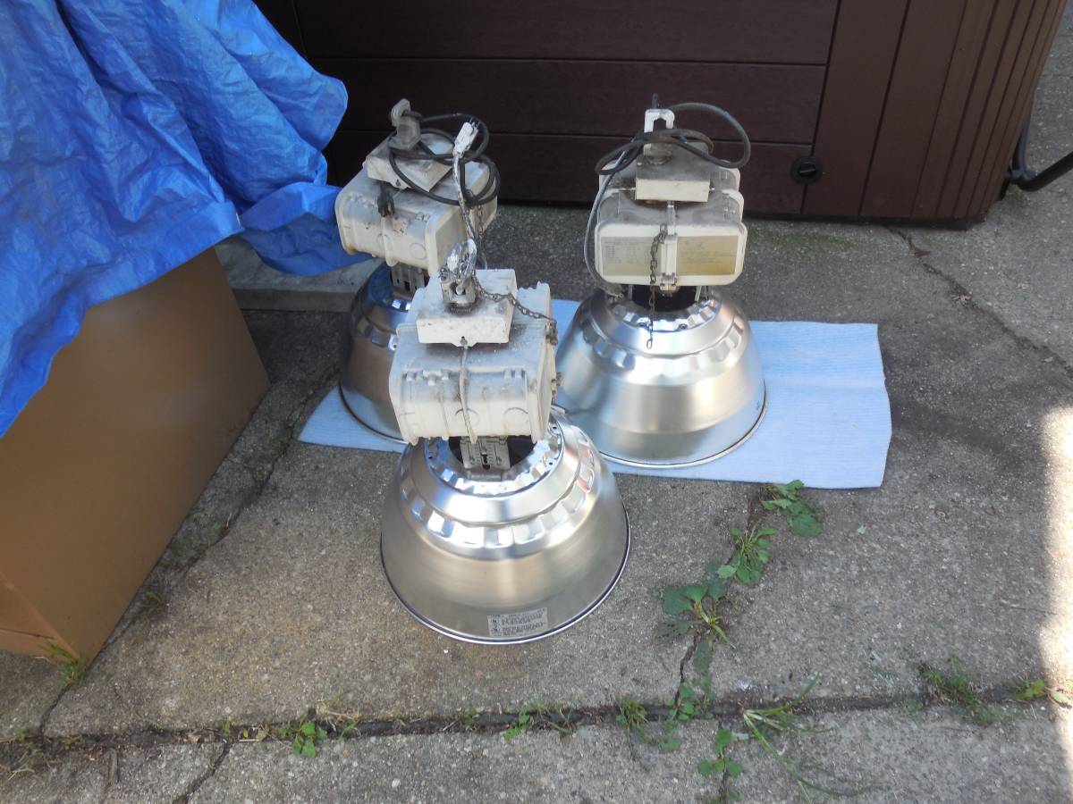

I've been "down this road" a few times. For an arena, dust and birds are the nemesis. Also cold weather. Then you have to go climb a ladder to change out the fragile flickering tubes. AND, your riders will not be pleased because it's too dark to show riding faults. The new LED lights are not diffused enough. Look at one and you go blind.
For an auto shop, you want BRIGHTNESS with minimal glare. AND, no point light sources. So, I replaced my 8 8' flourescents in the shop with 3 of these. Bright as day, no glare, use when needed, birds don't seen to like them. They are 20' up. Look around on Craigslist or Habitat stores for industrial donations and overstock. Mine were $35 apiece. 120v single phase. 20 second warm up. I gave up on the arena. It's a great equipment storage building now. high bay lights.jpg
These are for sale on CL right now for $35. Brand new.

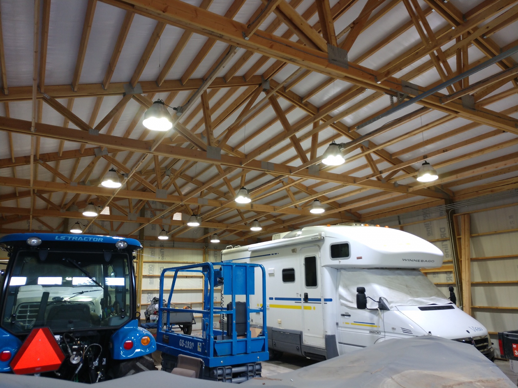

I installed these LED highbays in my 40x60x14 shop-5 rows of 3. Great lighting.
I have two of these,, in a bay of my shop that is about 30x40 feet,, the area is lit up like daytime.
Mine are 16 feet high, I did change the reflectors from "high bay" to "low bay reflectors" , that helped even the light out.
The main thing I like about the lights is that only two lights needed to be installed, less wiring, way less installation.
AND, the actual power consumption is WAY less than 2X of what the equivalent LEDs consume.
I could never recover the cost of changing over to LED lighting, based on electricity consumption.
(I only use the lights a few hours per day)
mine have been up over 15 years,, both are still perfect.
They say after so many hours, the light output reduces, I can not notice a difference after 15 years,,
Just for grins, I added an LED light,, actual 100 watt power consumption, it is a BIG light.
The LED did nothing to aid the two metal halide fixtures,, the light from the metal halide fixtures is overwhelming,,
I mounted one of the metal halide fixtures over my welding table, at 8 feet high,,
the light is so bright, that if you turn your head, the light will "trigger" my auto-darken welding helmet,,
I have to turn the light off when welding so the auto-darken helmet will function correctly.
