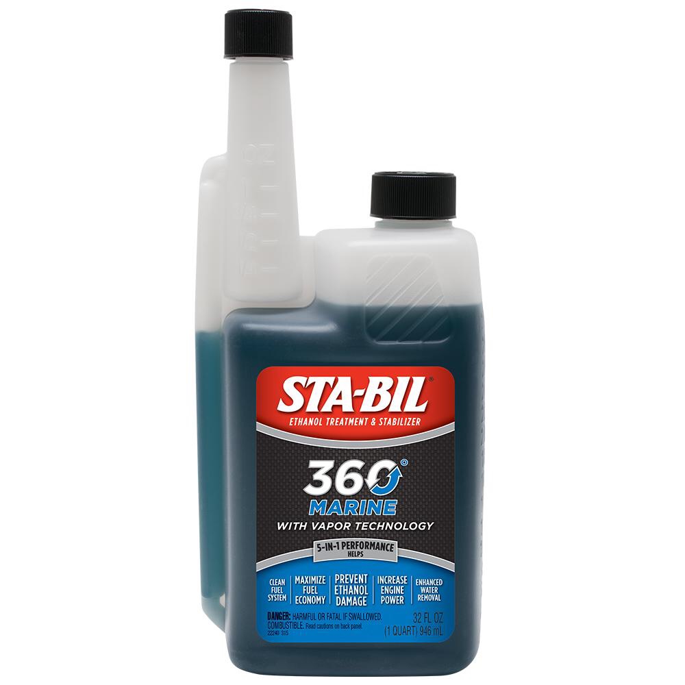

I never have gas more than a few weeks old. I started treating all gasoline with Stabil Marine 360 a little over 3 years ago. Problems with carbs, fuel lines, etc. on 2-stroke equipment are completely gone. Everything starts easy, usually one pull. The Swisher walk behind line trimmer, that was a hard start from new, now starts easily even after a few months of non use.
