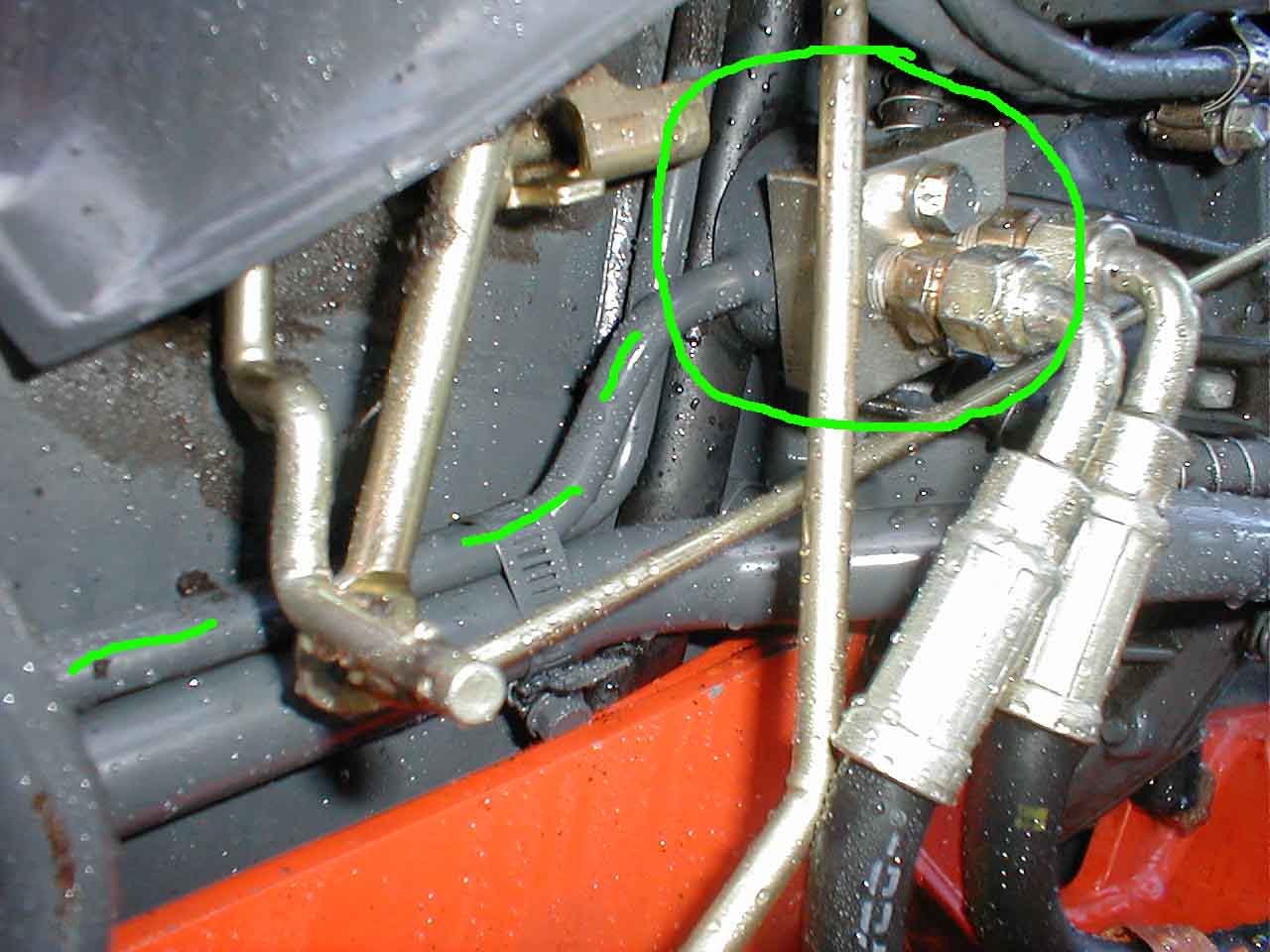

Thanks for all the help guys, it has been a help. Here are a few photos to help clarify and for those interested to see what a mess I got myself into. Actually, I am really getting to know my tractor.
This first photo shows the foot plate removed and the green dashes and arrow indicate the steel hydraulic line that ruptured.

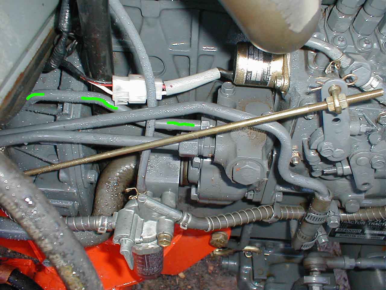

   / High pressure hydraulic line
Here is a photo taken from the top looking down over the right rear axle. There is the "banjo" fitting that is welded to the high pressure line leading to the front of the tractor. You can't see the rupture, it is actually on the bottom side of the line. I can only guess that it was caused by a poor weld or weakened area in the line at the weld. There is no evidence of abuse, or something striking the line. Just one in a million chance that it ruptured. (don't I feel lucky!)

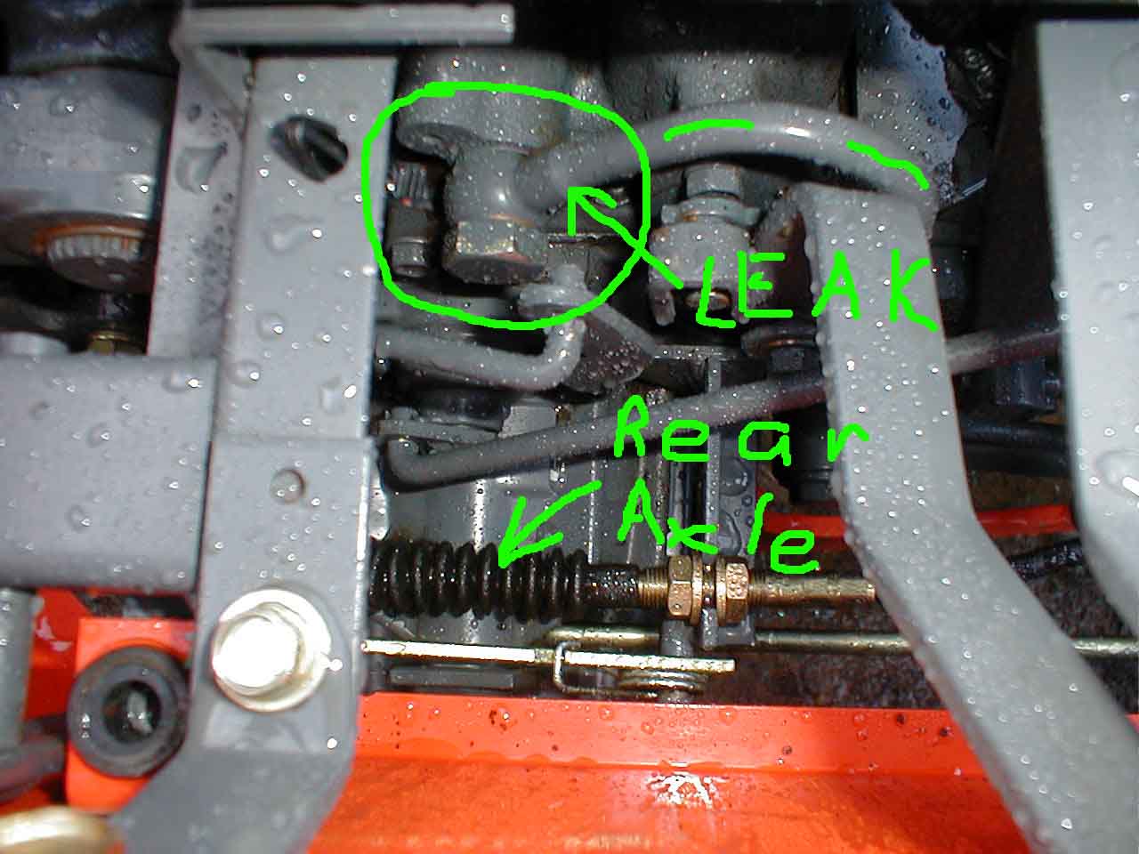

#9
Here the line comes into a double banjo fitting which the hydraulic block for the FEL lines are attached. The bad hydraulic line continues on from here and attaches to the hydraulic pump, shown in the next photo.

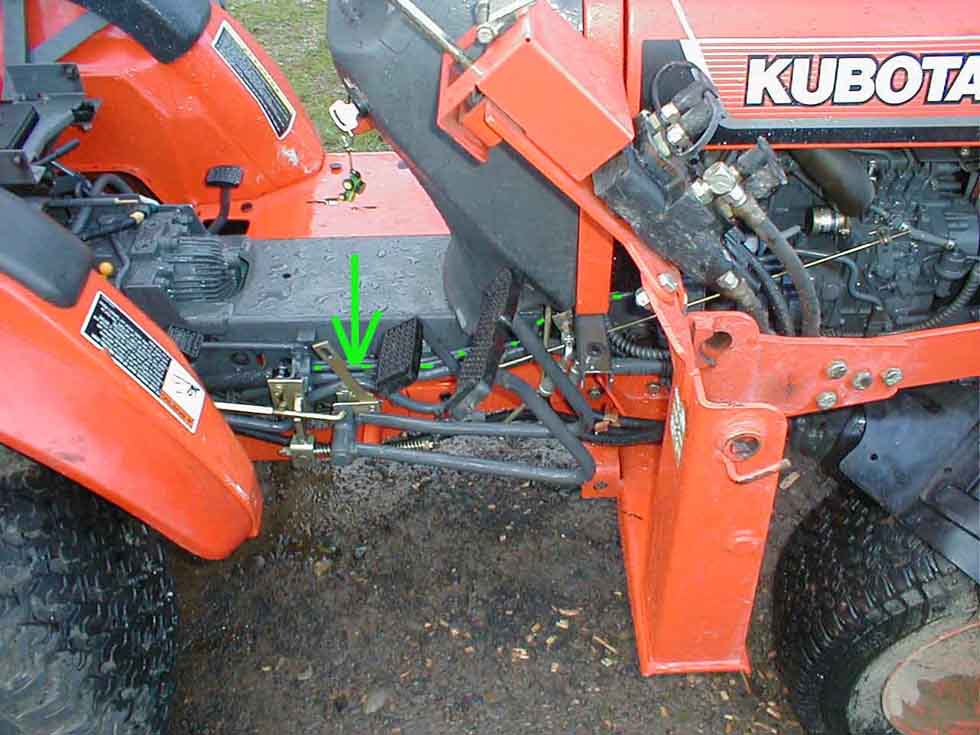

So here, we finally end up at the hydraulic pump. This is one single line, one piece with two banjo fittings welded in. If the kubota dealer got it right from my description, it is a $95 part and will take me 4 - 5 days to get. I have left the line on until I get the new one since the tractor is stuck outside and rain is in the forcast. I have to remove all the linkages for the HST forward and reverse pedal, the brakes, hoses for the FEL and return hose for the transmission. Well, wish me luck, and if anyone has any suggestions after seeing the photos, feel free to throw in your two cents, I more than open to any advise. The line gets here Thursday I hope.
