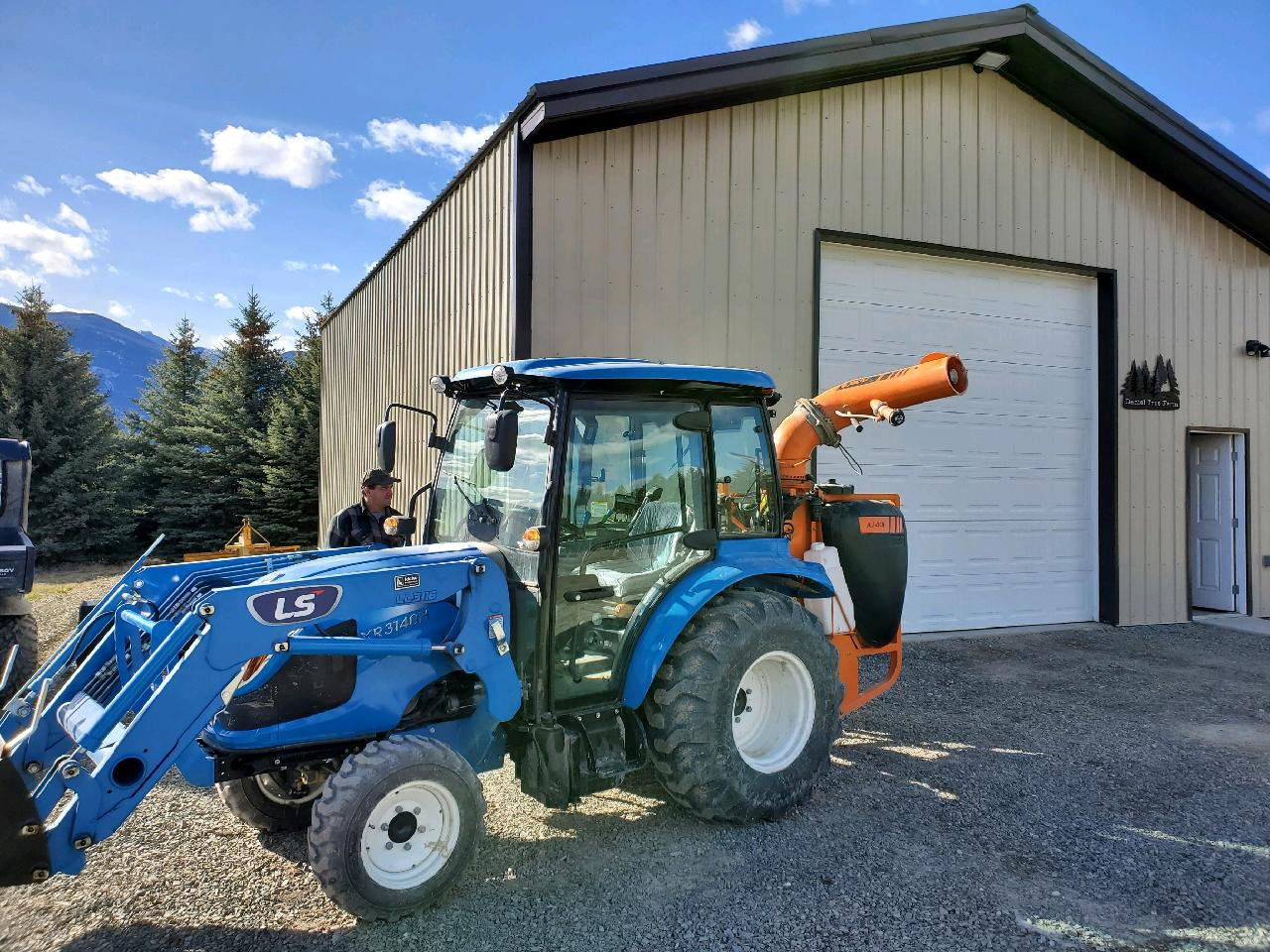

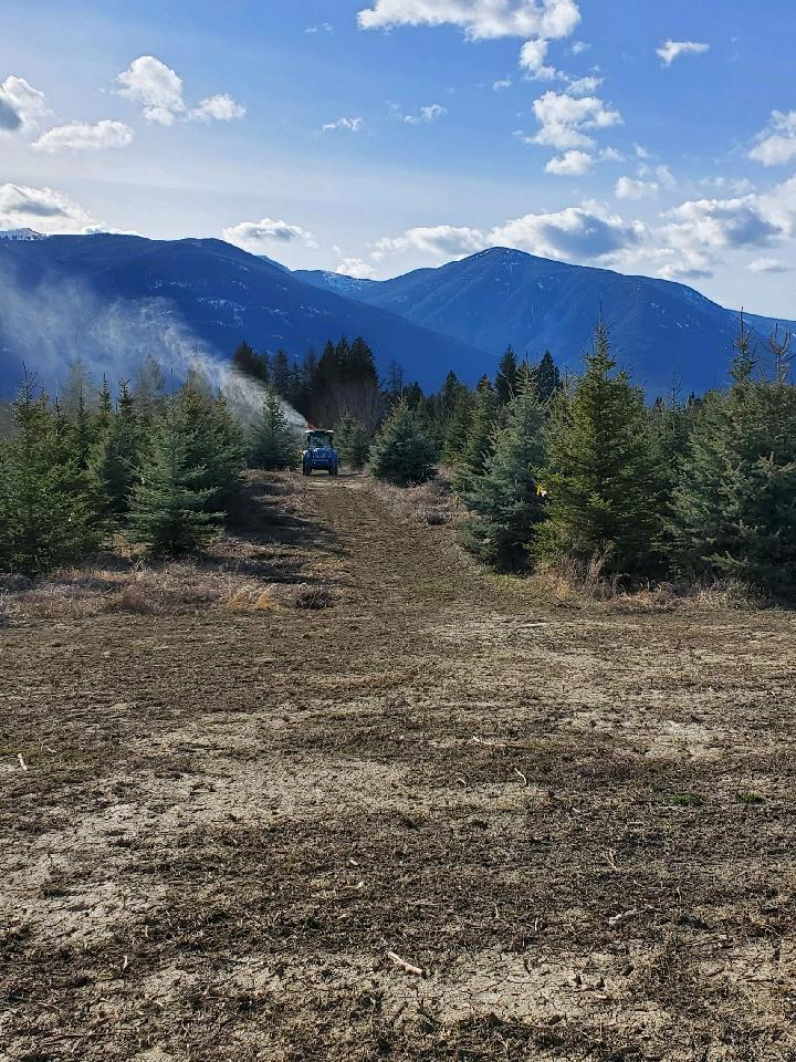

Jacto AJ401 Blast sprayer.
Like mine.
Check out my post in LS owning/operating 'three hours cannon spraying'
