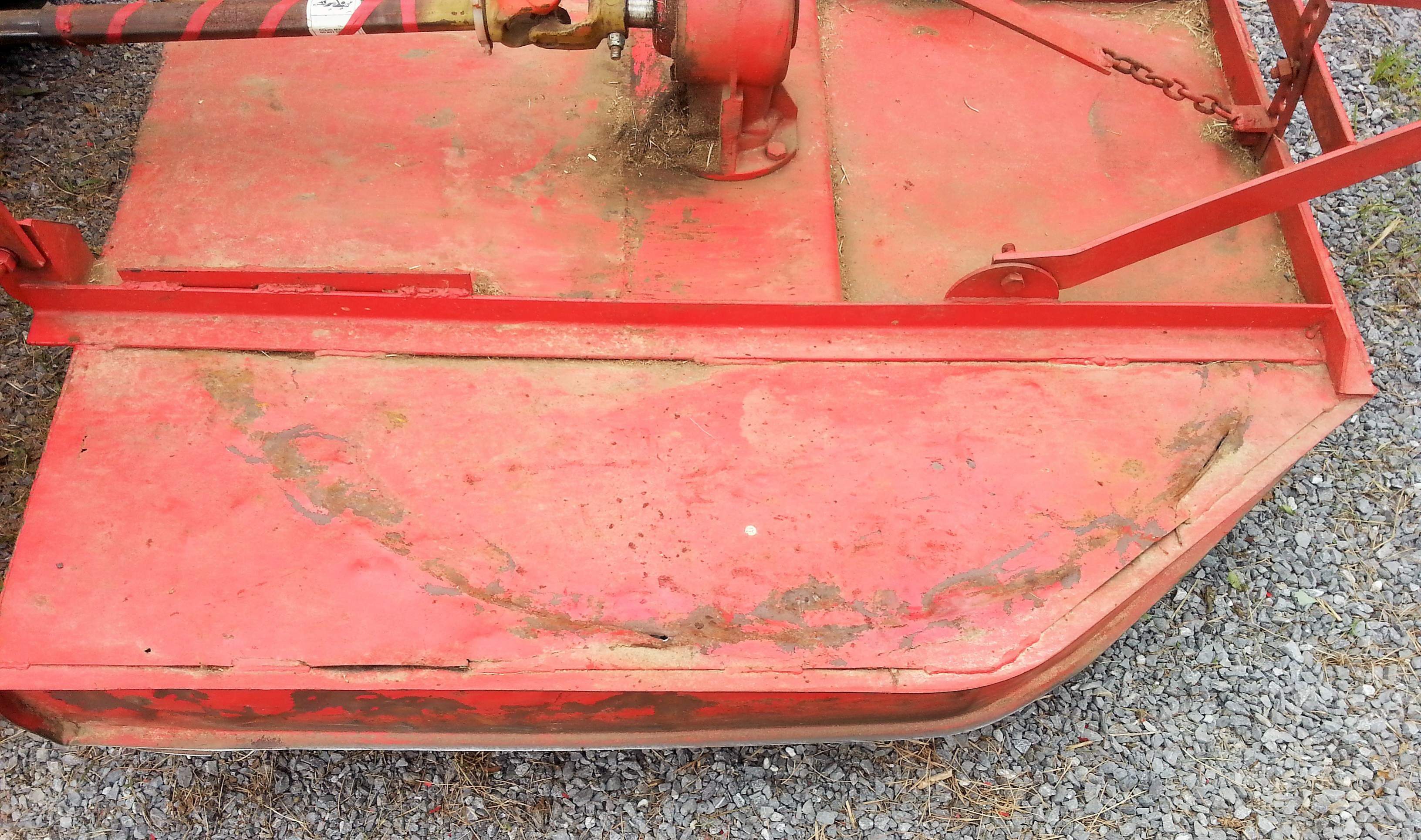

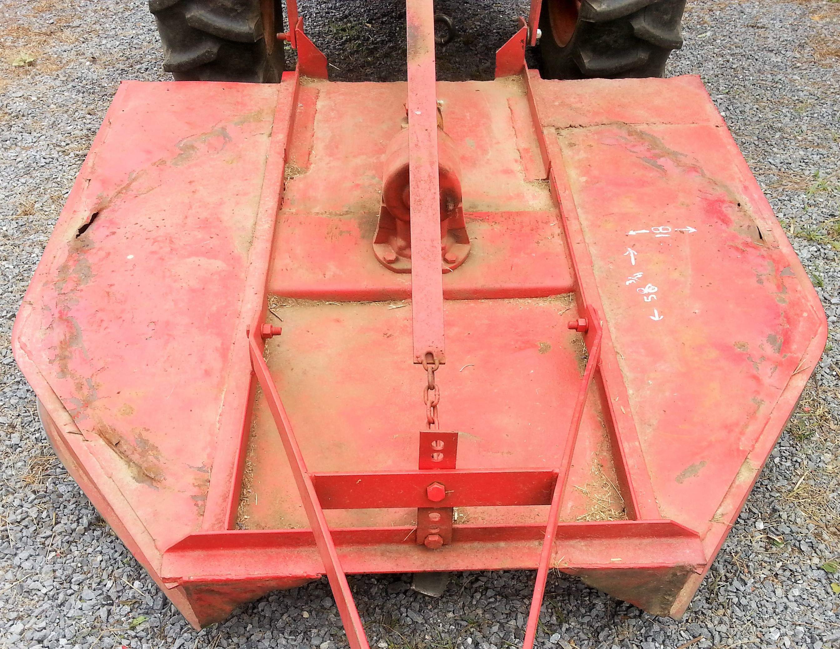

Fellas, my older bush hog needs a new deck. I have bought two steel plates 1/4" thick, much heavier than the original, and intended to weld it on as the orig is.....
But....I had a epiphany last night (scary) and remembered how difficult it is to lift the hog, put jack stands under it, lay on my back and grind the blades over my face.....
What if.....these new heavy deck plates had long piano type hinges down the center like a T-Model Ford so that they could be propped up or chained up so I could sharpen these blades from above....hmmmm
Tell me where this is a dumb idea....(I've had them before...) Thanks:confused3:

I would wonder if the plates not being welded would affect the structure and rigidity (sp?) of the unit. My bushhog is in similar shape. Age has cought up to her, and while the gearbox is good, the body needs some repairs.

I would think you would have a hard time keeping them latched down on the opening side ,with all material a rotary cutter slashes between the blades and deck. I sure would NOT want a large piece hurled at me , if the deck came open under pressure .

Looks like you had the blades find their way to the deck a time or two. I would not be as worried about structural integrity as much as what amaxwell stated about keeping them closed.l Maybe use bolts around the perimeter instead of a hinge, kind of like an inspection plate.

It's certainly worth thinking about, but i am a little lazy, so i think i would cut about a 16" hole in the deck for sharpening and bolt your 1/4 steel plate to the deck, covering the hole.

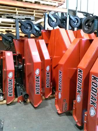

At several of the dealers around here, cutters are stored standing vertically on their front end. I see groups of them being shipped that way, too.

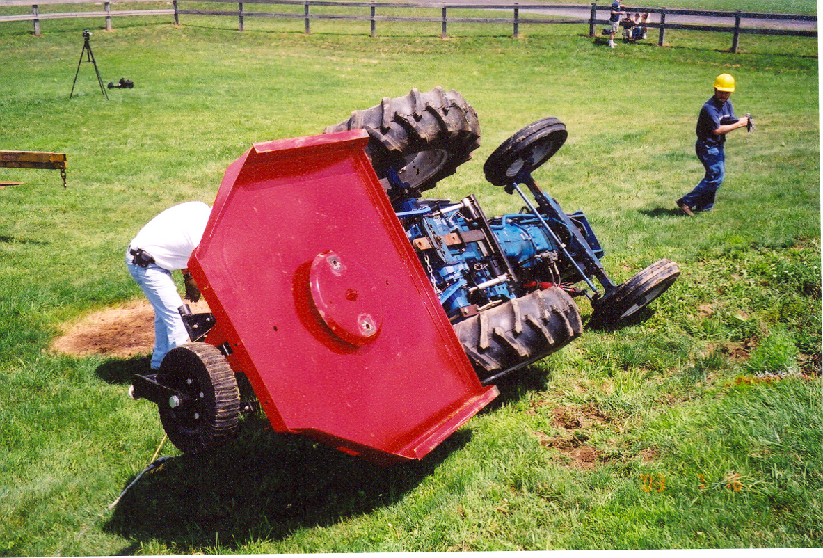

Why not use your FEL or boom to stand the cutter on edge or end for blade access? If you can't keep the vent high, unscrew it and put in a plug. Just be sure it is secured so it can't fall on you when you work on it.
