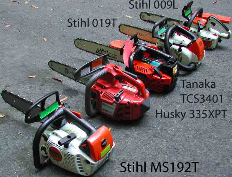

I have a pro tophandle Tanaka, a TCS3401, made in Chiba, Japan. It has 2 piston rings, and
nice ergonomics for tree-climbing. Compares favorably to the pro Husky 335XPT (photo).
I got my saw to repair, and it still does not run quite right. I suspect an air leak in the rather
compicated air intake manifold, some parts of which I replaced.

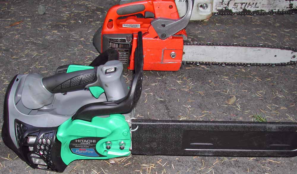

It makes sense that some Tanaka-branded stuff is made in China, since they look identical to some
Hitachi products. Here is a current model Hitachi CS33ET 32cc tophandle saw, which is clearly marked,
"Made in China". I don't have any experience with using or fixing one.

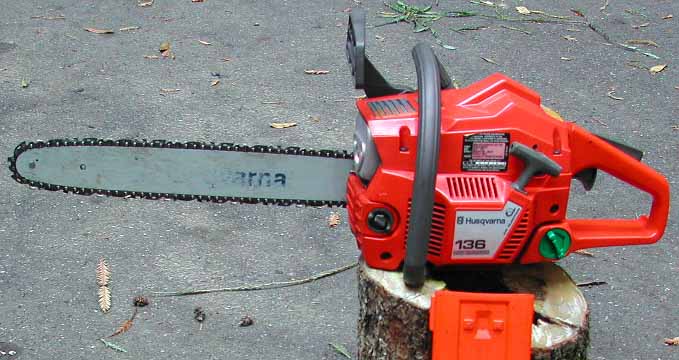

Of course Husky makes cheap homeowner saws, labeled "Husqvarna". Like this 136 model (photo), which I owned and
fixed. I bought a Rancher 455 new, and it still works great. Also a homeowner saw with one piston ring. Husky makes
it relatively easy by putting an "XP" in the model name if it is pro-grade. My point is that they should not cheapen
the Husky brand with ANY homeowner saws. The 136 I had seemed little, if any, better than a Poulan. And the Stihl
MS170 I had and fixed (a cheapo homeowner saw) was even less well-made, IMO.
I have no problem with most homeowner saws, and you can get many years of service out of them if you take care of
them. Many homeowners (and pros) do not.

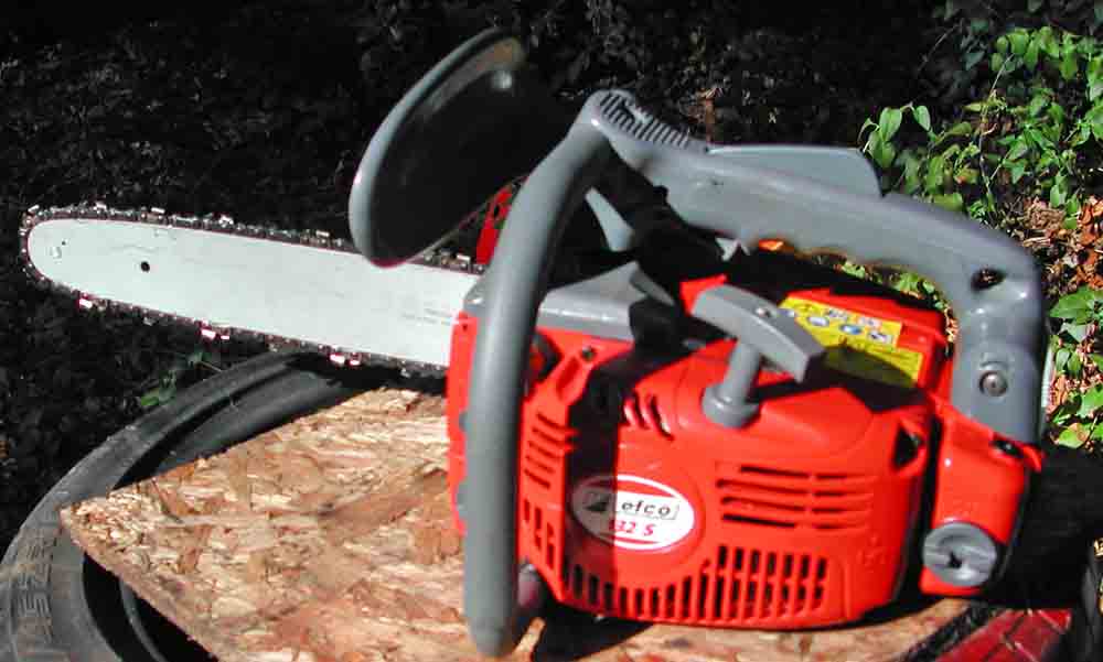

I tried a couple of demo cuts, but have not put it into service. I thought I was going
to replace my Tanaka or Stihl tophandle saws, but now it looks like I will sell the Efco. PM
me if you want it for 1/2 of new price. I love the thumb support on the newest tophandles;
it makes one-handed use even easier.
