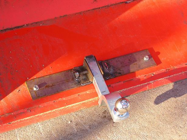

I made that for Tim. In fact that is the first one I built and the plans I offer were based on that build.

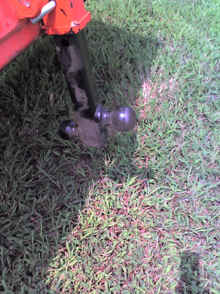

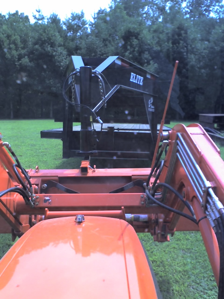

MOST definately! If you mount them on TOP of the FEL bucket...you need "about" a 8 inch drop to get to "normal" height trailer couplers.. Wne mounted on the bottom of the bucket..you already KNOW that you are as low as you can go...and you just position yourself and raise the bucket right into the trailer coupler!
I bouth the Easy Hitch.??...for the rear for mine but intend on having a front gizmo made up like yours for when i MIGHT need it.

I designed the "easy hitch" about 5 years ago and sold them on eBay. I've since found much better options. I also tried a clamp on mount at the bottom of the bucket. The real issue there is that you cannot see your hitch from the operators seat. Besides, it still had to be mounted and dismounted and, it didn't function well with the +1000 pound tongue weight of a large gooseneck trailer.
Rather than re-invent the wheel, I saw in Sikeston, MO that nearly every trailer manufacturer there (and I'd bet there are a dozen or more manufacturers there) had the simple receiver welded onto the top of the bucket on their tractors to move around their hundreds of trailers each day. As I said before, that design was NOT my idea; I simply borrowed that idea from people who move trailers all day long every day. And, I found that, for me, it was by far the best option. Embarrassingly enough, I found the worst idea was my design of the 3 pt. hitch mounted rig even though it only costs about $22 to make. I suppose it would be okay if you never used the 3 pt. hitch for anything else. I'll gladly admit that my ideas were far more complicated, cost more to build, and were not nearly as effective as the least expensive and easiest solution. The only issue I see is if you don't have an FEL...:eek:

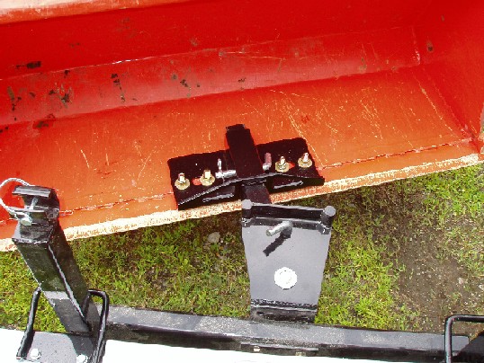

EBAY has a couple of clamp on hitches that seem will made. Concerned about the clamp slipping or becoming loose while using. is there anything else that can be done to secure the clamp short of welding? Thanks
/ Hitch on bucket #33
Unfortunately that is a fact of life with the clamp-ons. The entire unit will attempt to slide forward no matter how hard the clamp is tightened. I tried to really minimize this by incorporating certain features into my design to prevent the unit from slipping forward. It is all detailed in my plans. PM me if you want a copy.

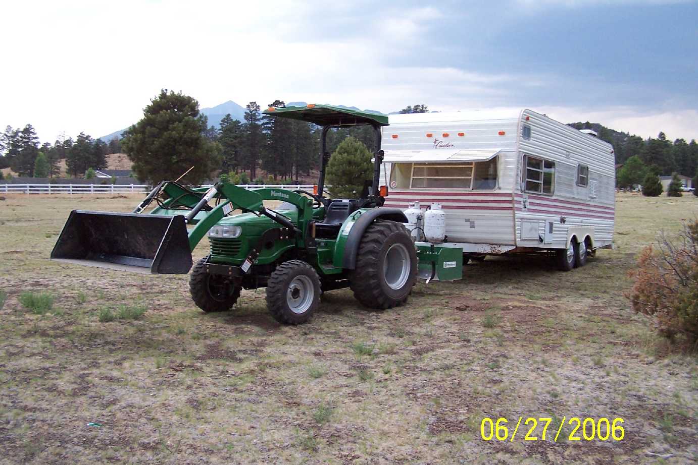

Here's mine, seemed like a good idea at the time. But after adding the toothbar I definitely need a serious drop hitch, although I may end up using it for a light duty boom pole.

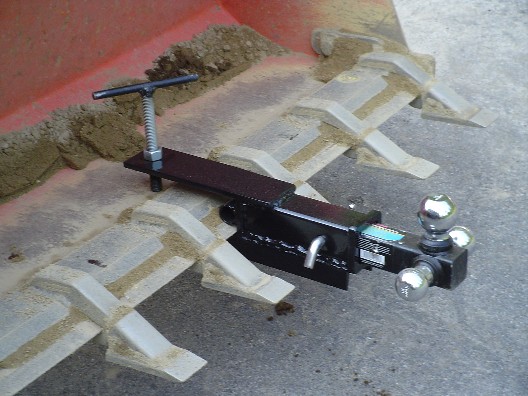

Here is a pic of the one I made for my tractor. I didn't go with the receiver hitch design because I didn't think I needed anything but the ball on it and didn't want it to stick way out. I use it for moving empty trailers around and it works just fine.

Looks great. I assume with the piece of metal on the bottom and behind the cutting edge, that it prevents it from sliding off.
I saved a couple of the pics. I may just copy the idea. (if its ok with you).

If you got a copy of my plans for the bucket forks and bucket hitch you will see that my design utilized the same technique in order to prevent the unit from sliding forward. It does work.

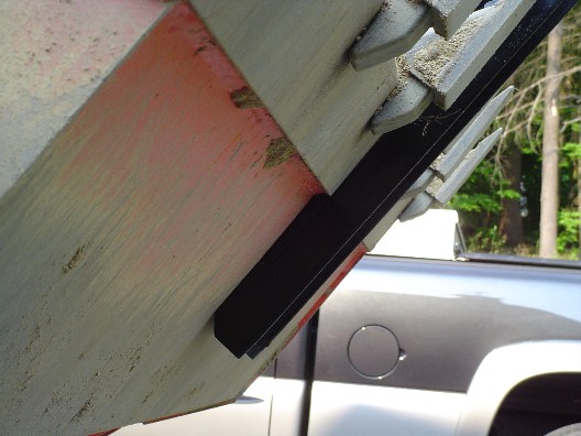

/ Hitch on bucket #38
Yes, the metal on the bottom keeps it from sliding forward since there is the lip on the bottom of the bucket.
Feel free to copy away on the design. Let me know if you need a side pic of it when not installed on the bucket.
James
/ Hitch on bucket #39
since I'm lacking the welding equip. is it possible to purchase one (ebay) and have a shop weld flat iron to the bottom to prevent slipping. I just checked my bucket and it has a small lip. (Fabrej) would appreciate the side picture you offered. Thank you all for the pictures and plans. Tony
/ Hitch on bucket #40
I just snapped this picture. I hope it shows what you need.
James
