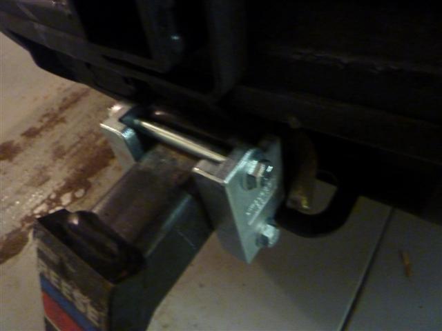

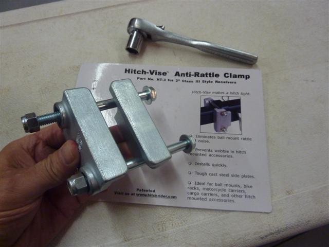

I received the Hitch Vise in the mail today. Here is a little review on the install and some pics. Installation takes just seconds when you install the ball mount into the receiver.....just about two turns on a 9/16" wrench will tighten the "vise" to secure (clamp) the ball mount from rattling in the receiver. Immediately removed all play and all noise.
I have not towed with this yet....but it seems very heavy-duty (cast steel) and should last forever. I like the looks of this set up.....Very good product IMO.

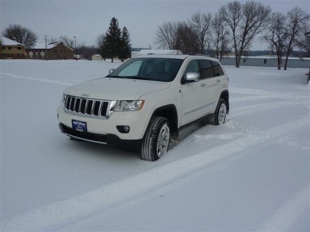

I went with the Hemi. This is the first Jeep I have owned since an old used Wagoneer back in the 70's.
I bought an Overland model with the air suspension and the whole ball of yarn. Pretty nice vehicle. I think the biggest reason I went to Jeep was for the tow capacity at 7200 lbs....as I want to be able to tow a good sized boat and my tractor and implements.

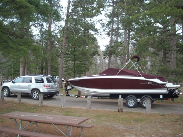

Not many pics yet....heres one of the new Jeep and one with my Acadia towing my boat. "Slightly" overloaded. ;)

The Acadia did "ok" with the boat...but I didn't pull it very far. My tractor and equipment was stretching the limits. :D
The V6 engine had "enough" power, but I did have two tranny problems. Tranny was rebuilt once, then replaced the tranny at 70k. I think I drove it sensibly....but still had problems. I didn't feel good about these kinda loads....and I wanted to do more travel with my boat and with my tractor to help my kids on their land.
