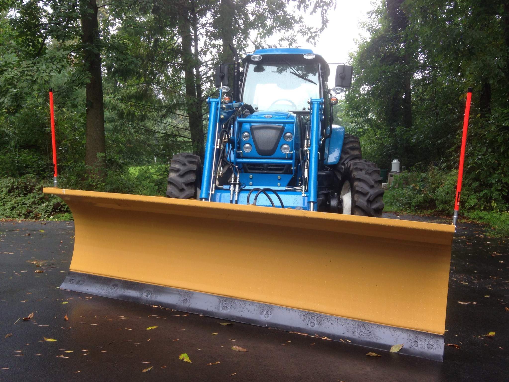

Thanks! Just waitin' on the snow. Here it is on the tractor:

A good rule of thumb is 18" wider than your tractor for width of blade to still cover your tracks when angled. Weight of plow should be determined by size of tractor.
