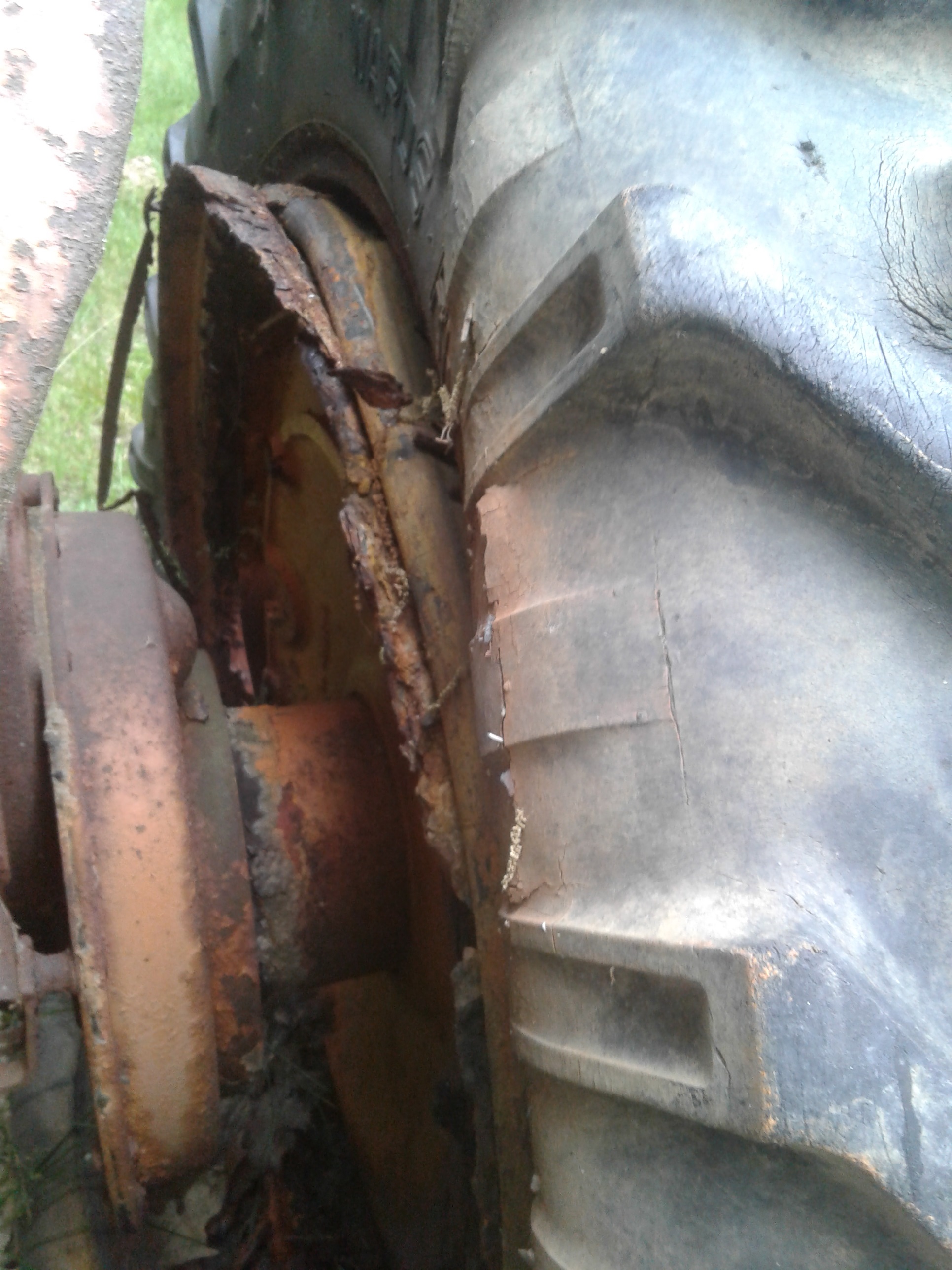

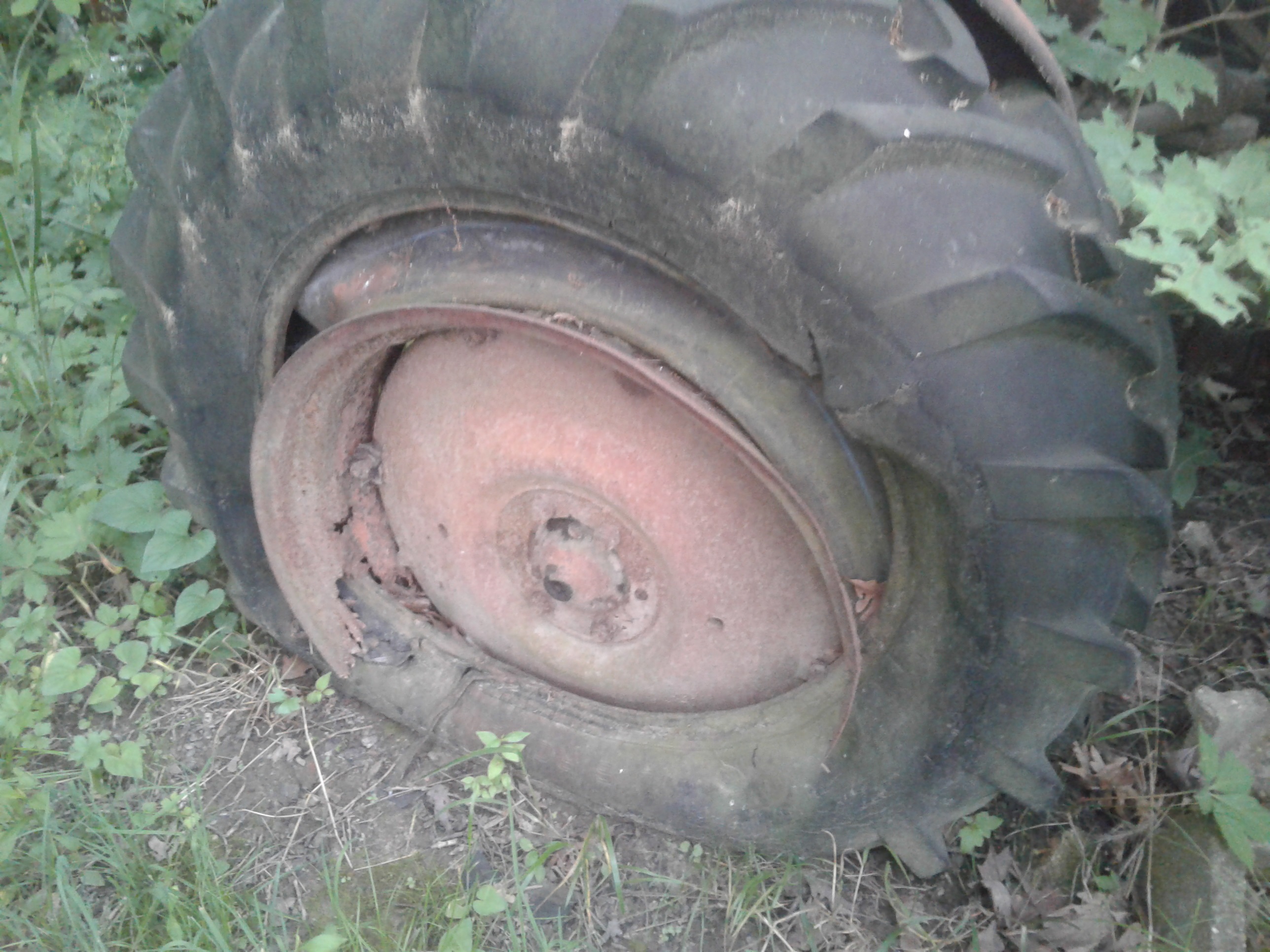

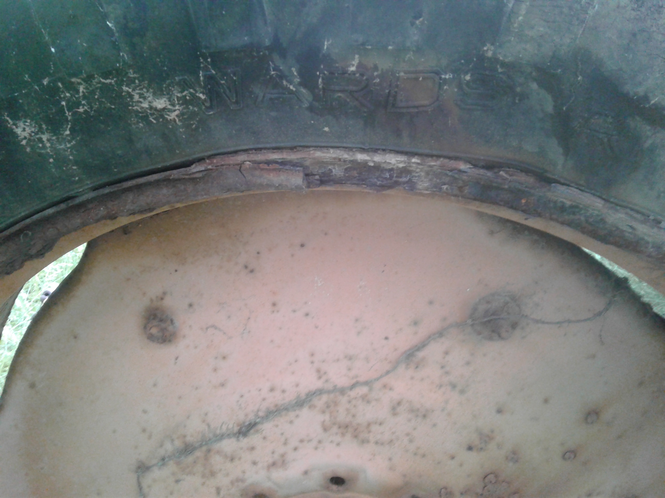

Guess what these tractor rims have in common, inner tube failure & salt water

   / Hobby Digging 5 acres Cheap Gentlemen Farmer #26
Unfortunately I am too technologically challenged to see the pictures but I can imagine. I really don稚 know what the best answer for tires is. It seams like they all have pluses and minuses. The only way for saltwater to get on the rim is for the inner tube to fail. If my inner tube fails my tire goes flat (and potentially a lot of the liquid leaks out. If I let the tractor sit for a long time with a flat tire the rim may sit in salt water. I have heard some old timers say salt water in the tire with no inner tube and the have done it since 1950. With limited oxygen supply in the tire the oxygen gets used up and the rim won稚 rust even when exposed to salt water. Just like metal artifacts at the bottom of the ocean that are preserved do to lack of oxygen. I think for everyone there maybe a different answer. I like those tires that just have rubber fins between the rim and the tread and you can see through them. They don稚 have much weight though. I was just pointing out I have seen aftermarket rims for jd tractors similar size to mine that negate the whole problem. Buy a rear tire online and for $50 more it would come installed on and aftermarket rim. My rims are over 20 years old. I sanded and painted it and put it back on. I am not sure how much more I can expect. Especially since this tractor has probably sat outside most of its life. I can almost guarantee you the steal rims on my Chevy 1500 wont last 20 years without needing to be sanded and painted and they only have air in them.
