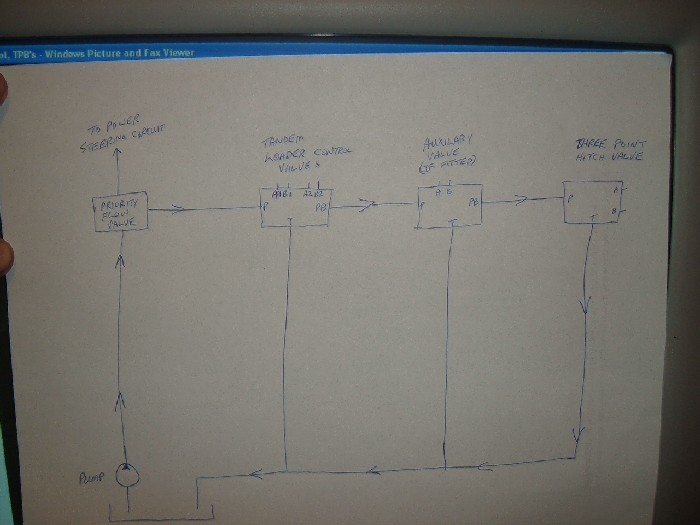

Henro or anyone who wishes to jump in,
I made a couple of very simple homemade drawings to try and illustrate what I think you are trying to explain. They are quite grainy as I had to resize them to get them to fit here. Pick them apart if you please but remember that they very basic. The first one shows the pump, then the priority valve that supplies the power steering the flow it needs when it is needed, then the tandem loader valve, next I just threw in an aux. valve and then the 3PH valve. If I understand just a little bit of hydraulics, there is a complete loop thru all of these devices with no valves shifted and the power steering sitting idle. With that scenario there should be no pressure anywhere in the loop other than a very low resistance pressure. Would I be safe to assume this?

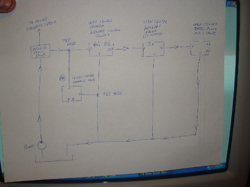

This drawing shows the same circuit with the closed center valve added in, I hope the way that it has been described.
Please explain to me if I've drawn this anywhere near correctly how you would have any pressure at point "AA" unless the loop was closed by anyone of the loop valves?
