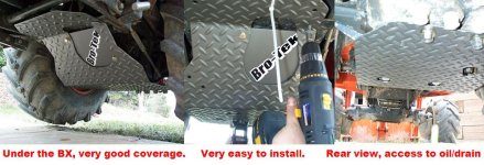

I think I hit a rock, sad thing is that I have the skid plate sitting in my garage waiting to be installed. The hold is near the transmission fluid drain bolt. I think there is no oil pan that can come out the transmission case is one big part. That is the reason why I need to weld in place.
   / Hole in hydraulic oil pan #4
Hi Tolga,
I was racing dirt/motocross bike in my young days....I did get a good repair on my transmission cassing, with an epoxy. It lasted all the years that I had it. It may be the easiest way to go. Once you get that done, take another 5 minutes to put the skid plate on..
