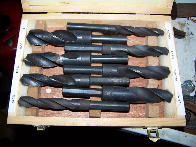

Harbor Freight has been said. That's where I bought a set of Silver & Deming reduced shank bits. I just used mine to drill a 1" hole through 3/8" steel. I started small with a 1/4" then just kept stepping up until I got to 1". Used plenty of spray lube to keep bits cool and a 1/2" low rpm drill.

Drilling the hole out in steps can cause the bit to grab because it will want to suck in to the steel you are trying to drill. Find your self a good 1/2" drill with two handles so you can get a good grip. If you use a quality drill bit you should be able to drill the hole out with the pilot hole you already have. Another option is a bridge reamer in a hand drill. They are great for aligning and expanding holes plus they don't grab. I have found them on ebay dirt cheep. The hole saw will probably make an over sized hole. Use black cutting oil no matter what you are cutting with but any oil is better than none.
I have a set of those and they've been surpisingly good. Seem to be good metal and hold up well.
