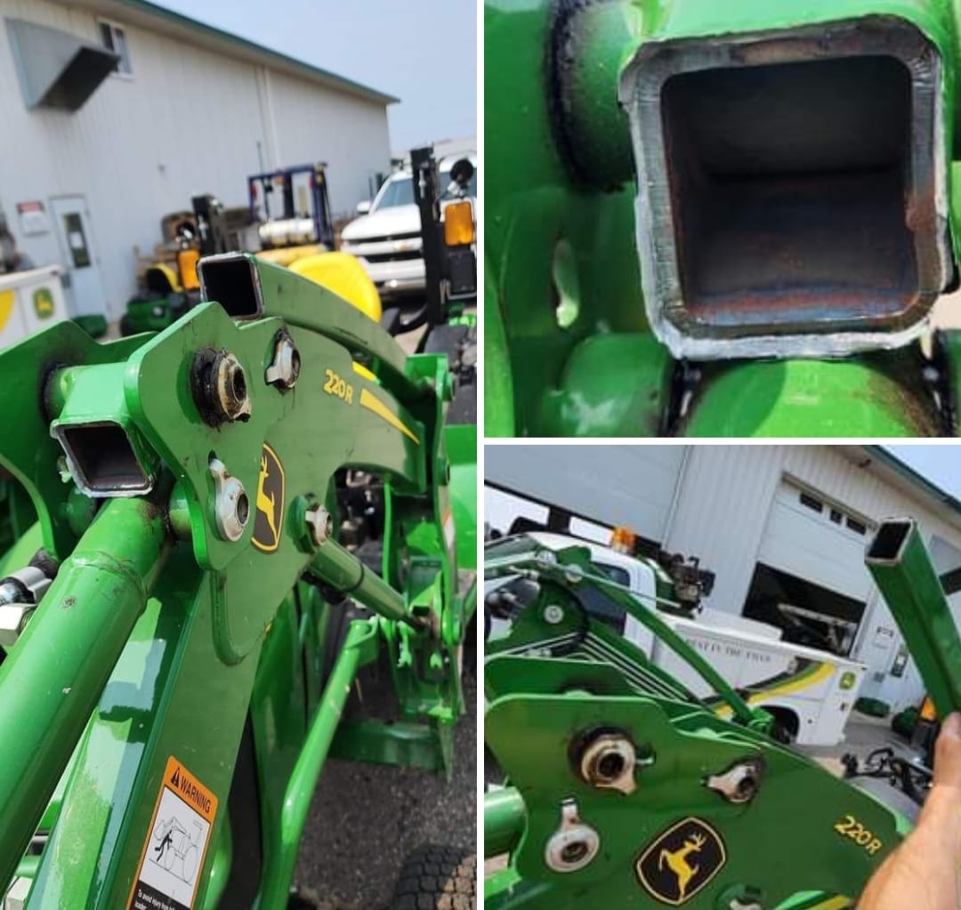

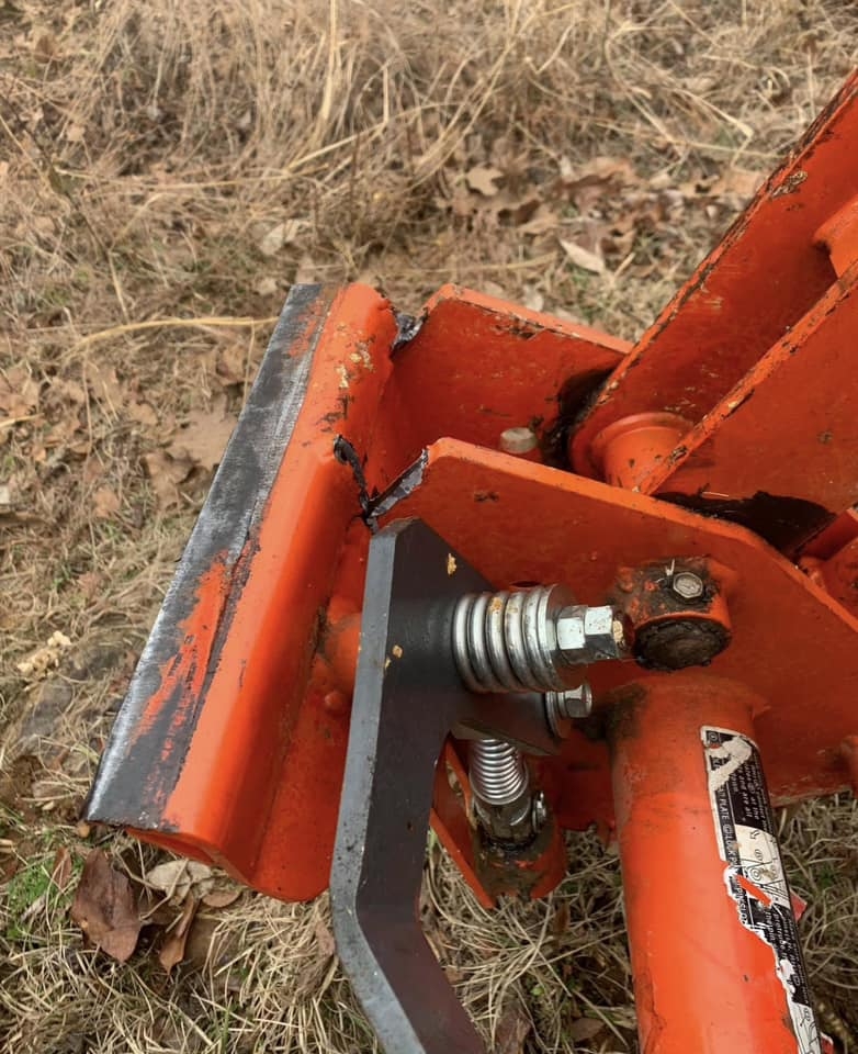

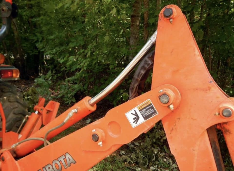

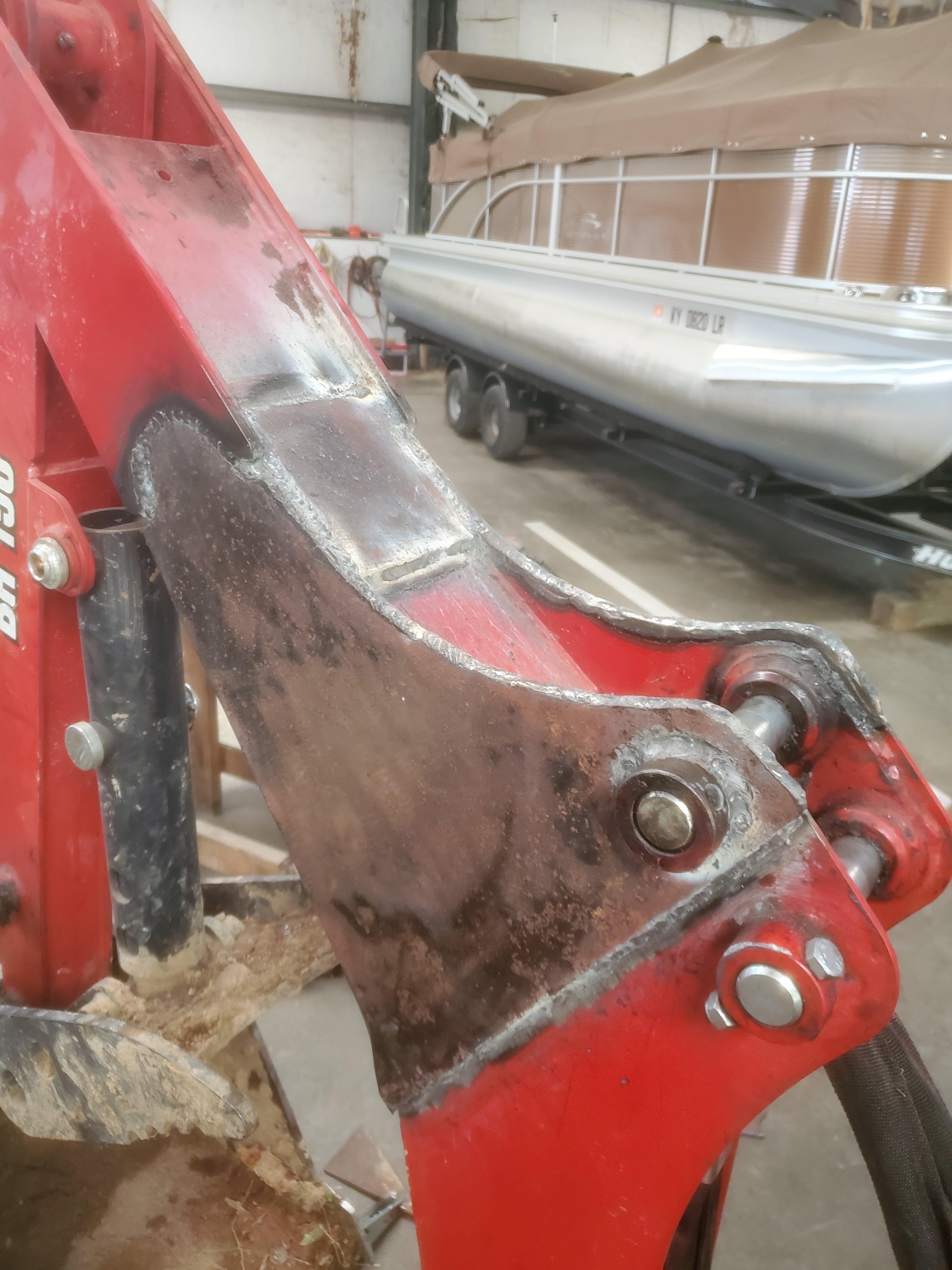

I'm not sharing these pictures to bash any brands or start anything. It's just goes to show it happens to all brands.

All legid concerns, but looking at the cracks on the backhoe, what would be possible an operator's error?
It is not a loader one can rum in to a stump. This part cannot be loaded more than the force of the hydraulic cylinder can develop, right?
