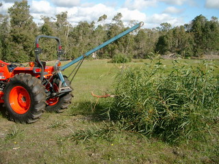

Here are (I hope) my first pictures. I hoped to use the boom on my L4400 to pull out lots of acacias that have become a weed on my property. It appeared to work ok. The problem I noticed was that the brackets for the 3ph were obviously too weak at 10mm. I have straightened them up and will be adding some bracing.
The boom is attached to a frame attached to the 3ph. This allows me to attach other implements to the frame. As a tight a..., I use as much recycled material as possible in my projects. This also means it has not cost me lots as I am also learning to weld.
Come on retirement. It is getting harder to return home after playing on the farm. But I suppose playing in my shed making stuff for the farm is nearly as good:D

cityfarma, I have this advice re your mechanical structures.
TRIANGULATE
Gussets are a good way to triangulate, just not the only way but will go a long way toward making things stronger without having to upsize all the materials (and increase welding difficulty.)

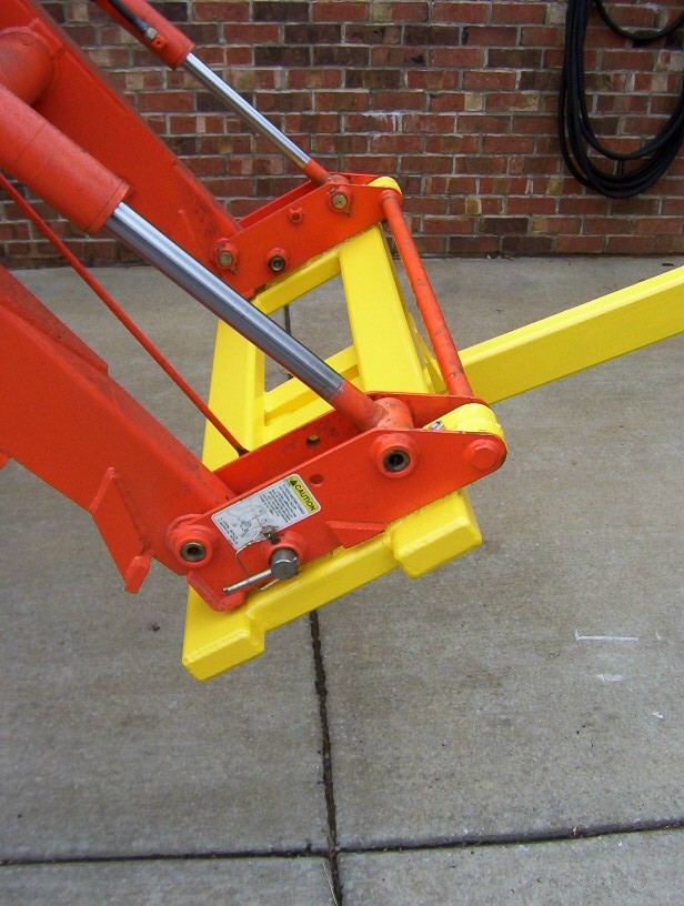

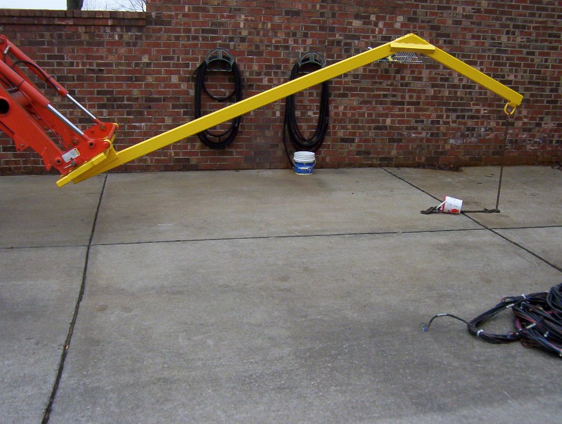

/ Home brew boom pole #5
Like this maybe
/ Home brew boom pole #6
I'm wondering if the bucket strength is sufficient for the possible loads that may be placed upon it.
Think I'd go for an independent unit something like the pictures posted.
Biggest concerns would be keeping the tractor with all four tires in the down position when things get high.:D
Pickers work real good.:D

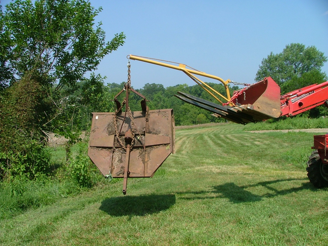

I put this together when I welded up the bucket forks....You'd need a big tractor though....this one weighs in at about 10K lbs....bobg in va
Bob, Yours is more like what I want. I won't need the BIG tractor as I will not be going after as heavy loads as you. You get more strength for the weight of materials used with a design along the lines of yours. I just need to lift lumber to build a barn and such. Nothing two guys couldn't pick up (<= 500lbs) but a second guy isn't often available. Without proper triangulation the pole would have to be really heavy to not get bent. A properly engineered light weight pole along the lines of yours will not be too much to wrestle with getting on and off.

Citifarma- When designing something always look at the direction that the force will be applied. If your crossbar was below your hitch-pins you would have been trying to stretch the steel, instead of twisting it. You would still have to gusset it but you would only be trying to bend the steel in one direction while lifting. Steel is hard to stretch but easy to bend. If you put a coupla thin steel rods forming a triangle above a boom pole it gets a lot stronger. If you try to put them under the pole, they will just bend. Always try to design so you are pulling on steel, not pushing or twisting unless you have a large cross-section.
/ Home brew boom pole #13
Citifarma, Said another way, steel has high tensile strength. Try to put stressed parts in tension not compression. Design triangulation and bracing so that "in theory" you could use a chain or rope. You can't push a rope. Design your braces to be pulled on not compressed.

Citifaram,
And again....... in another word, put the part in compression and take the load off of the joints. Look at the sort of gusset plate and the way I put pieces to together. almost every thing is in compression and even in the lower link I avoided the shearing force by using and angle piece rather than welding the pipe to a flat stock.
