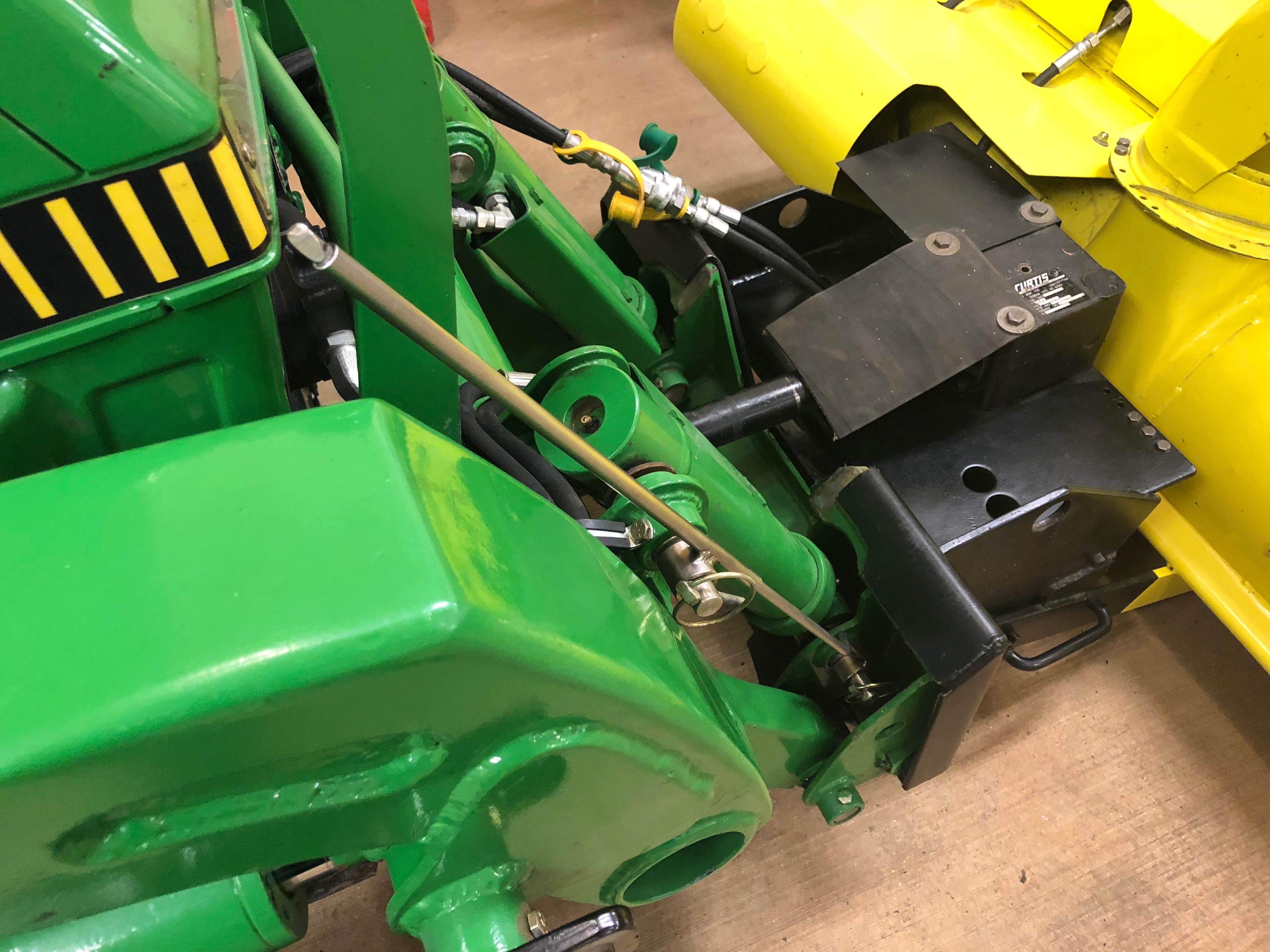

The level indicator is useful to keep a consistent relationship of the skids and cutting edge on my loader mounted snow thrower. I can roll back a bit to get the cutting edge down to pavement or roll forward to get the skids to hold the cutting edge higher over the gravel.
