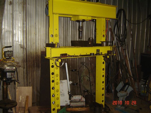

Bent the yoke on my drive-shaft pressing out the u-joint. I've used for pressing and bending and breaking stuff.
I can't imagine the pressure under 60 tons of force. You've got to be very very careful with that thing. Like a bomb waiting to go off. Very smart to have an extension on it.
Mine is a manual pump jack version with 12 tons, the thing will still jump off the floor when whatever I'm pressing gives up the ghost.
I like the idea of electric with remote switch.
Yes trip on legs and the boss blew out a tire last year when she ran a leg over on an angle (new Michelin, arguuuu).

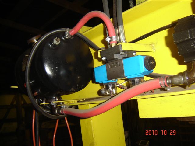

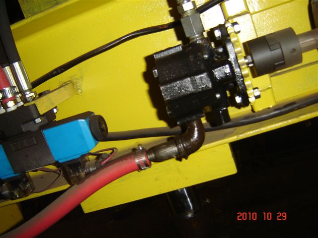

These lighter 12 to 20 jack presses have too much give in the frame and bed,that causes the jumping when the part comes apart under pressure and the frame straitens out again.
Mine doesn't do that cause its build so heavy
I can also inch the ram down 1/16" at the time by tapping the control button.
BTW I never trip over the legs cause they're only sticking out 14" either side.

I have the little H frame HF press, and it sure does jump! Makes you realize you need to build something much nicer. Or win the lottery and buy a commercial version. I do want a hydraulic powered one. I remember using a commercial one years ago and recall it had an adjustable setting for flow (or was it pressure?). Kept you from over doing it as you went. And I think it had a foot control.
   / home build 40 Ton hydr press #28
Mine doesn't do that cause its build so heavy.
Yeah, I agree. Mine doesn't jump either.
