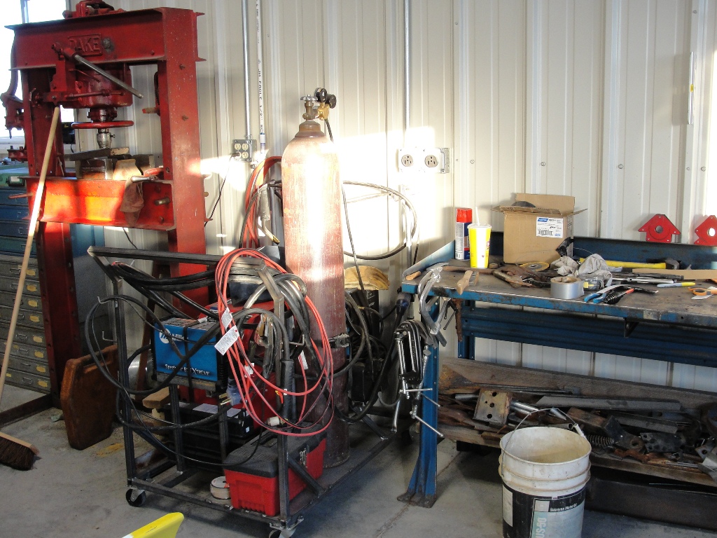

My picture isn't very good, but, I "stole" this press when I bought out a closing auto dealership shop inventory. Dake rates it at 50 Ton. Bison's press is built a lot stronger based on the pictures. His bench pins are certainly stronger. My press has a gauge and I've had it to 30 Ton. Makes you squint when standing by it. I'm with Bison, can't imagine not having a press now. And yeah,,,, I trip over the legs too... :)

I looked at some new and used 20 to 30 ton manual presses before.
I wasn't too impressed with the light structures versus the price they wanted.
The heavy build hydr presses where way beyond my budget anyway.
I figgured i could build it better and cheaper myself;)
