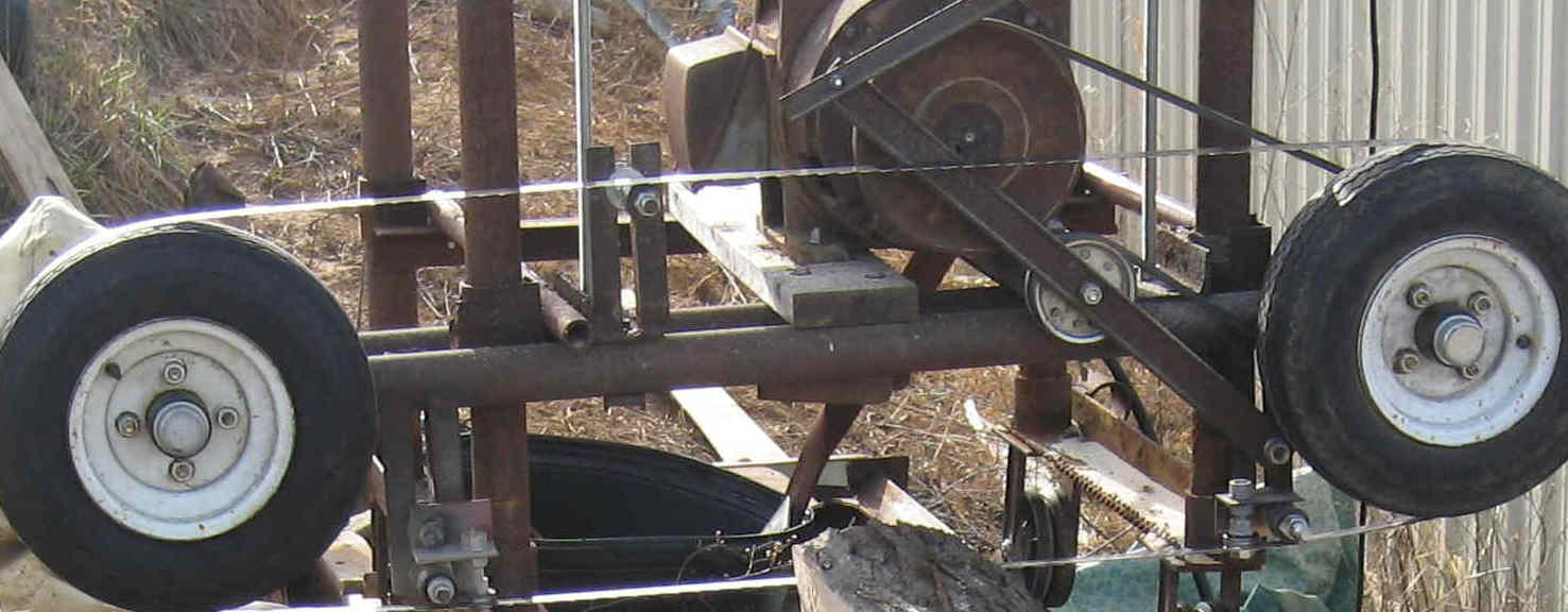

I have a 5 meter, 5" pipe around that would have been used as an antenna mast. I think it wil make a very good central frame tube for a sawmill, as it will give exceptional torsional stability. I think i will ask my boss if i can laser cut T pieces to weld on top of that to support 2 side mounted T bars mounted upside down, to act as sawcart rails. On a T bar, very little sawdust will build up so that's a good thing.
I will start with hand feed, but have a hydraulic motor with speed regulator on the shelf, which could be added later on, for power feed cut.
The saw is actually very simple and cheap but the additions like log clamps, hydraulic log rotators etcetera make them expensive, i think.
I will let the ideas sink down and rethink before i start spending money.

I was misreading (or misunderstanding) your posts: You said 10 hp would be enough, while i was calculating the max amount of Kw i could pull out the wire...
Anyways 10 hp is 7,5 Kw, and i just bought a used 3 phase 400 Volt 7,5 Kw electrical motor... Guess the price ??
...only 15 Euro... /forums/images/graemlins/grin.gif
I will pick it up this week and meanwhile, continue thinking...

As I mentioned, I am working with 5 hp of electric motor power- its a bit underpowered on thick logs. I think that your 10 hp electric motor will have plenty of power- as long as you don't try to cut any 1 meter logs /forums/images/graemlins/grin.gif
