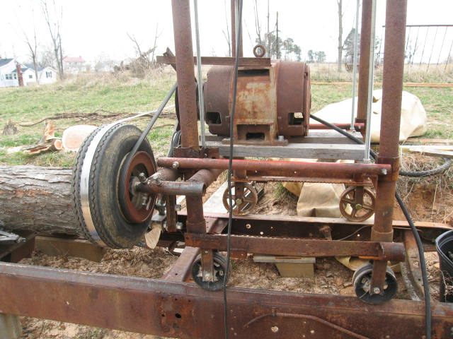

Here's the drive wheel. The edge of the pulley is welded to the edge of the steel rim (I was able to do the welding with the tire still on it)
I know I am a very sloppy stick welder- but I am still learning /forums/images/graemlins/smirk.gif
