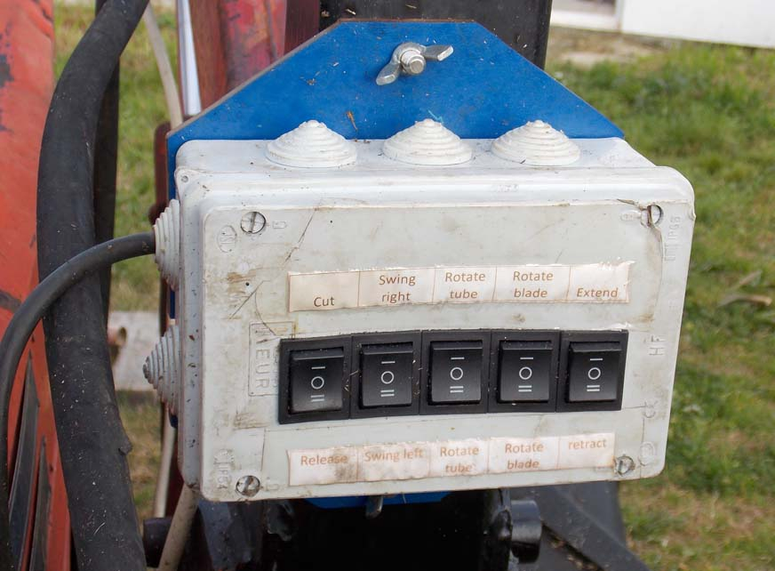

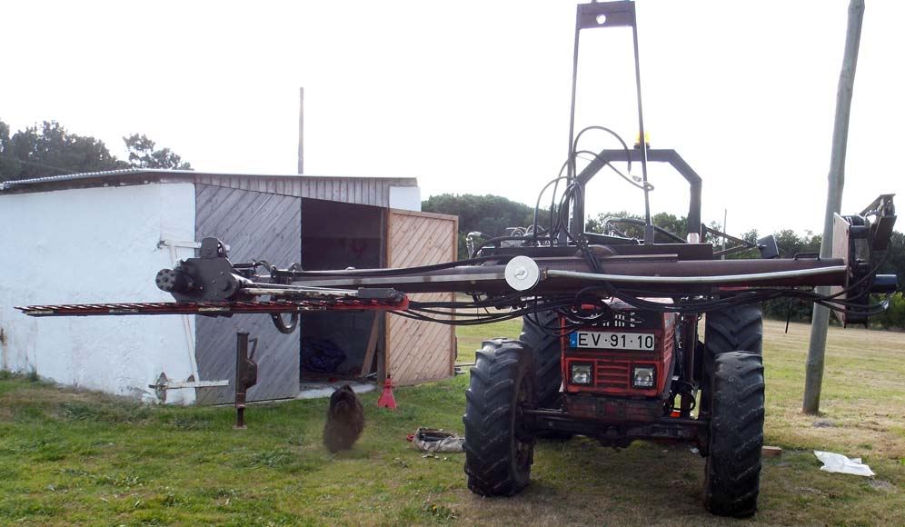

   / Home built hydraulic FEL mounted hedge cutter #26

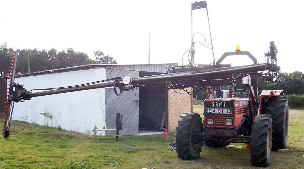

some pictures of it assembled;
Except the big cylinder is taken out in this one, I don't remember why.

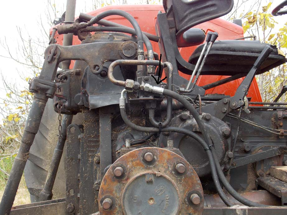

The hydraulic supply. The wheel has to come off to get at it.
The wheel is heavy.

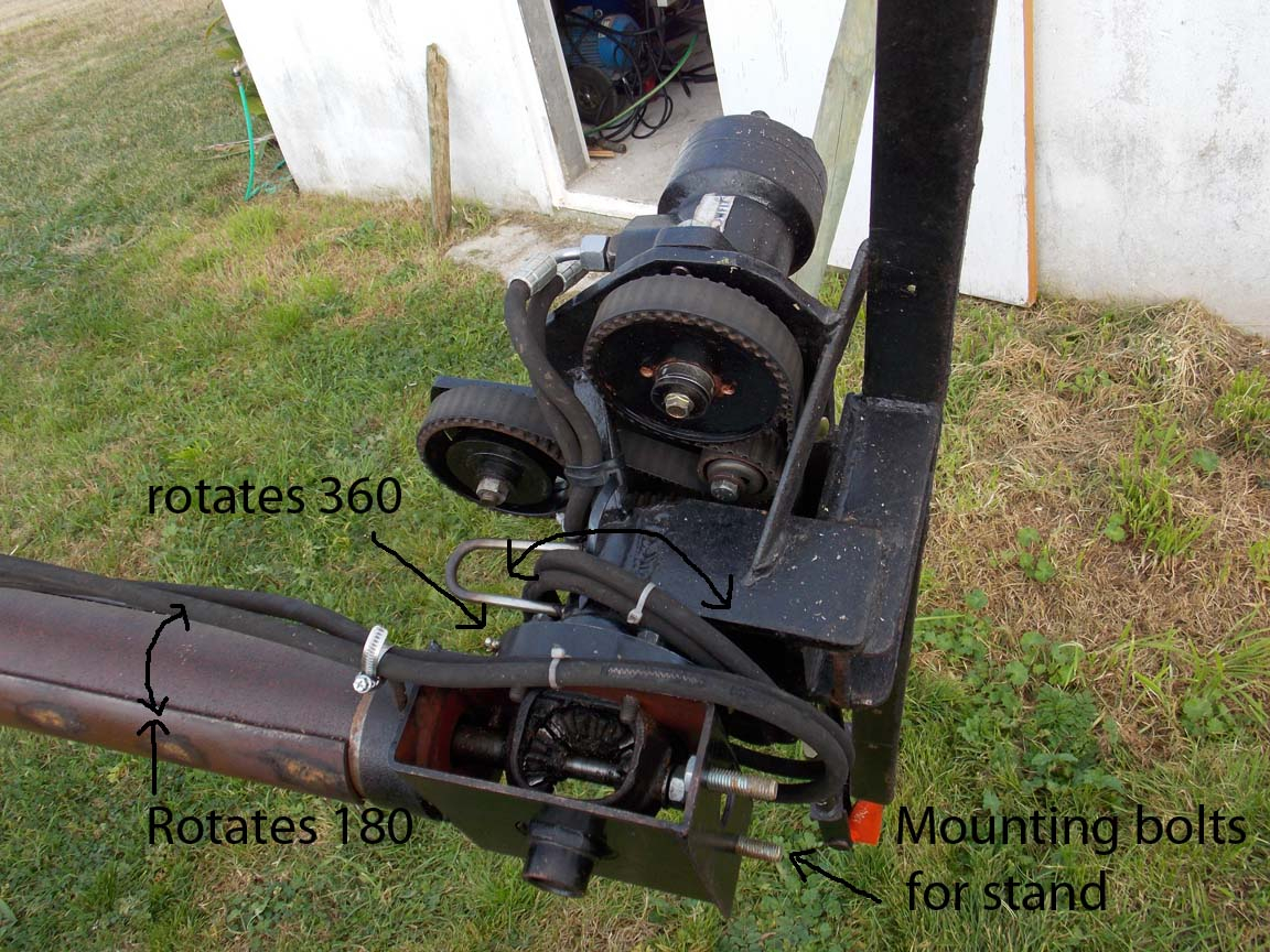

cutter head with motor + all;

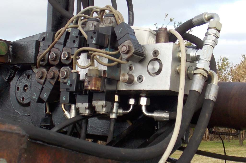

The valve block ready for action.
electric control box mounts on the rops.

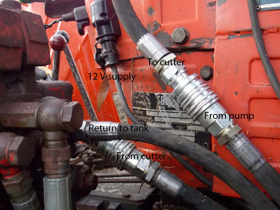

I interrupt the supply to the FEL, send it up the the hedgecutter, and back. When the hedge cutter is off, the quick couplers fit together so it works like before.
You tube video of it working at that time;
That is awesome. I admire your skills to think of that and then to fabricate / build it from old pieces/parts!! I am sure that first run was very satisfying.
#27
Thanks; it did work on the first run, but it took a few revisions to get it to where I'm reasonably happy with it.

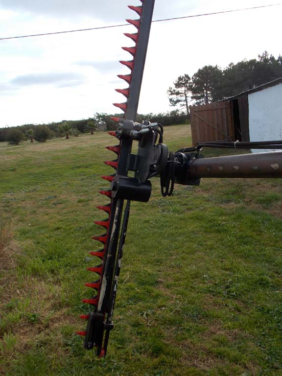

Absolutely amazing. Should patent. Could market this to county maintenance and private. Worth a few thousand I might imagine. Good job. Very technical and precise. Gene
   / Home built hydraulic FEL mounted hedge cutter #29
#30
Thanks; there's nothing new in there to patent, but it's a fun idea.
This machine is only able to cut up to about 1", and then only if it's still green. The concept could be beefed up, but will always have an upper limit.
On the plus side, it makes a very neat cut compared to the shedding that flail mowers do.
