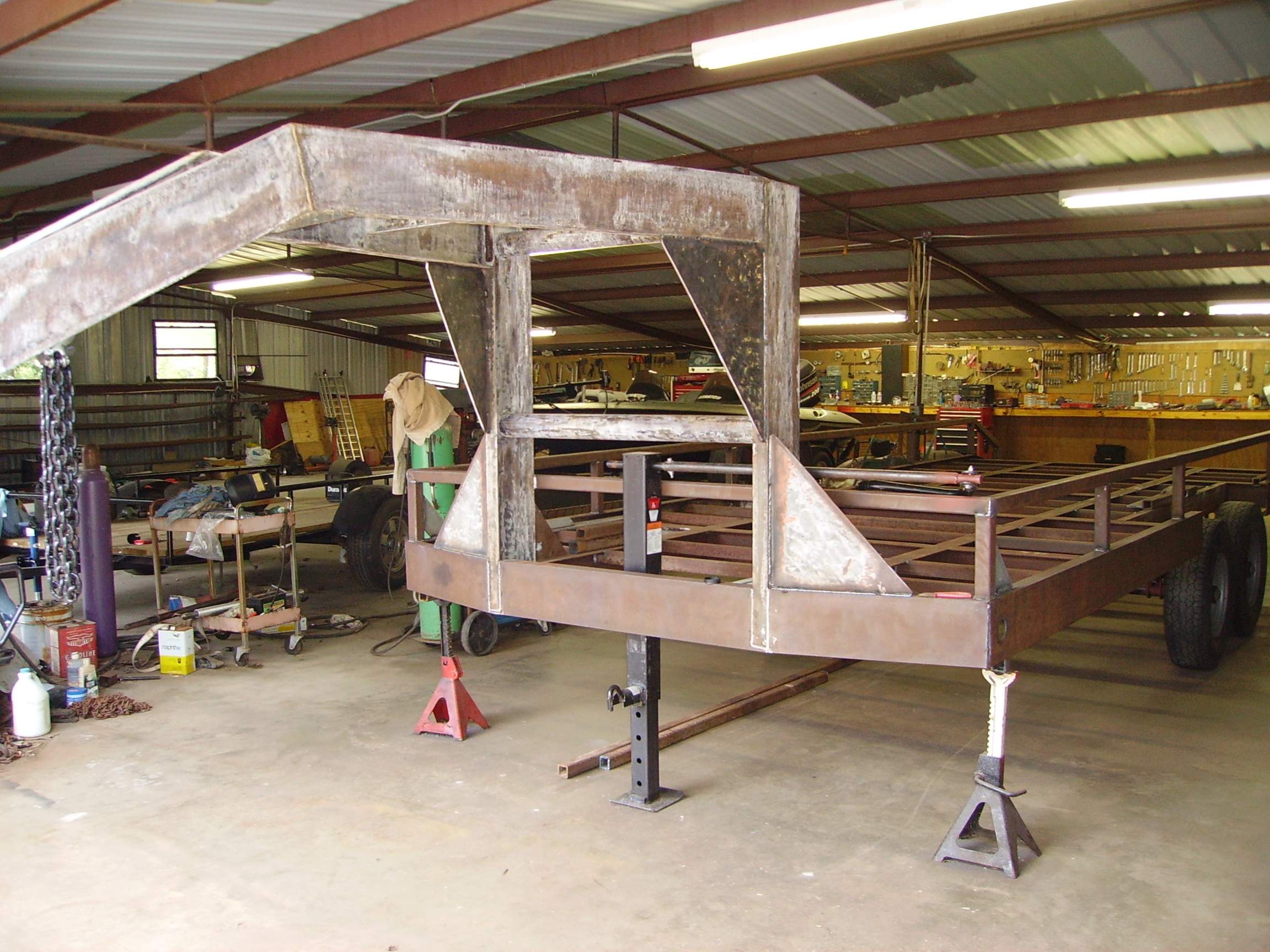

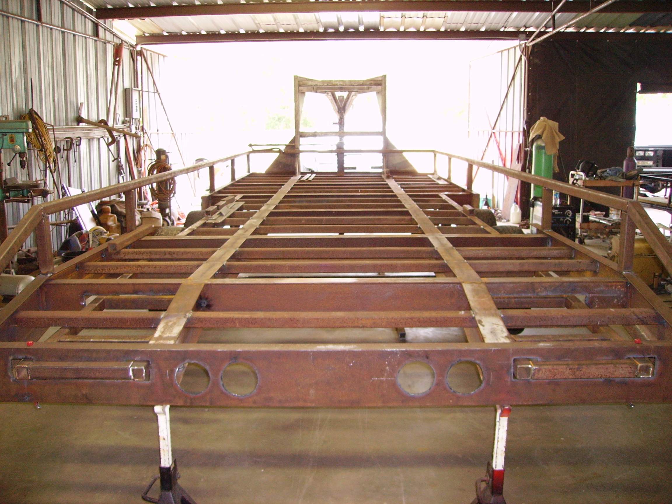

A friend of mine started building a 22' gooseneck then quit due to other projects, then i bought it from him, it was the gooseneck and the inside frame work. the first pic i took we had alot done before i started taking pics. I did all the cutting and fitting and tact welding, and James came alone and did all the welding, that way i wont fall apart going down the highway, I did learn how to weld good before it was done and end up buying a miller 180 mig machine, and let me tell you its nice to have.

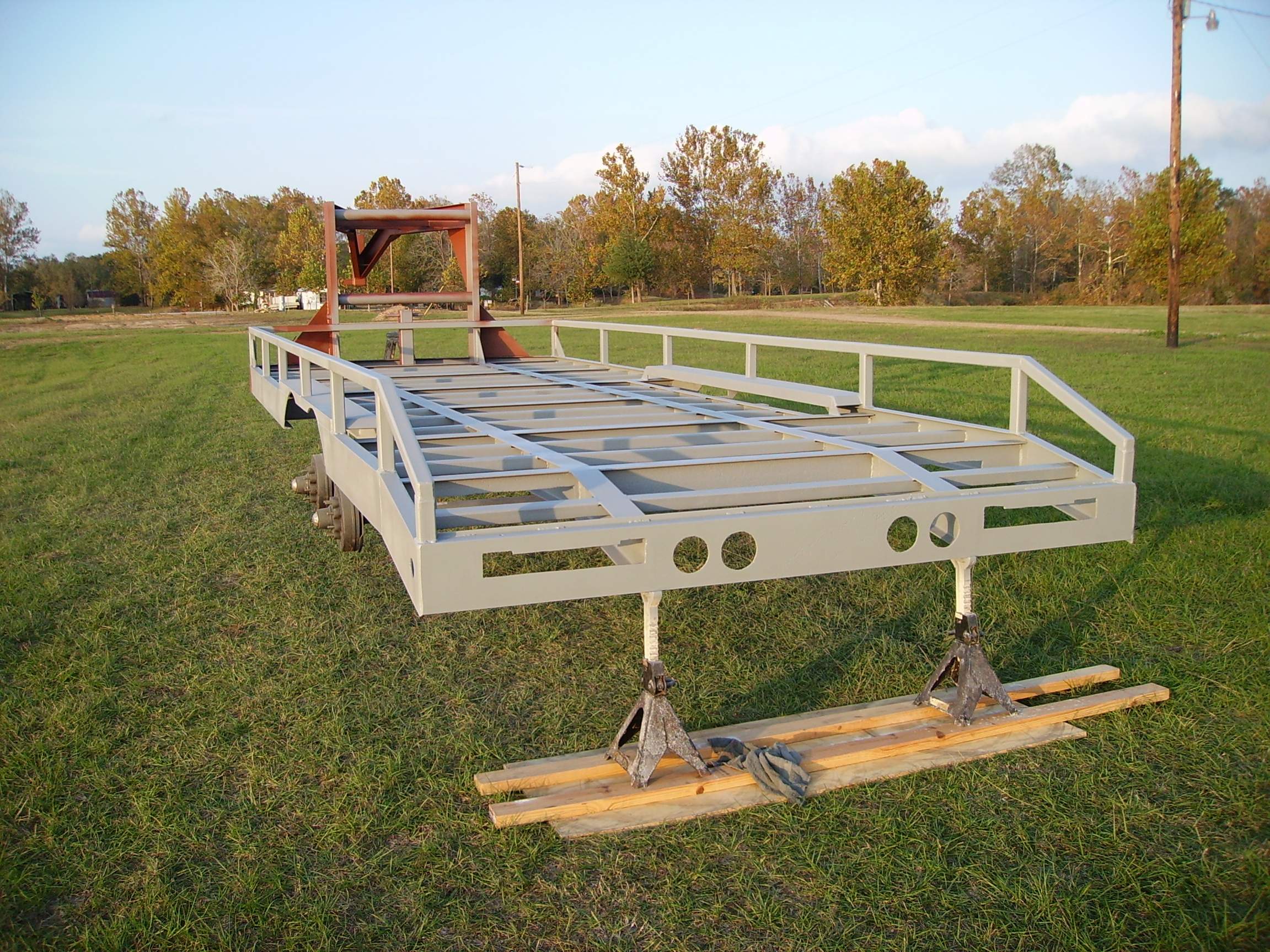

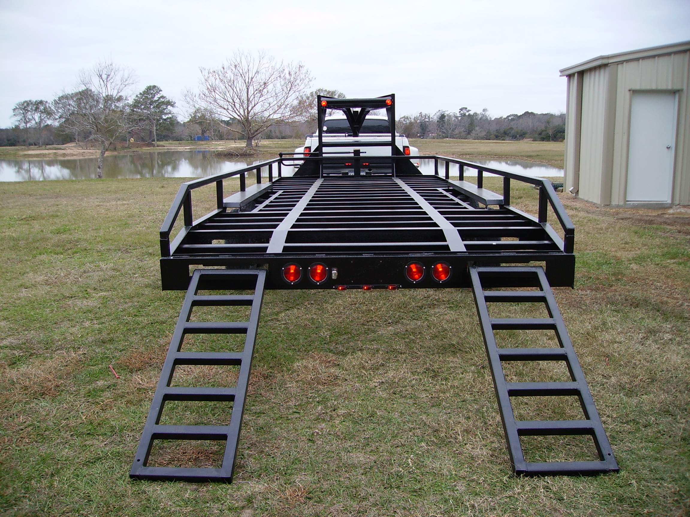

Then i took to my shop and spayed it down with rust killer and wire buff it until all loose debree was gone, pressure washed it then wipe down with thinner, and then prime it, painted it the next day, mixed hardner with the paint, it realy did help on the gloss of the finish and the paint dryed faster. And to me the paint dont chip as easy as without using hardner.
I did all the wiring and lighting on the trailer, and installed a brake away switch with battery back up. From start to finish, i got less than $2100 tied up in the whole trailer, it took about 6 months, But building a good trailer is like fine wine, its all good in time. I guess.

When i bought it, it had the goose neck frame and the main frame in one piece, then i started from there, and no didnt have any prints, just looking at other trailers.

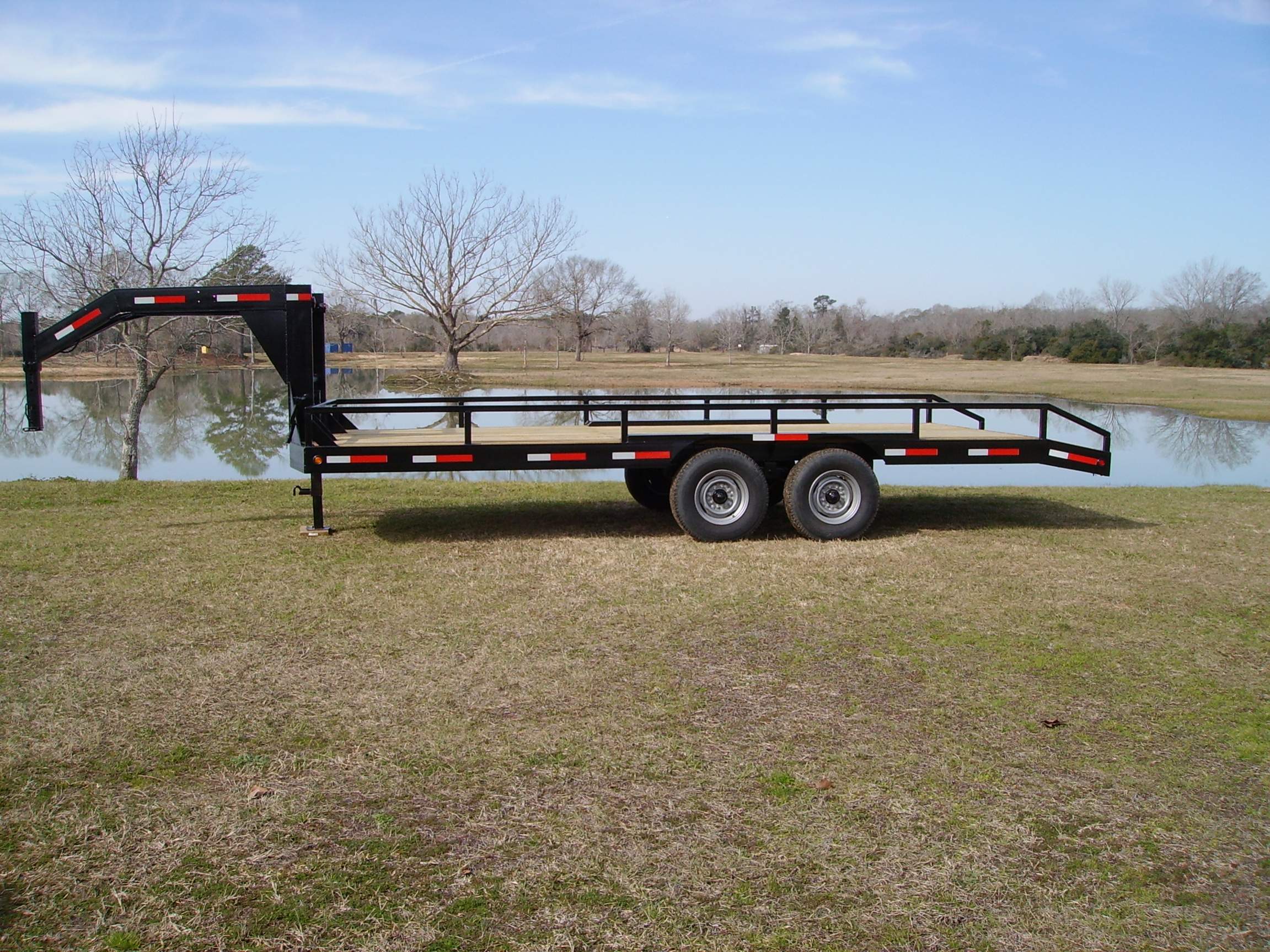

Pulls real good, and alot better since i got a new ML-265 FEL for it. before i could only load 5 round hay bales on it using the 3-point to load them with, now i can put 15 on it since i have the FEL, i only put 15 on it moving bales out of the pasture, and put 10 when on the highway. not sure what 4x5 bales weigh, but from looking at the tires, it must be heavy.

The deck is just 2" treated lumber, from 2x6's and 2x10's and one 2x4 in the middle. And far as the cross members, I think they are around 14". and i can load the tractor on it without the decking. In the one pic, on the 2' dove tail, i grinded the top of the deck so it would be smooth, as you can tell the darkness in the wood.
