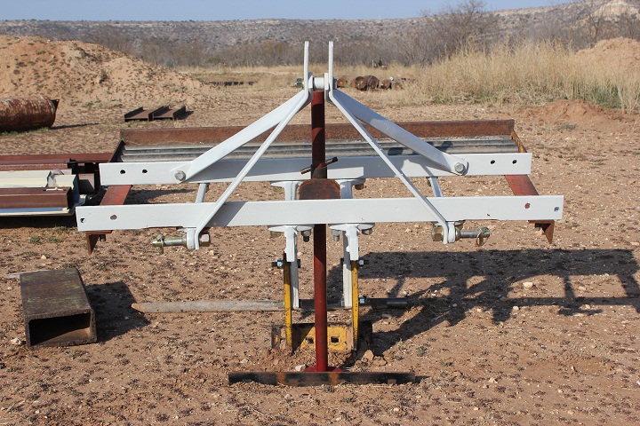

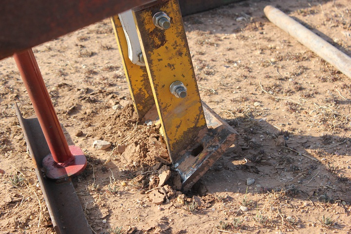

#14
This is the small grubber I put together. It is used to grub yucca, small mesquite, juniper, and a blue bush we seem to have alot of. It is made from an old Ferguson 3-point plow frame. The frame came with the 2 plow shanks. The footpieces are made from 3/4" x 3" flat. The cutting edge is fabbed from a recycled end bit. The end bit came off of a D5 Cat dozer blade. I found out rather quickly I needed additional weight to get it to take the ground well. I added an angle iron frame and load it with sections of 1-1/2" pump shaft and a section of 4" x 6" x 5/8" thick rectangle tubing.
