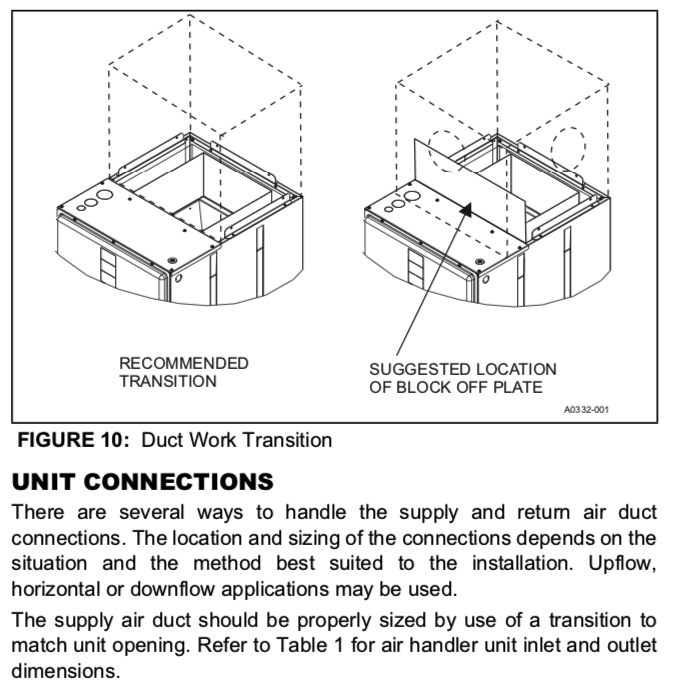

WAY back when,, I studied HVAC for a while,, we were taught that the plenum should be sized identical to the outlet of the air handler.
The identical sizing was to eliminate turbulent air flow, or to reduce rumbling noise as the air entered the dead space.
I have looked on line, I can not find any "rules" for plenum design,,,
Seems like you should of been in charge of the job...
That block off plate is exactly for that air turbulence you speak of.
Every manufacturer does written instructions differently. I always remembered these.
Generally if you don't want to rip the duct work apart to get the exact size, look it up, and then pre fab a custom transition from the supply opening of the unit to a transition to the existing ductwork.

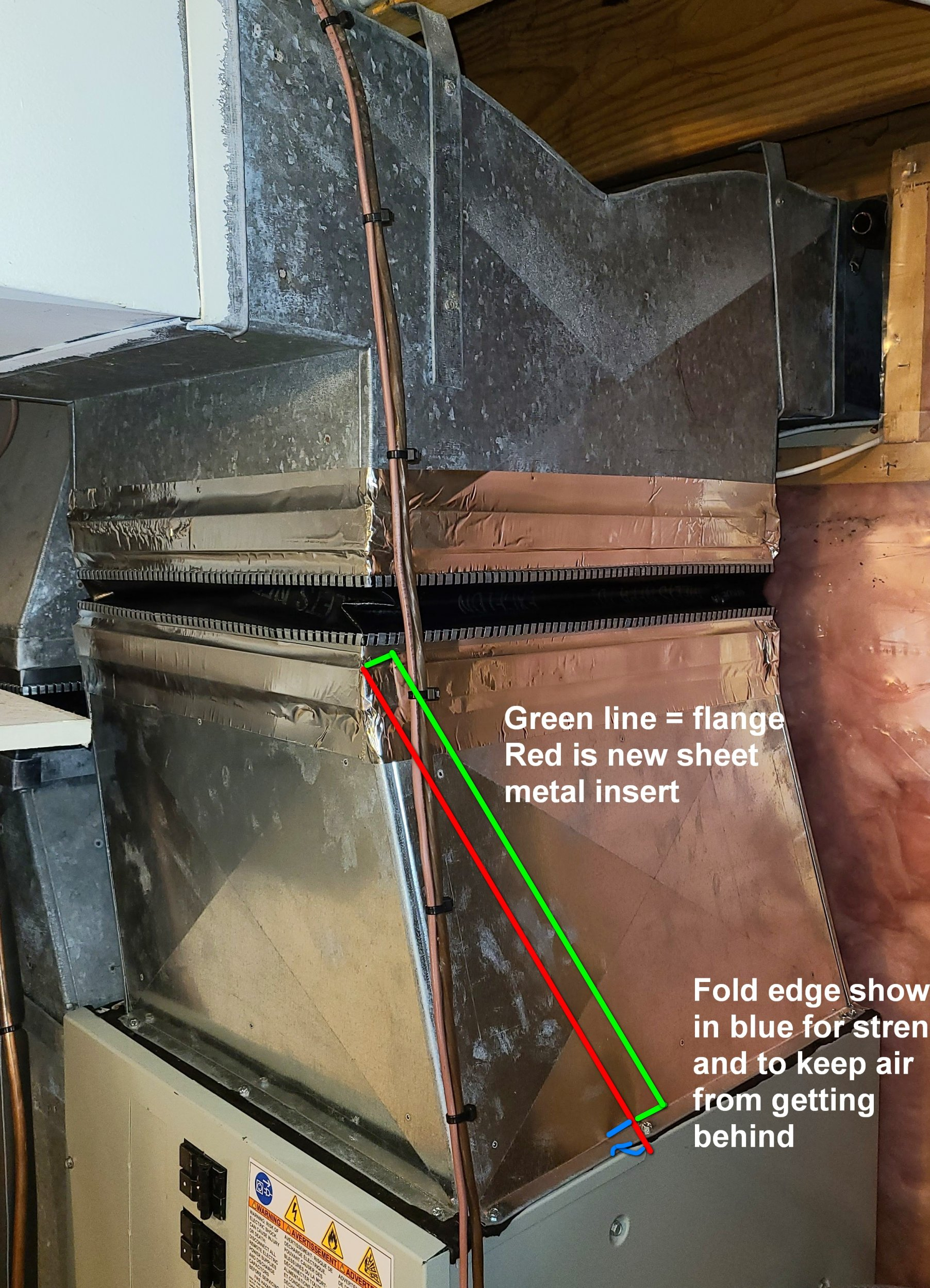

You could mark the location of the air handler outlet on the existing duct transition, take it to a sheet metal shop, and get them to fab a new transition without the dead space.
If you are comfortable bending metal, you could also insert a diverter as shown. I'd bend flanges on the sides so you have something to screw or rivet to the existing transition. I'd also bend a lip on the ends for strength and to try to keep air from getting behind the diverter. The crimps in the existing duct transition will make it practically impossible to bend the metal exactly to size. You'd have to close the gap with HVAC foil tape.
You could pick up a sheet of galvanized from Lowes. https://www.lowes.com/pd/IMPERIAL-24-in-x-3-ft-Galvanized-Steel-Sheet-Metal/3234805
The other thing that may be contributing to this situation is you essentially have a "T" in the duct at the ceiling. The air flow is hitting that T and this also contributes to resistance in how the air is flowing. Also, note that the air is leaving the air handler at a angle relative to the other ductwork.
Yea, I think I am going to try adding that baffle similar to what you have drawn.
But, I think I am going to bend the bottom 1/3 so that it ends up a smooth radius from vertical to the angle,, with about a 4" radius.
As far as the "T" at the top,, that was part of the original install, and the original was very quiet, no rumble, at all.
The installer tried to blame everything, other than his work,
he even said that when I switched from a 20X20X1 filter to a 20X25X4 filter, I increased the air restriction.
(The new filter has about 5 times the surface area of filter media,, WAY less restriction)
So, I removed the filter, and let the unit run with NO filter,, still noisy,,
Even after removing the filter, he said the return was TOO restrictive,,
His solution was going to be to install a 20X20 unfiltered register in return duct, in the un-conditioned basement.
I stopped him,, he did not understand that the new return would suck dirt right into the air handler,,
and, sucking air from the un-conditioned basement would GREATLY increase energy usage,,
Maybe he did know,, and I would be paying for service calls, every two years to clean my evaporator coil,,,

A radius might very well improve air flow and wouldn't be that much additional work.

Good tin snips, mallet + welding table works for me. For a job this small, good snips and a small seam tool will work. https://www.harborfreight.com/6-inch-jaw-straight-sheet-metal-seamer-98728.html
If this is the only air handler in the OP's house, all the air in his house is running through this duct. It's very important that the air flow at the air handler be as smooth as one can reasonably get it. I wouldn't hesitate to buy the sheet metal, HVAC foil tape, seam tool, and snips to fix this. The snips and the seamer are also very useful for metal roofing and flashing work.
