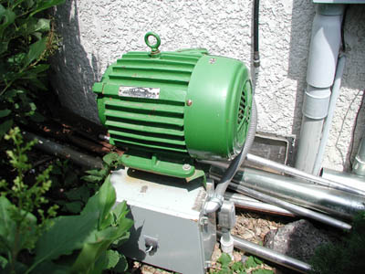

The idler motor on my converter is mounted on a post outside so you don't heve to listen to it run and it takes no room inside. It's a 10hp enclosed fan cooled motor with the shaft cut off so no one can get tangled in it. It runs a 5hp compressor, 3hp lathe and a 7 1/2 hp pressure washer all three phase and not at the same time. At first it used a voltage relay for the start circuit but now I have a timer relay instead. It has been no problem since, a couple of seconds gets it going. Never tried a welder with it but I've read it takes a really big converter to do it. There have been some posts about the welder stuff over on the www.chaski.com machinist board.
