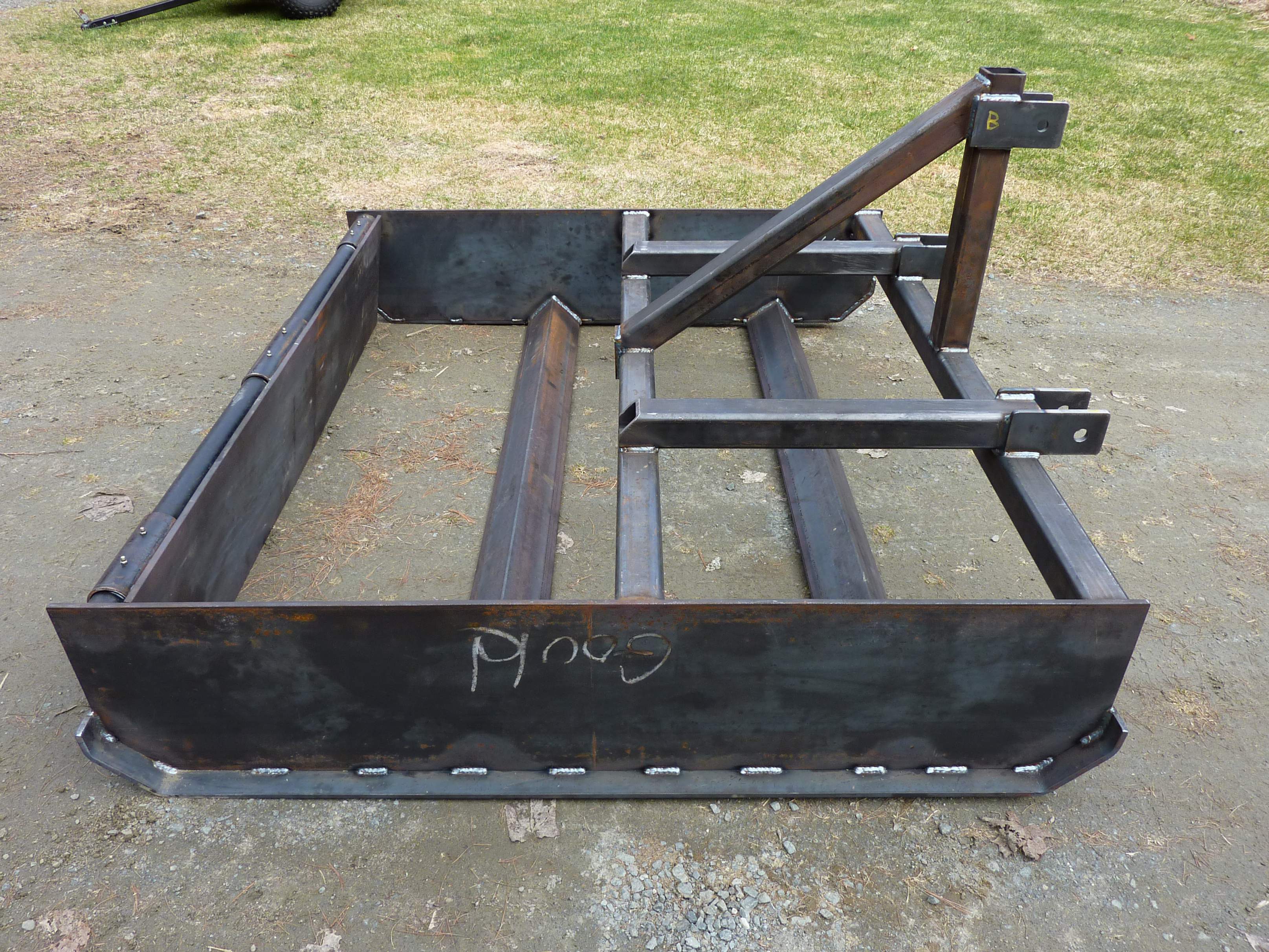

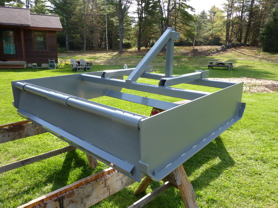

This is my LPGS built in the spring of 2010.

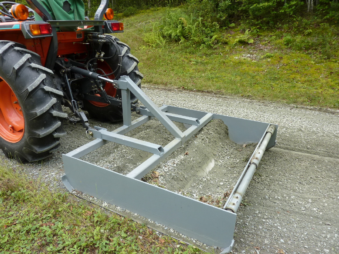

/ Home-made attachments... #4

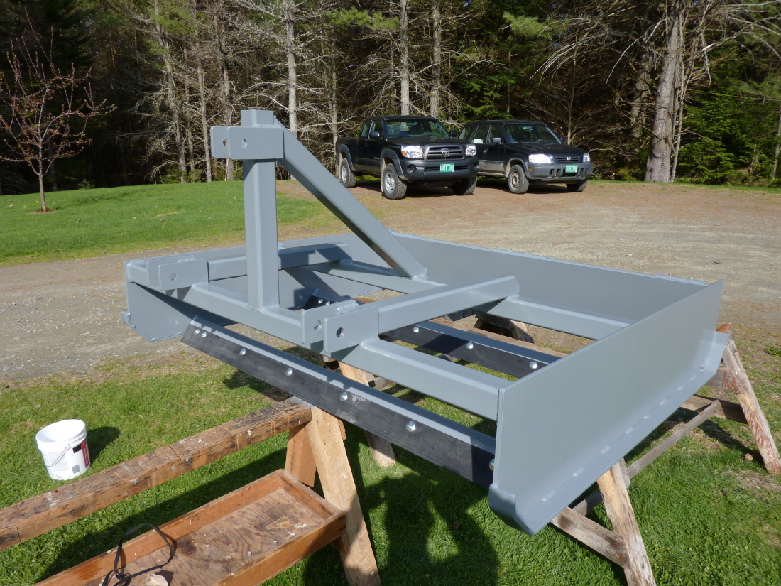

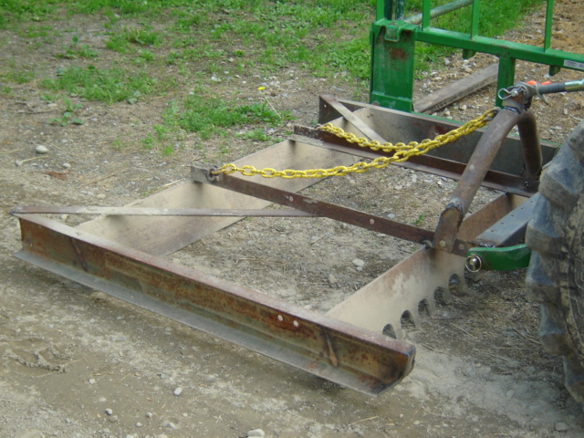

I made a box blade that I use to level the driveway in the spring and move snow in the winter.:thumbsup:
/ Home-made attachments... #6
Question: where did you purchase the cutting edge? Also, how far did you drop the edge below the frame?
Nice land plane by the way.

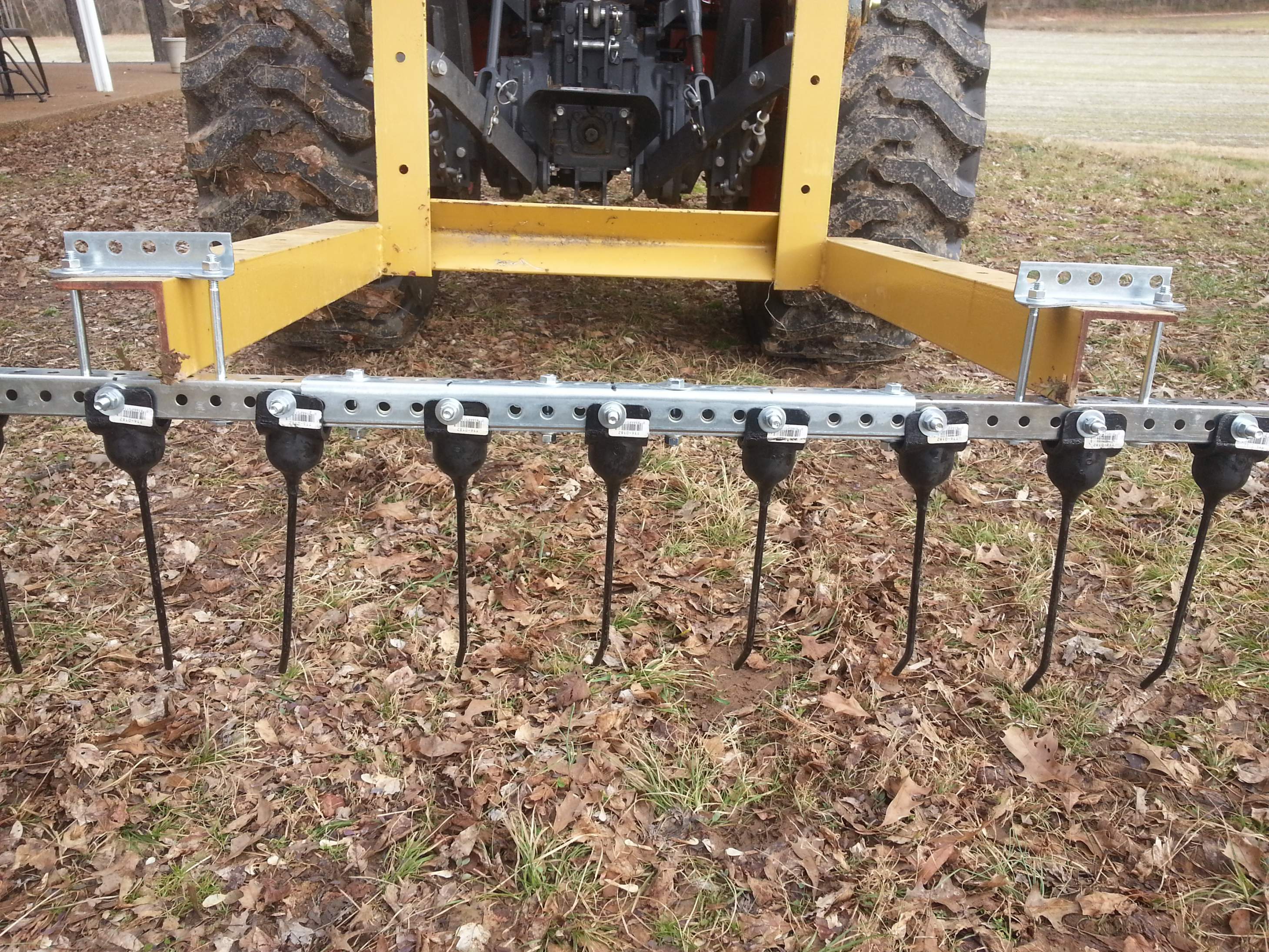

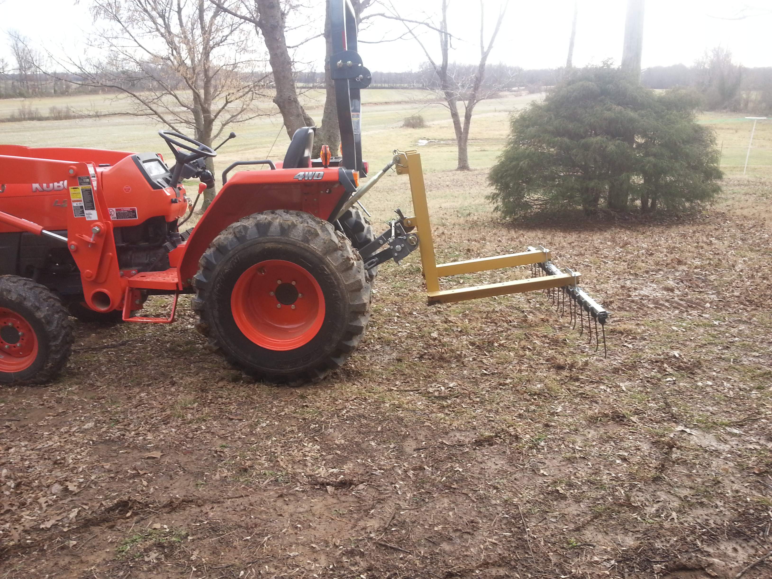

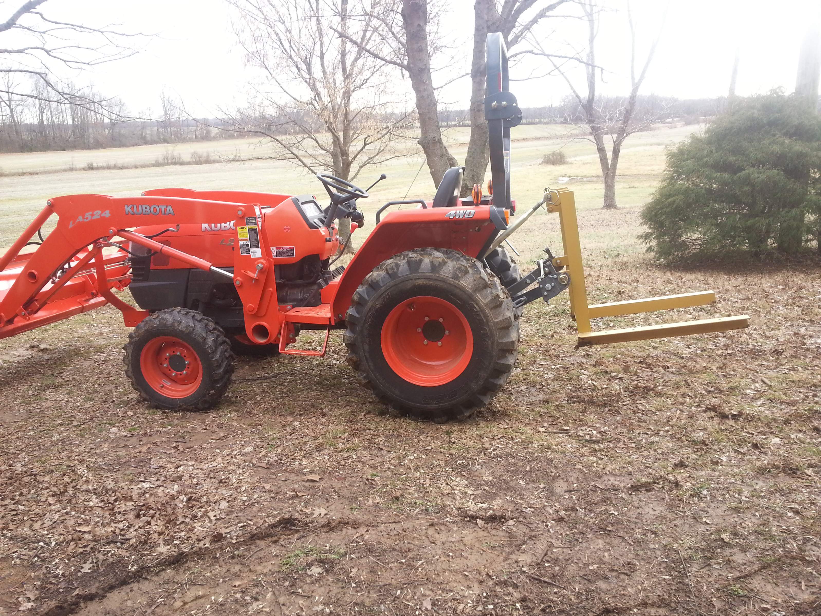

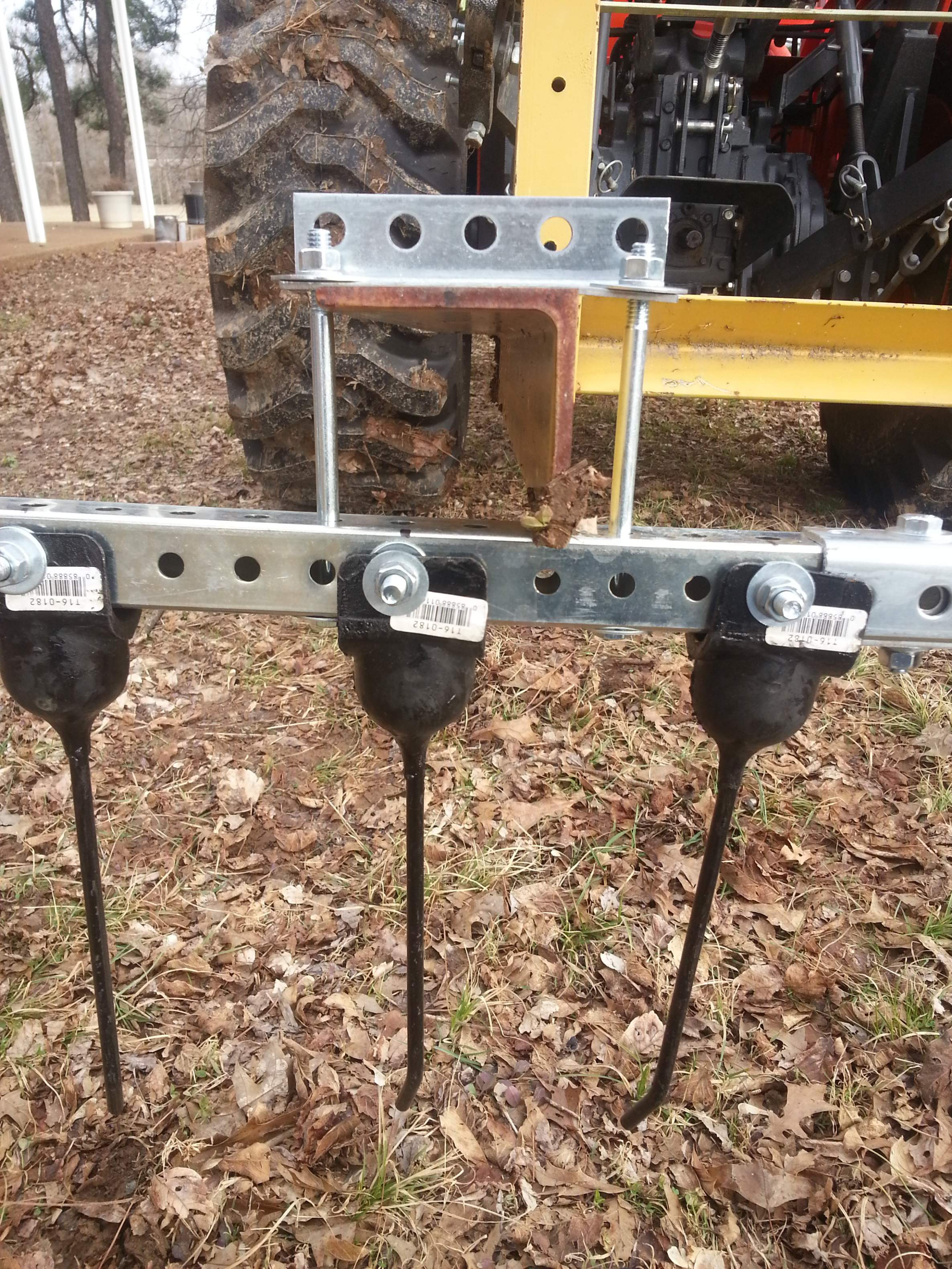

Started this thread yesterday: http://www.tractorbynet.com/forums/build-yourself/300969-good-landscape-rake-cheap-part.html
This rake is just for pine needles and any leaves that happen to get mixed in. It was also to prove I could do it.

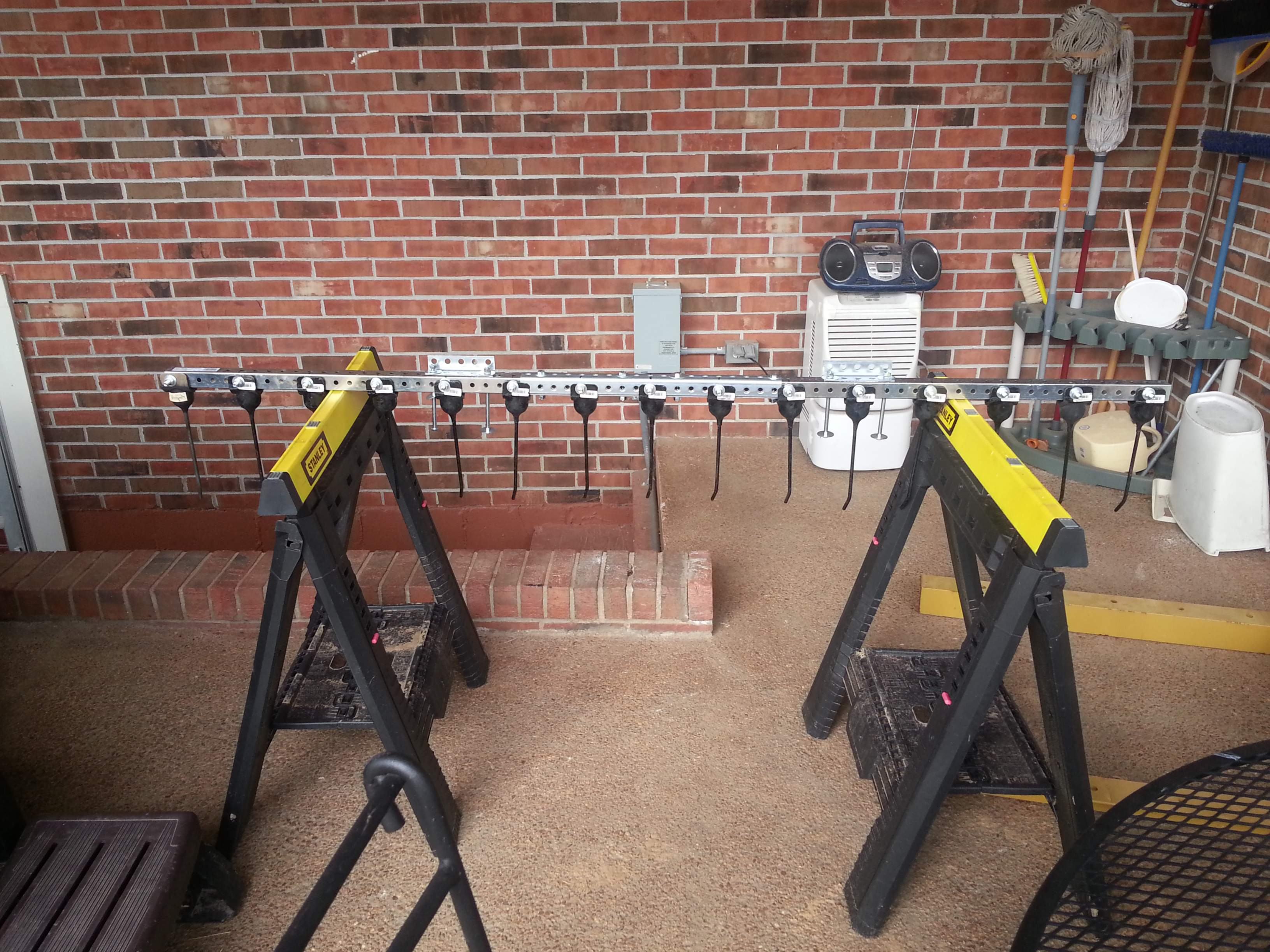

Here's my initial entry:
Back in December I saw this thread Good landscape rake - cheap. To summarize, if you don't want to read this thread, member RedDirt built a landscape rake from hay rake replacement teeth, a piece of pipe, and some angle iron. I decided I could do something similar and attach it to my King Kutter carry-all. Here are the results:
1) View attachment 355124 2) View attachment 355125 3) View attachment 355126 4) View attachment 355127 5) View attachment 355128 6) View attachment 355129 7) View attachment 355130
Pictures:
1. Yard rake on saw horses
2. Close-up of the rake teeth and clamp

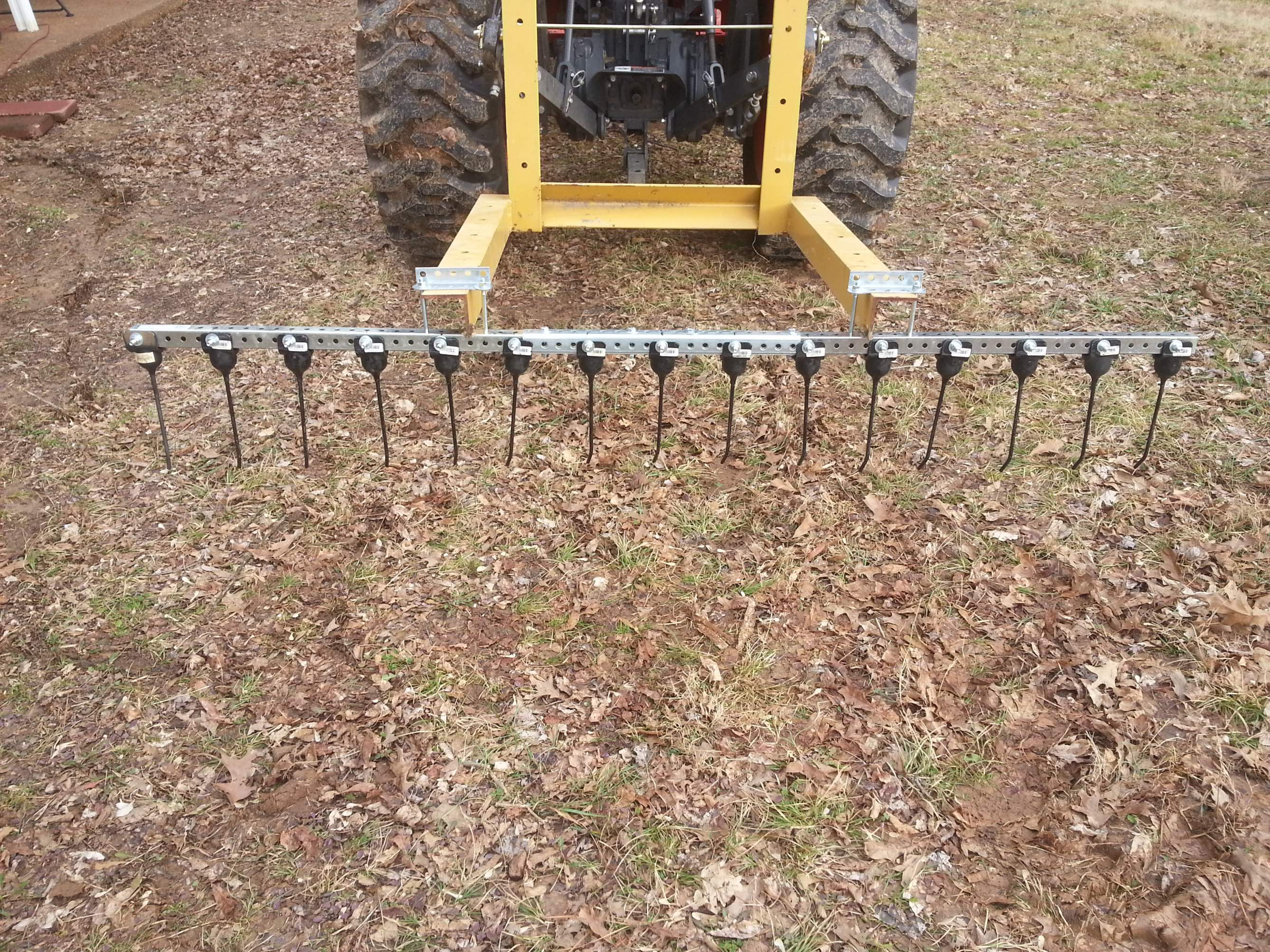

3. Tractor with Carry-all on.
4. Tractor with rake - side view
5. Tractor with rake - back view

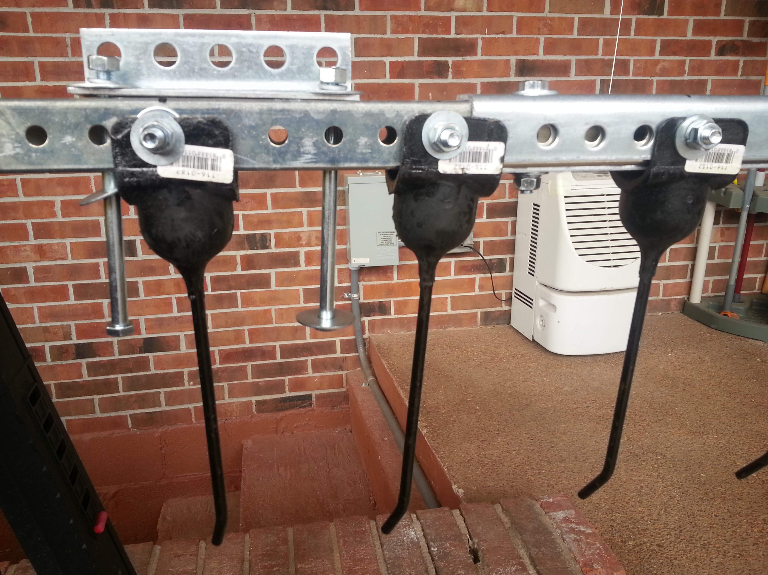

6. View of clamps on Carry-all
7. Closer view of clamp.
Parts:
1. Rake teeth 15@ $1.99 each
Herschel Adams Universal Rubber Rake Teeth T16-0182 by Herschel Adams for $1.99 : Rural King

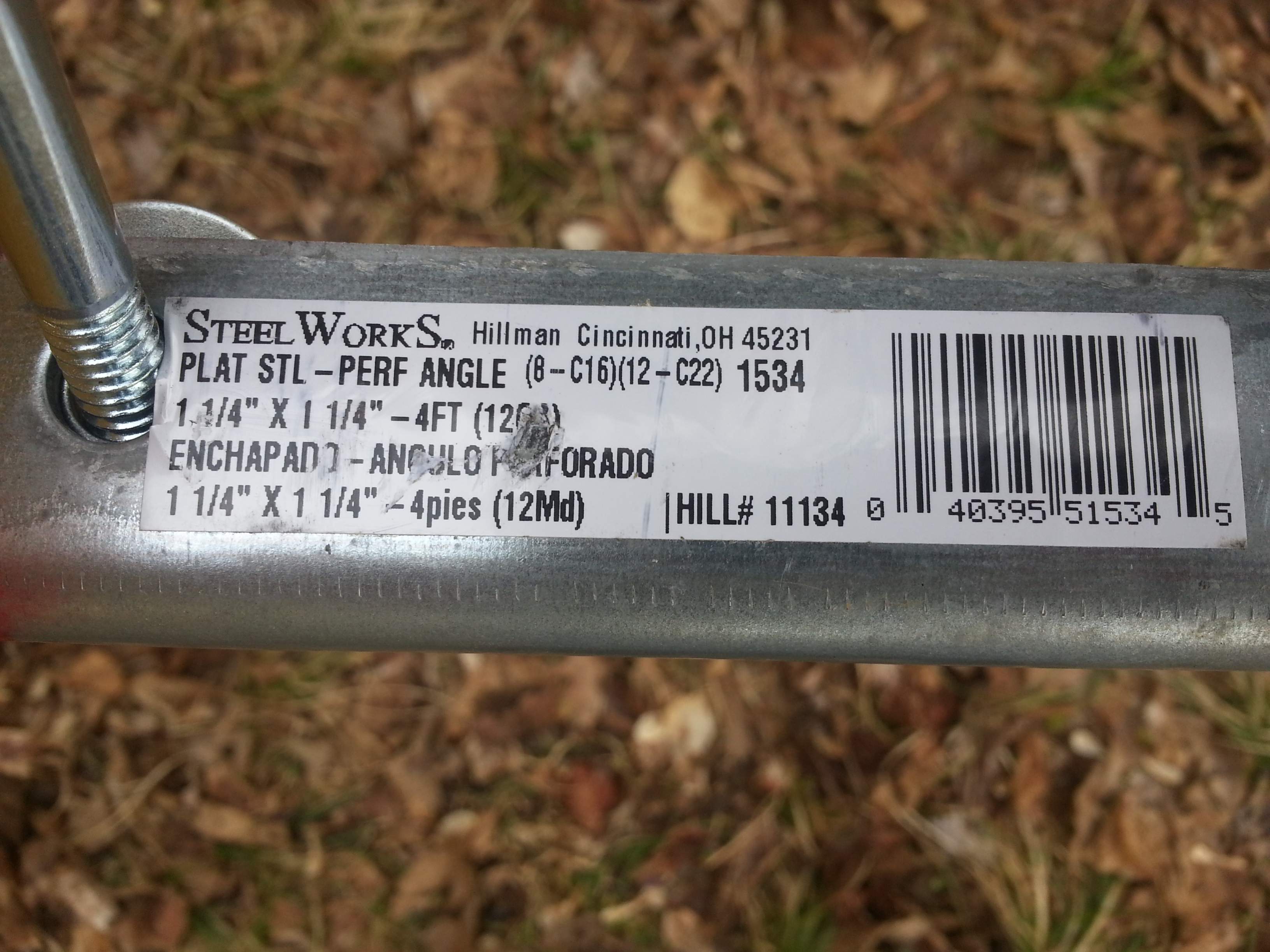

2. Steelworks 4-ft x 1-1/4-in Plated Steel Perforated Angle 1@ $14.08 View attachment 355131
Cut into: 2 - 5 inch; 2 - 19 inch
Shop Steelworks 4-ft x 1-1/4-in Plated Steel Perforated Angle at Lowes.com

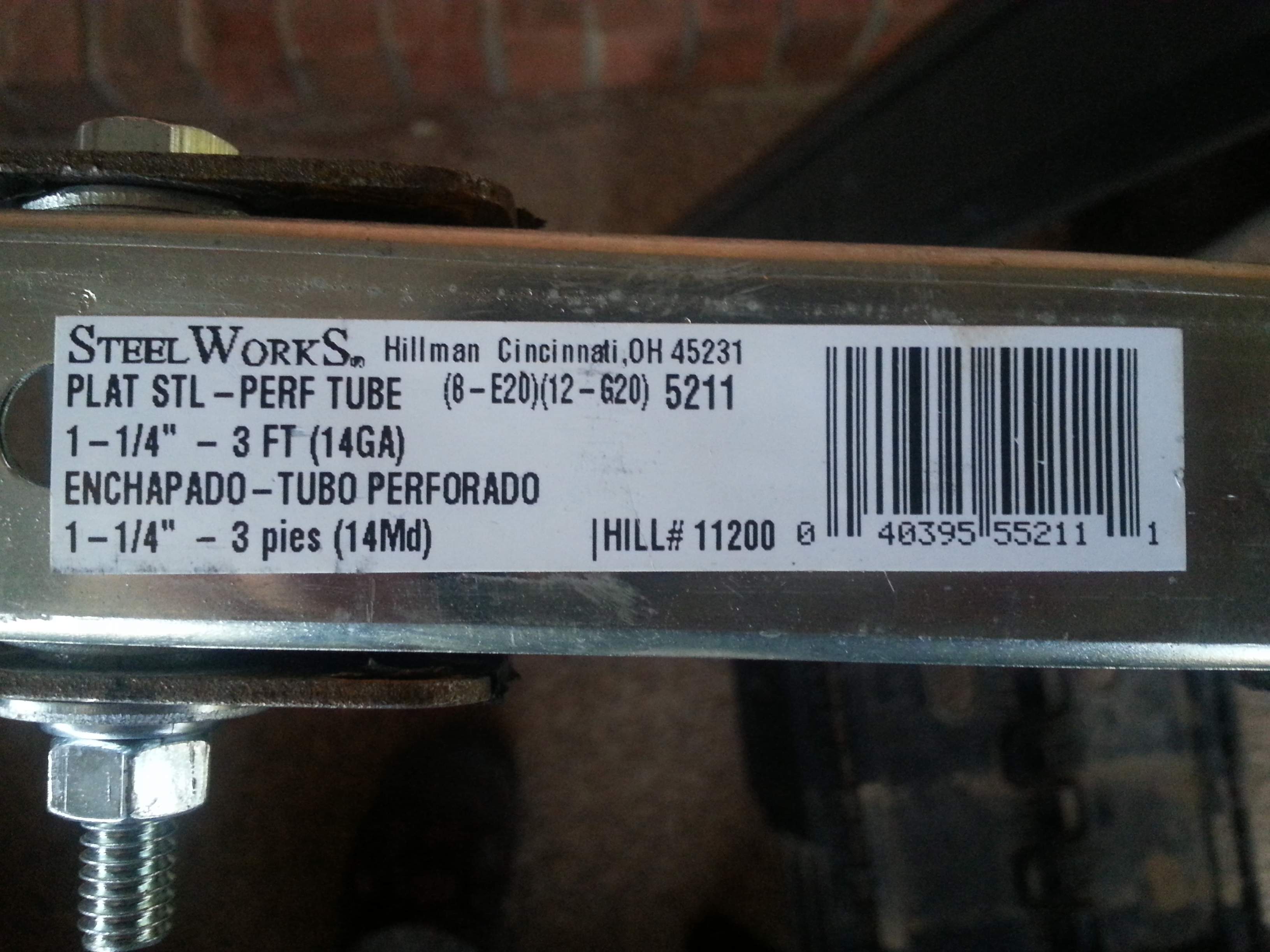

3. Steelworks 3-ft L x 1-1/4-in W x 1-1/4-in H Plated Steel Perforated Square Tube 2 @ $17.24 View attachment 355132
Shop Steelworks 3-ft L x 1-1/4-in W x 1-1/4-in H Plated Steel Perforated Square Tube at Lowes.com
4. 5/16 bolts, 2?ス" long, qty: 15
5. 5/16 bolts, 5?ス" long, qty: 4
6. 5/16 bolts, 2" long, qty: 4
7. 5/16 nuts, qty: 23
8. 5/16 lock washers, qty: 30 or so
9. 5/16 flat washers, qty: 60 or so
10. 5/16 fender washers, qty: 4
Construction:
1. The two 19 pieces of angle were used to hold the two square tubes together. Four 5/16" - 2" bolts were used to connect the pieces. I had to adjust these as I put the teeth on.
2. The hay rake teeth were spaced every 5 holes on the square tubes. The spacing of the holes on the tubes and angle iron were 1 so that the teeth are space at 5 intervals. The hay rake teeth also have a slight dogleg bend at the bottom and I made sure they all faced the same direction. The flat washers and lock washers were used to take up some space between the bar and hay rake teeth as needed. Except for tines that were on both the angle and square tube every other tine was double lock washered and used 4 flat washers.
3. The 2 pieces of angle iron cut 5" long, the 5/16 bolts - 5"??ス??ス long, 4 fender washers, 2 lock washers, 2 5/16 nuts were used to make clamps to hold to the King Kutter Carry-all. The clamps were spaced to fit the carry-all.
4. The rake was connected to the Carry-all with the dogleg of the tines facing inwards toward the tractor.
Performance:
I determined how low I wanted it to go and set the stopper on my draft control to that. To try it out I used it on some pine needles that were on a slope. Results:
1. The rake was pulling the pine needles along, but it was also digging into the ground. I'm going to try flipping the rake 180??ー so that the dogleg of the tines faces away from the tractor.
2. After the tines had raked all the needles it could rake I needed to lift the tines out of the pile, but the Carry-all would not raise it high enough. This is just due to the dimensions of the Carry-all. To fix this I'm going to have fabricate a 3 point hitch that will allow me to lift it higher. I will post pictures of that when I get it done. The plan is to use angle iron.
Bought flat cuttig edges for a 5' back blade from tractor dealer ( now out of Biz ). They are 3/4" below skids.

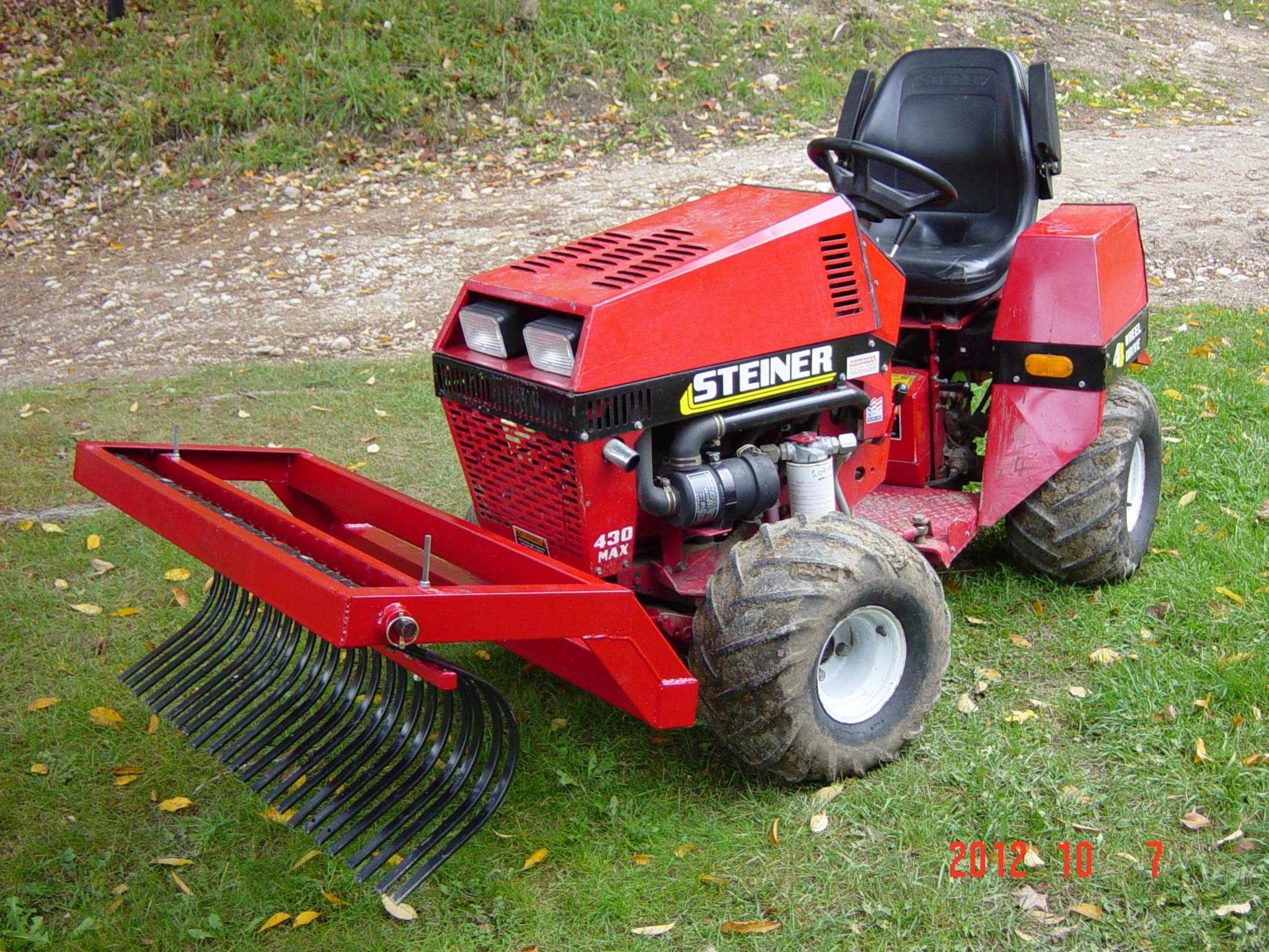

/ Home-made attachments... #10

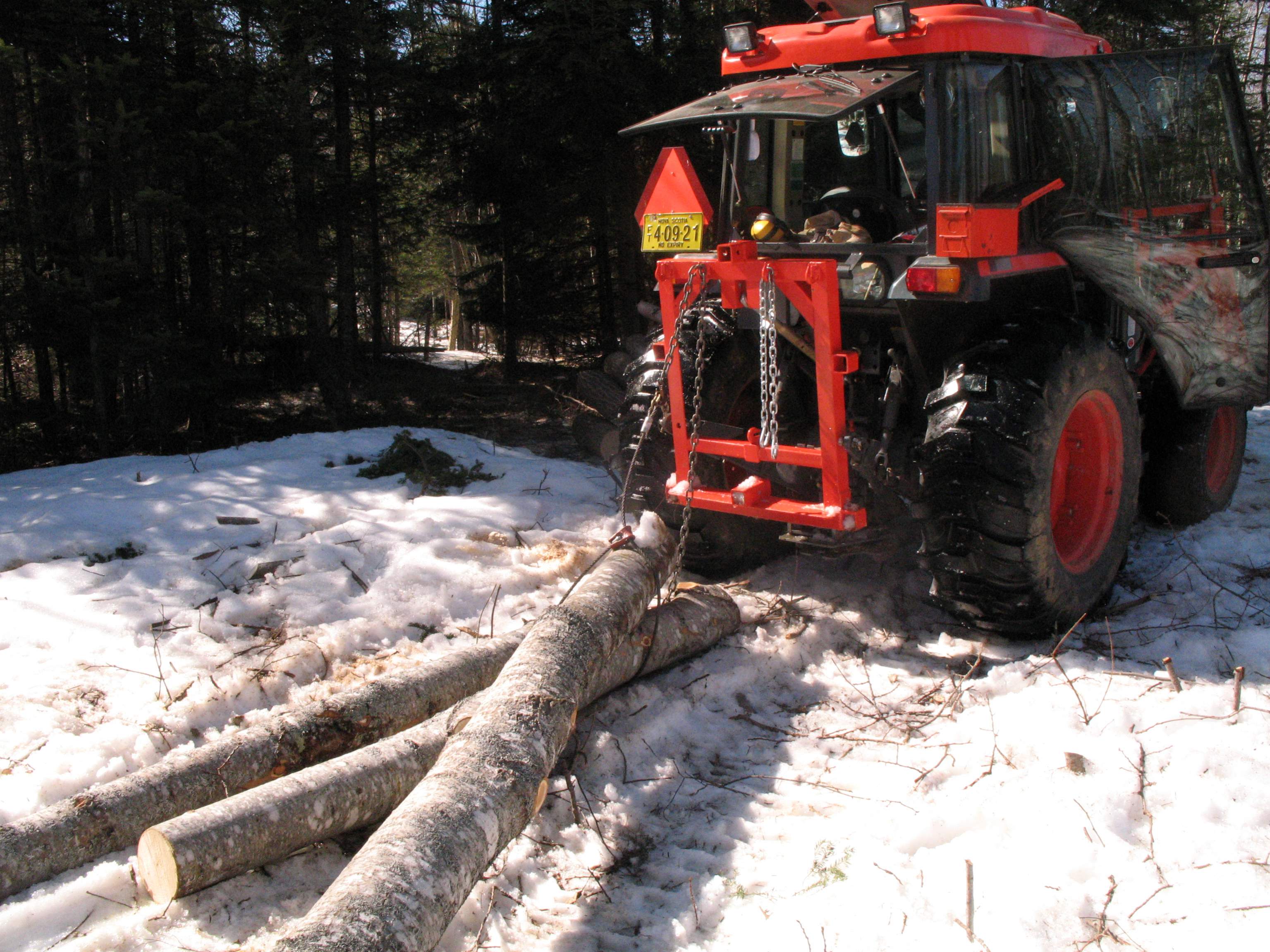

I made this for cleaning up tree branches after felling a tree. The tines can float to follow terrain or be arrested. I cut off part of my finger when pulling this thing off in the dark and finding it had a nasty pinch hazzard on account of that floating design.

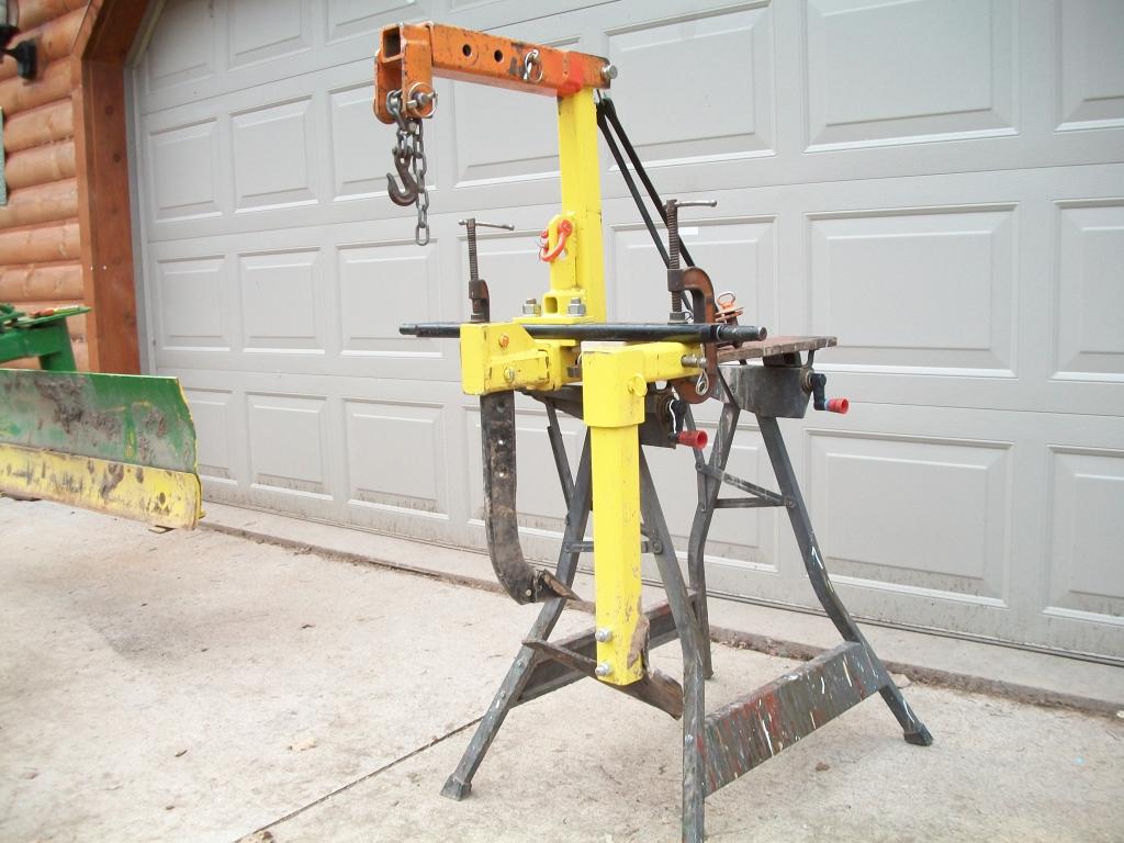

Driveway drag

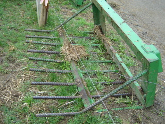

Rock Bucket (I use for manure and firewood more than rocks) actually I didn't notice till after I posted but the pic is the first generation, the rebar tines did not work, broke off under heavy use. The second generation I used 1 1/4" 4140 round rod, have yet to brake one of those even on the skid steer.

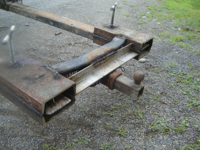

Receiver Hitch that attaches to forks
Also built but no pics at the moment
Bale spear for the loader mounts, gain a couple hundred pounds lift be removing the bucket
10' Boom Pole for the loader used to set trusses on a couple of pole barns.
Ripper tooth for backhoe, use mostly for ice removal in my livestock paddock areas during the winter.
3 point wood splitter
3 point trailer mover
Nice build. And a very nice tractor don't see things like here in oz.
