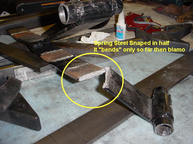

Well the darn thing broke.
Seems my Idea of using Spring steel for the thumb mount was Smart but not Wise. The spring steel snapped in half under too much stress.

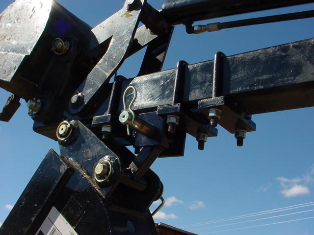

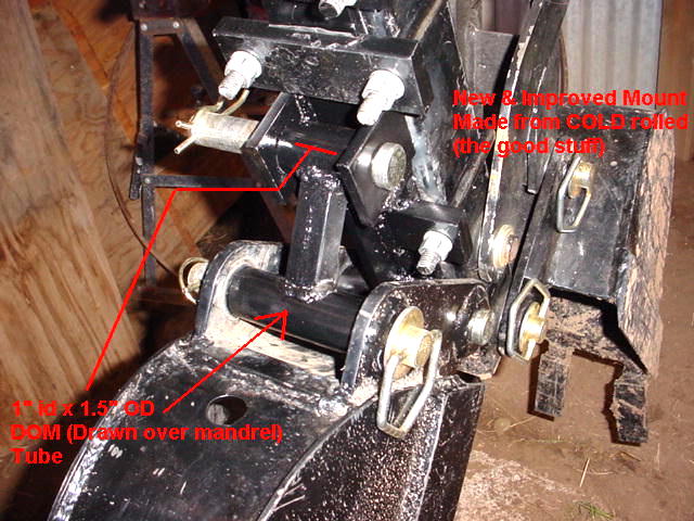

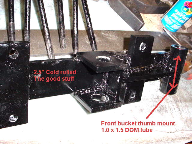

Here is a new & improved version. The only thing I was able to salvage were the square U bolts and the plates that pinch the mount to the dipper. I used Cold Rolled Steel 1/2" thick - (the good stuff) This mount is rigid it does not bend or spring. It works much better.

Attachment New & Improved 1

Attachment New & Improved #2

Attachment New & Improved #3

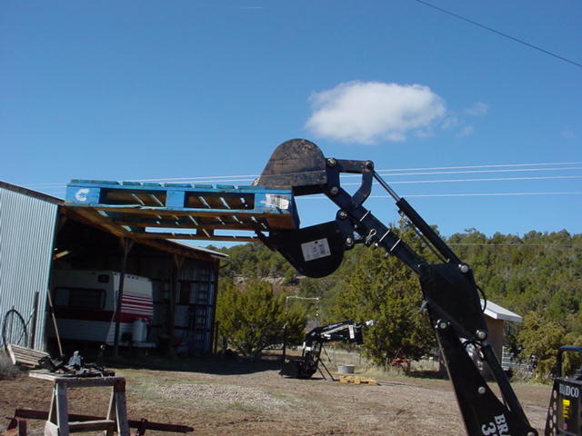

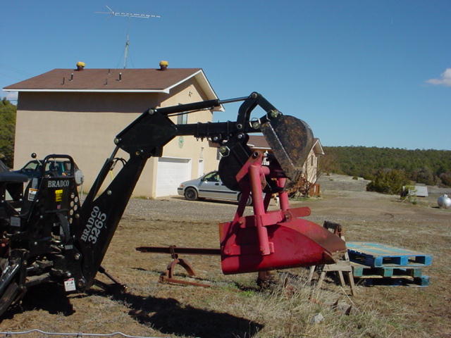

Attachment New & Improved #5
   / Home Made Backhoe thumb #20
Love those action shots!
Now I remember what I should have been doing these last couple weeks! Copying your work!
