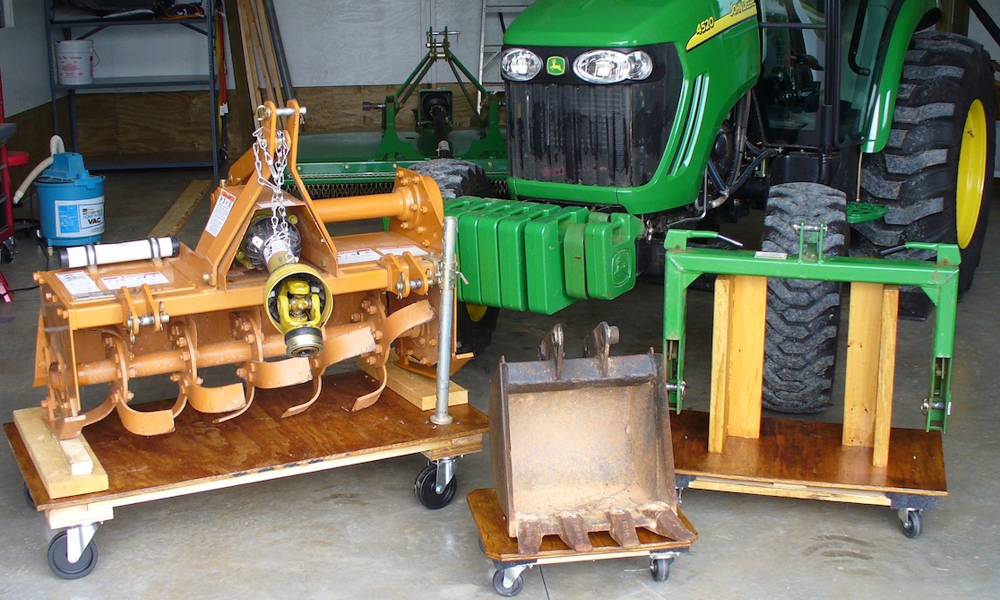

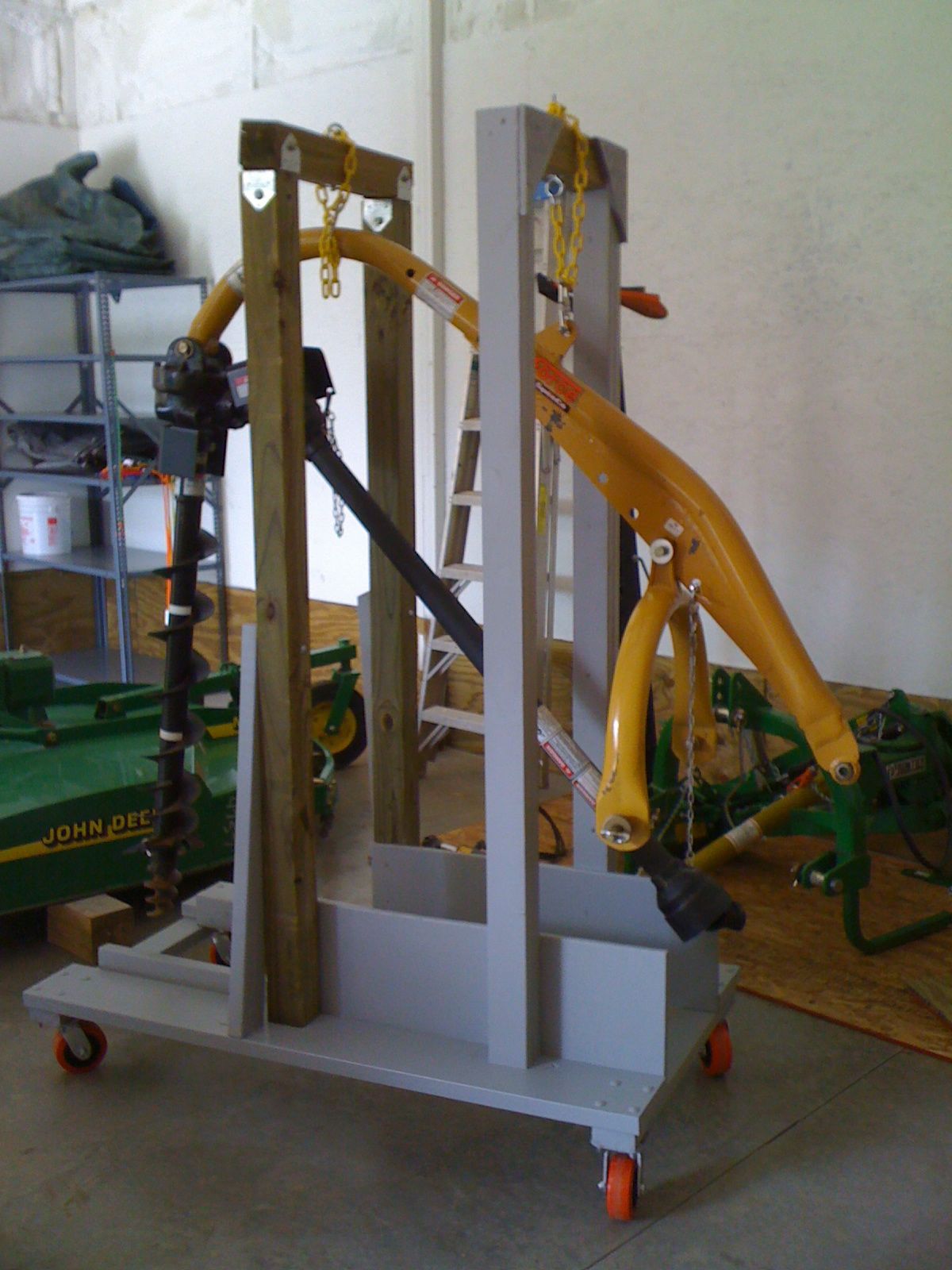

I got mine at Northern Tools (a step above Harbor Freight, but I wish there were a few more stairs I could climb). Here's a picture of my PHD dolly, I used 600 pound casters. These had good wheels and you can grease the ball bearings. I derate by at least 50 percent, usually a bit more. In the case of the PHD, I've got 2400 pounds of castor capacity holding up about 400 pounds of stuff.
Northern also had too cheap stuff. I've also used the Harbor Freight 1000 pound dollies for holding stuff that weights less than 200 pounds. I bolt a piece of plywood to them. You can see that approach in the dolly I made to hold my imatch. I used that approach on a backhoe bucket holder too.
Finally, you can see the tiller dolly I made. It uses the 300 pound castors from Northern. So there is 1200 pounds of capacity holding about 350 pounds of tiller. Got that done, then realized I had to lift up the tiller in order to be able to rotate the drive shaft to connect it.
Long answer to simple question, hope it helps.
