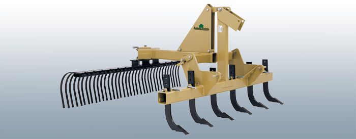

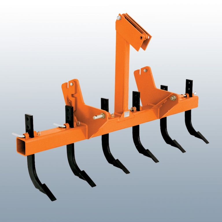

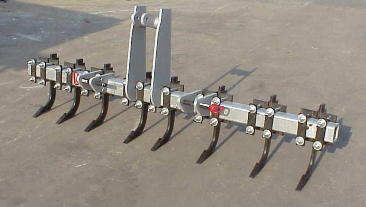

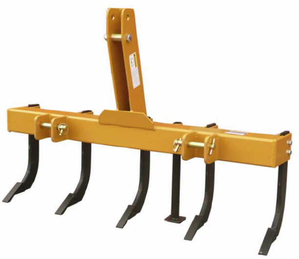

If you have the kind of trees or brush that leave roots in the ground, you are better off using a box blade with the scarifiers down. If you don't have a box blade, you could make a 3 point bar that would do it.
Scarifier or ripper.
Mounted for use on the 3ph.
