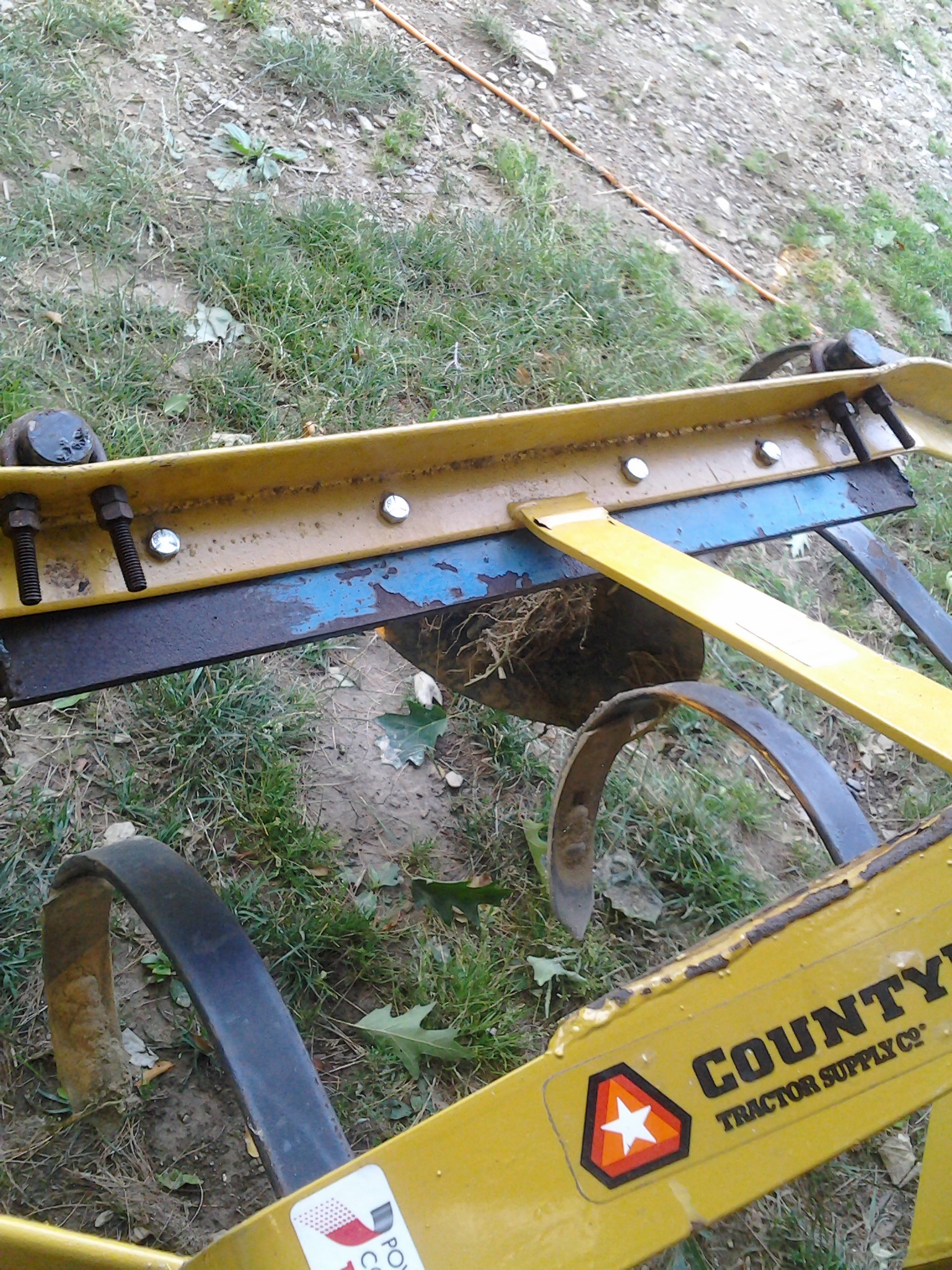

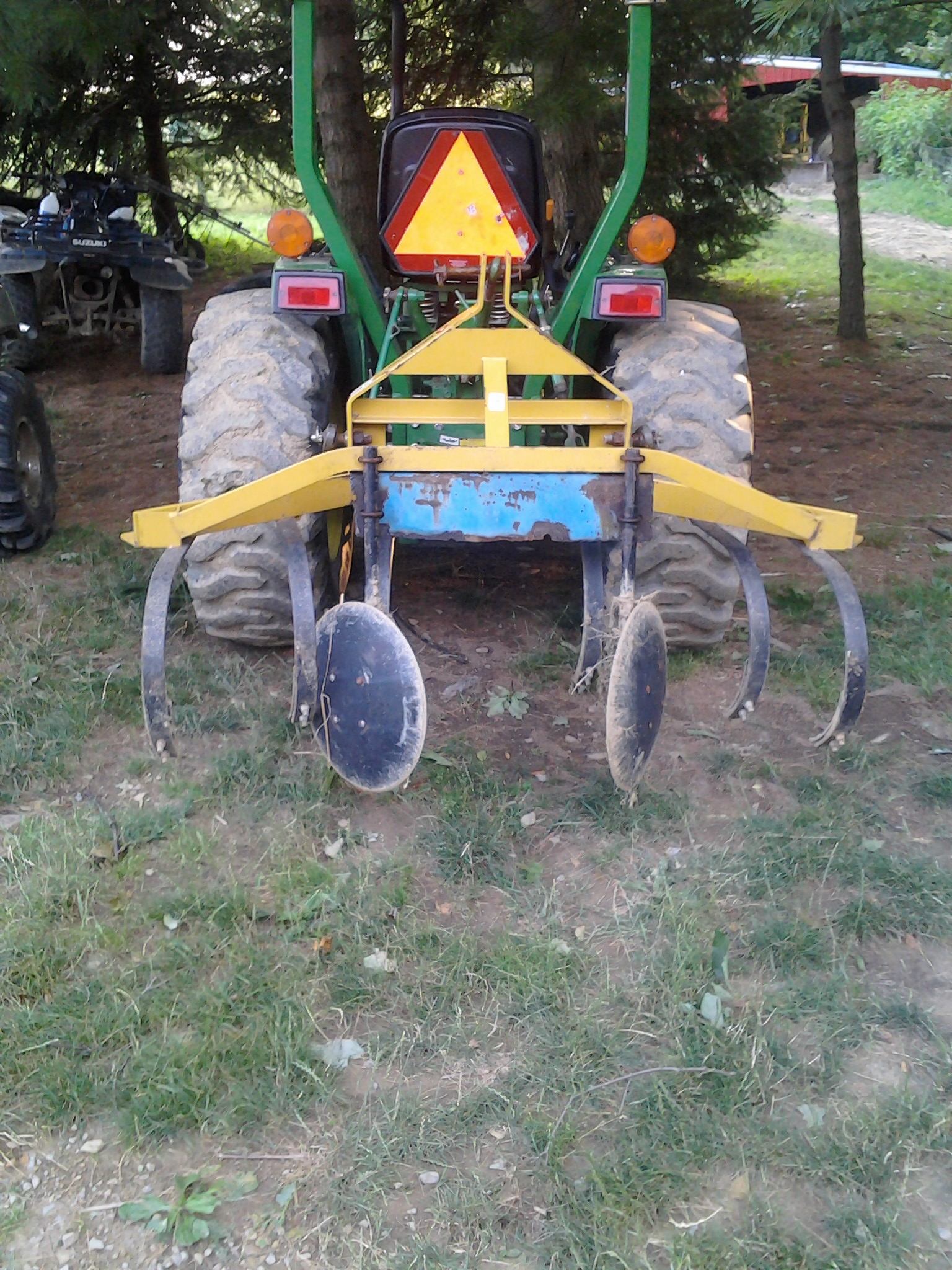

Here's another version for ya. The discs are from Agri-Supply. The cultivator shank is from a Dearborn 13-2 . The shank makes a nice furrow, or flattens the top of the hill to plant on/in. It removes quickly to hill potatoes. I've since painted and fabbed up a mounting bracket for the shank.
Here's a test pass in our kitchen garden.
Another benefit of planting on hills is the nice irrigation furrow produced when drawing up the hills. REALLY needed it this summer. Fortunately, the blackberries were done before the drought hit. I still had to haul water twice a week to keep the canes alive and growing for next year. I'd flood the row with about 200 gallons each time. Mark

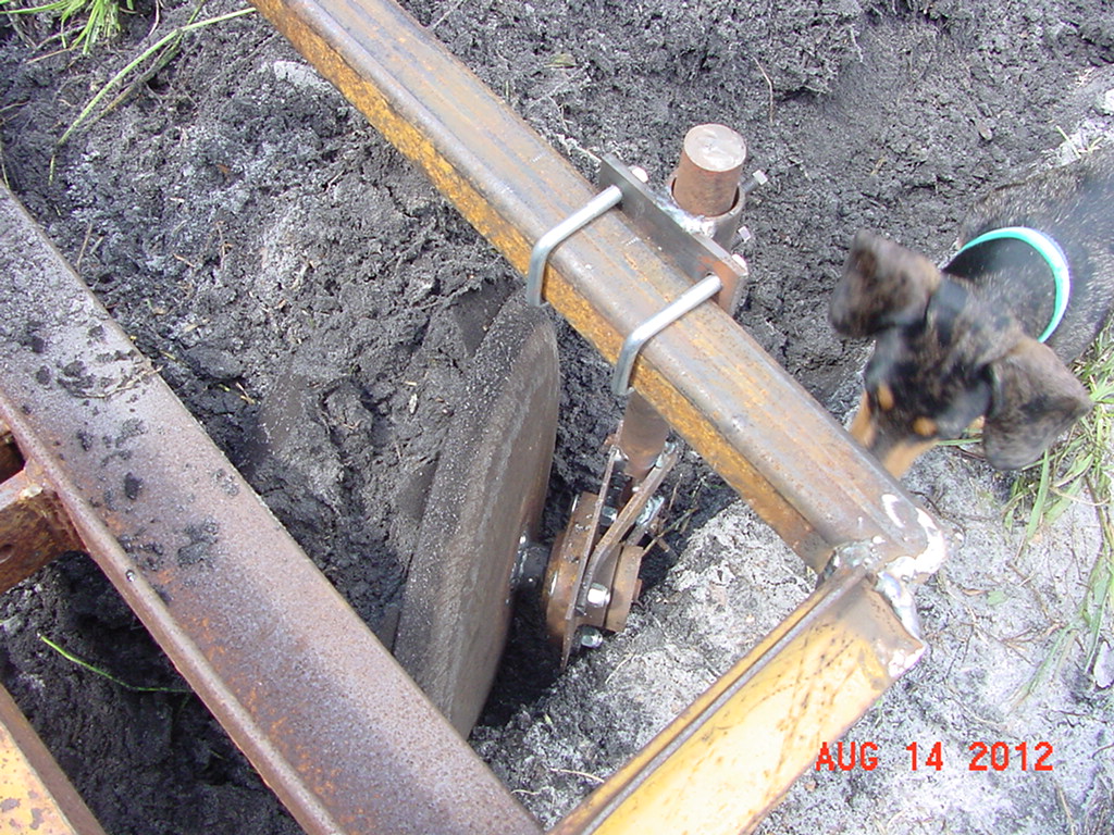

Couln'g figure out how to get the text with the pix. Attachment started life as a citrus box hauler, given to me by a friend. We added the 3" ball on top for moving around the gooseneck trailers. We then added in the spacers and large angle iron to hold the 5 sacarifiers from the box blade - works great. Then I got the idea for the hiller. You can see the disc axle/bearing units, quills from a John Deere mower deck. Everything used was from scrap pile, except the 4' piece of 1/4 box tubing across the back and bolts. You can see it does a pretty good job. Needs cleaned up and painted - maybe someday.
