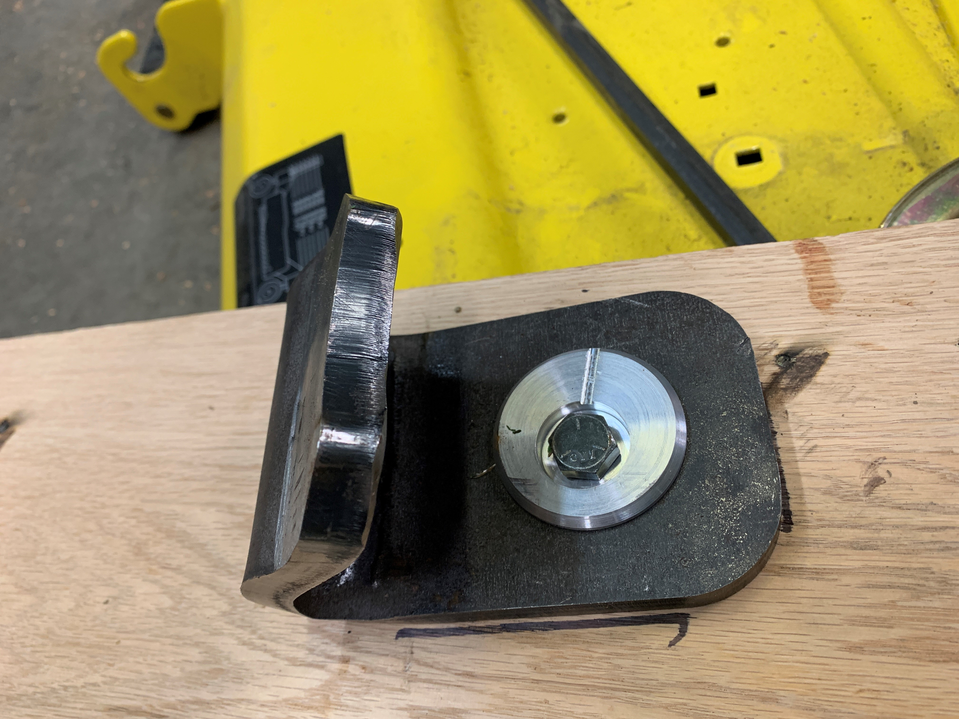

Found some time this weekend to make more progress on the HM Load-N-Go brackets.
The 3/4" plywood was reinforced with another 3/4" layer of oak wood. Corners were rounded over with a router and it has the first coat of JD green paint. Have to wait a few days for the first coat to cure before putting on the second coat. I learned the hard way that if you put on the second coat too soon, then the first coat blisters and you have to start over.

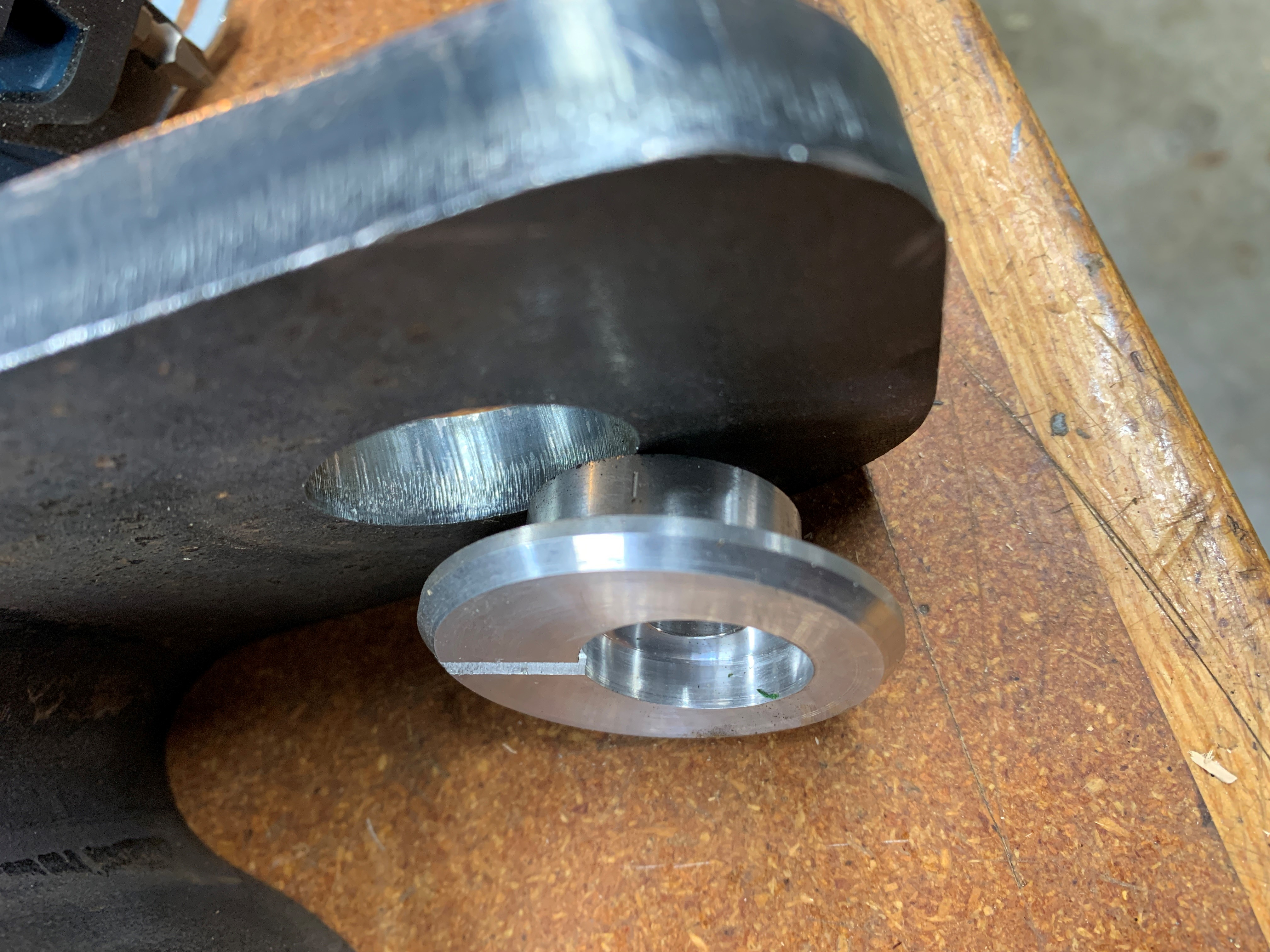

I wasn't happy with the wood hangers for various reasons, the most significant was that they were not properly spaced from the lower pins. So if the deck was in the vertical position, all the weight was being carried by the two pins.
To provide some adjustment for that spacing, a bushing with an eccentric bolt hole was made on the lathe. A slot makes it easy to adjust the spacing with a screwdriver if the bolt is loosened.
This steel hanger from ebay is made from 1/2" thick steel. Just a little bit of overkill.
Putting projects like this on the forum helps me to avoid the temptation to get the project to the point of "good enough" and then going with a partially completed project.

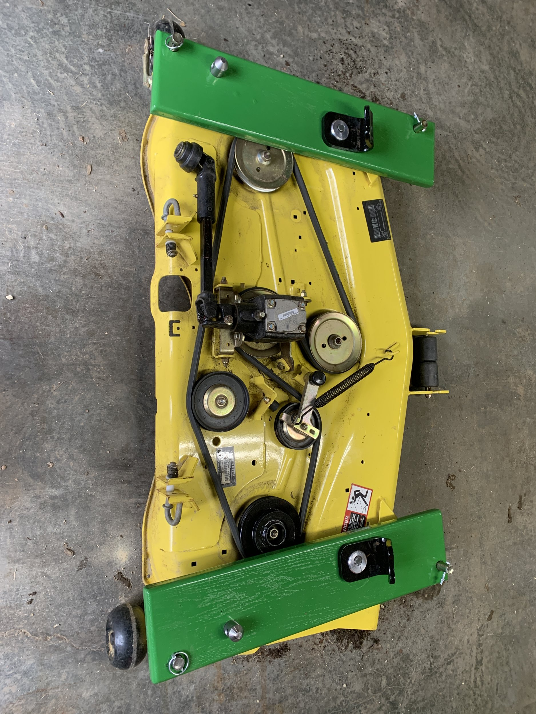

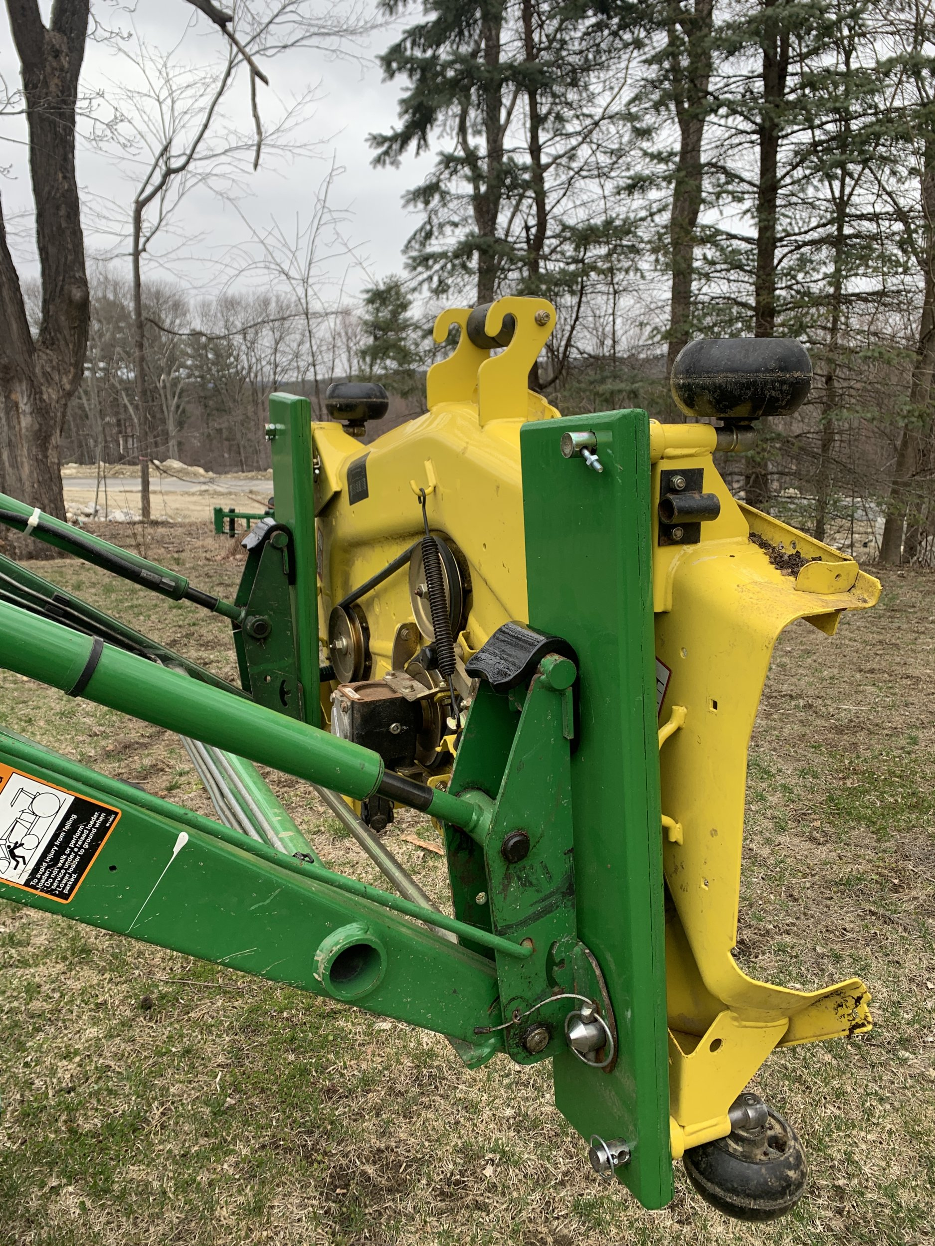

Finished up the load n go brackets.
