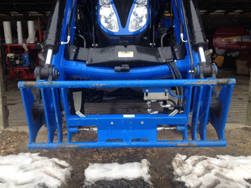

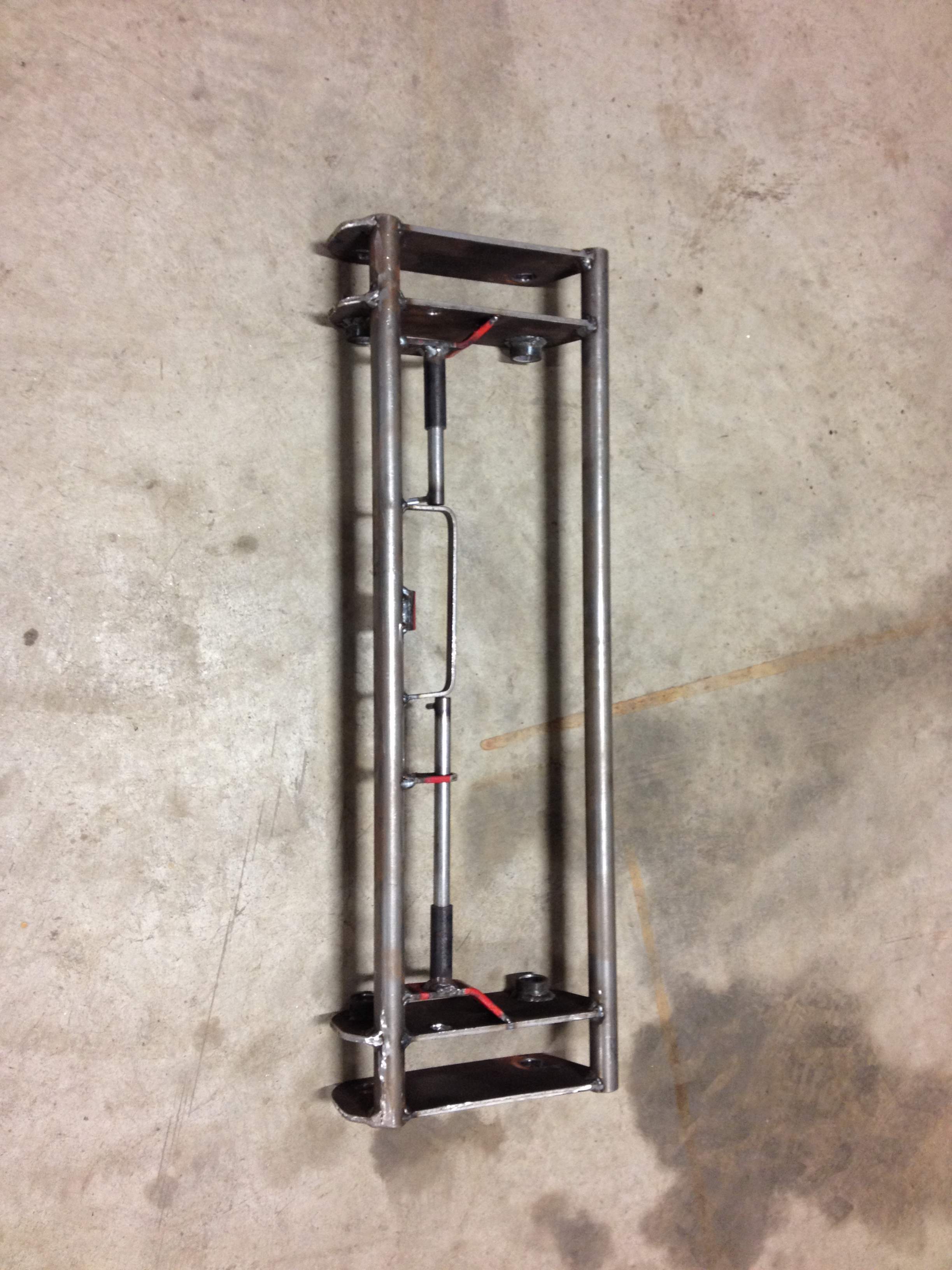

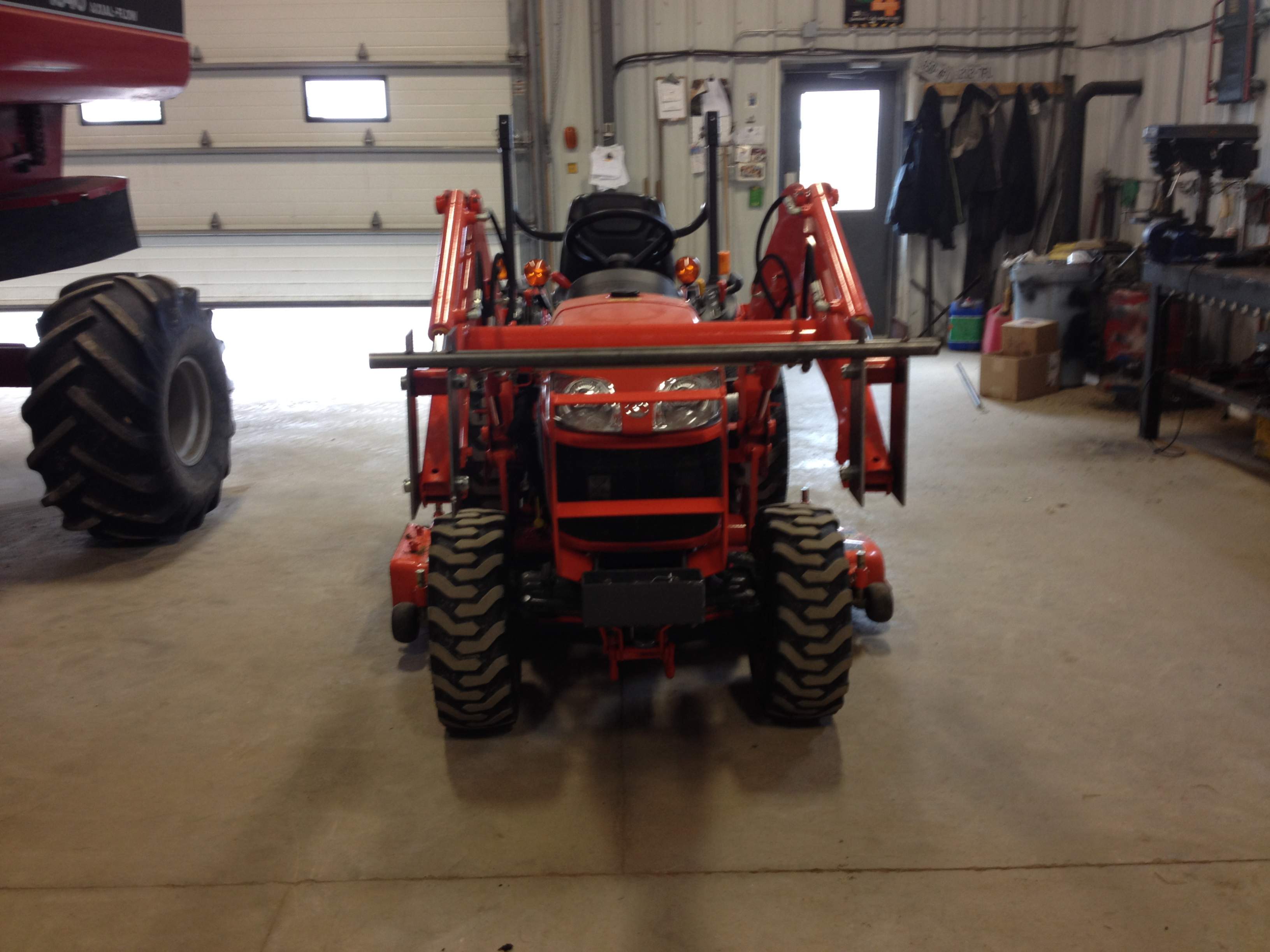

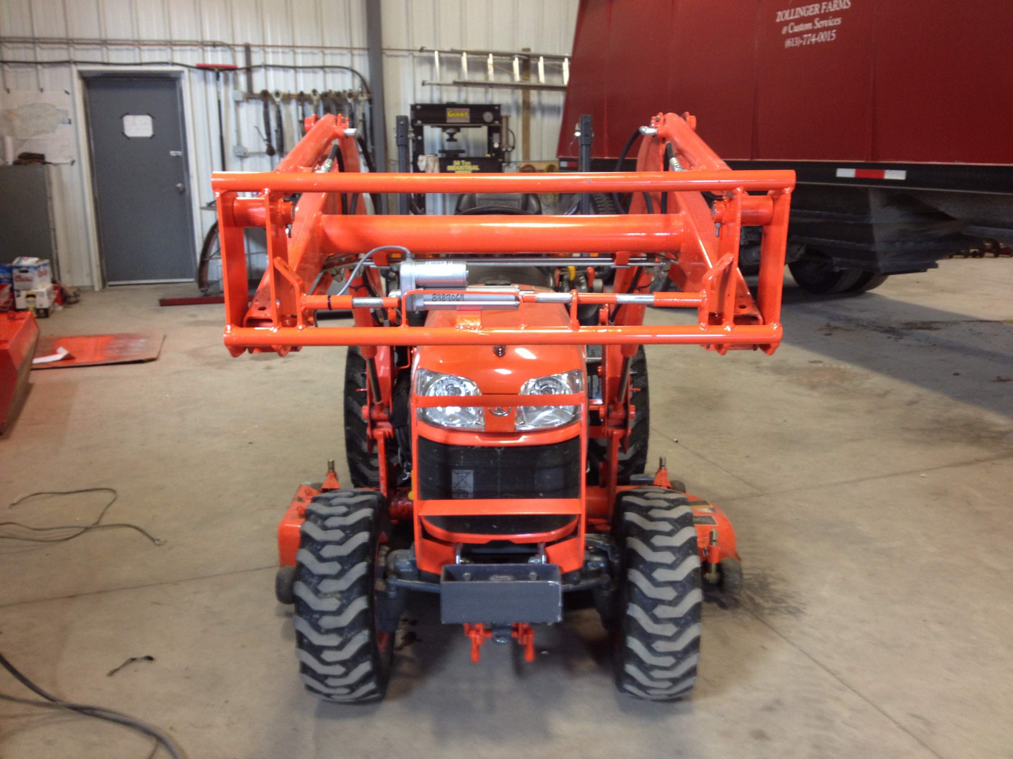

I didn't like the Kubota quick attach option so i built one myself.

Very nice fabrication work. Curious what you didn't like about the Kubota QA option that caused you to go to such trouble? :confused:
   / Home made quick attach
I didn't like walking around the tractor every time. Lol. There was no storage position for the pins when nothing was hooked up. For the most part I wanted something faster and something I didn't have to leave the tractor seat for. But mainly I just love to modify and tinker with stuff. Ha ha.

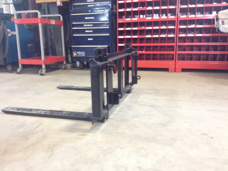

I am not really sure how it works.Did you modify the bucket in any way?Can you post a photo of it with the bucket attached?

Really nice design & fabrication, Blue power.
Looks a little like a rif on the Deere QA, but unique in how you made it remote operable.
I assume you have 2 hooks on the top of the implement & 2 "ears" at the bottom.
The bottom ears get pinned by the servo to lock the implement to the frame.
Looks very light & strong - an ideal use of weight savings to conserve the FEL lift capacity.
Hope you don't mind if I use your design as a basis for my own build?
I'm thinking the same as Kcender a picture is worth a 1000 :)

Not my own design by no means, I copied the Euro quick attach from larger ag loaders.
