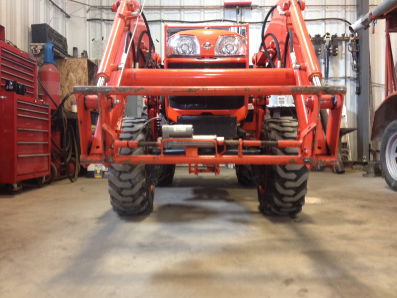

Very nice execution, simple and reliable looking. The best. Could you post a link to your actuator? Those of us with SSQA who have been messing with actuators probably wish we'd thought of this before going to the trouble of moving the two lever arms. (at least those of us who have modified conventional bucket/loader arms to be QA.)
I don't realy know much about the actuator, I bought it at Princes Auto for $90.
/ Home made quick attach #25
How do you attach the opposing rods to the actuator?
You did a great job.
