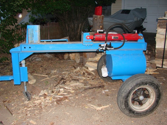

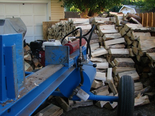

Sep 9, 2011 / Home made splitter kicks A** #1 moose13 Bronze Member Joined Apr 15, 2011 Messages 70 Location Somewhere USA Tractor none Finally got to put my splitter to the test. Split about 6 cords without a hitch. Attachments DSC05687.JPG 76.1 KB · Views: 1,462 DSC05698.JPG 104.9 KB · Views: 1,665
Sep 10, 2011 / Home made splitter kicks A** #2 M mrmikey Elite Member Joined Oct 17, 2010 Messages 2,645 Location Nova Scotia, Canada Tractor Iseki TM3160 Nice build, I like the height. What's the resevoir, a water tank?.....Mike
Sep 11, 2011 / Home made splitter kicks A** Thread Starter #3 OP moose13 Bronze Member Joined Apr 15, 2011 Messages 70 Location Somewhere USA Tractor none Thanks! no, its 18 or 20 inch pipe. The height works well as i am 6'4.:thumbsup:

Sep 14, 2011 / Home made splitter kicks A** #5 davygp38 Gold Member Joined May 29, 2009 Messages 478 Location where NY,NJ, and PA all meet Tractor Kubota L4400 What size/make engine? Approximate spitting force? Looks clean, I like the pipe reservoir.
Sep 14, 2011 / Home made splitter kicks A** Thread Starter #6 OP moose13 Bronze Member Joined Apr 15, 2011 Messages 70 Location Somewhere USA Tractor none I went with the Honda 200 GX pro model for the engine. 13.6 gmp pump and 24" cylinder. Someone smarter than me figured it to be about 22ton.
