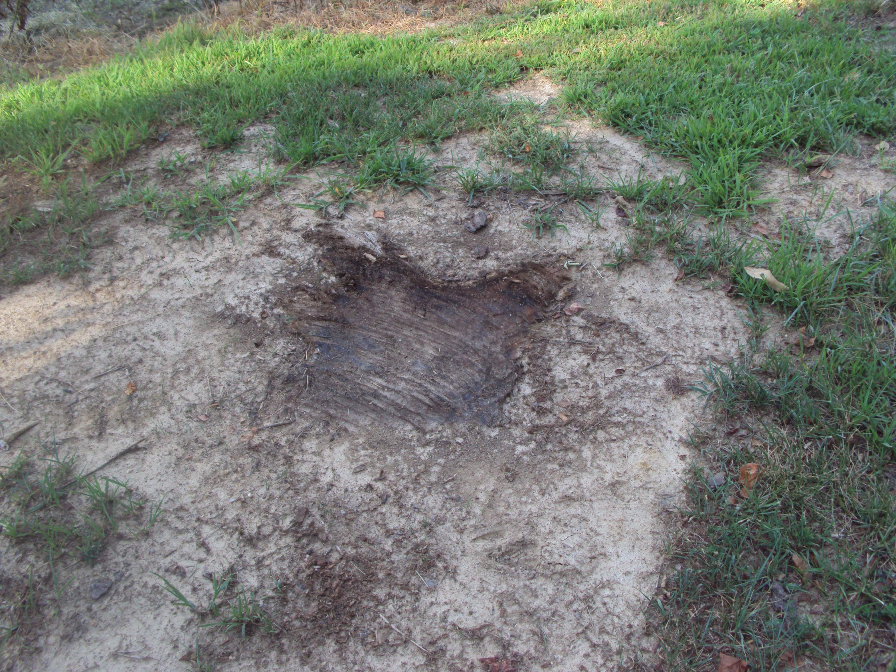

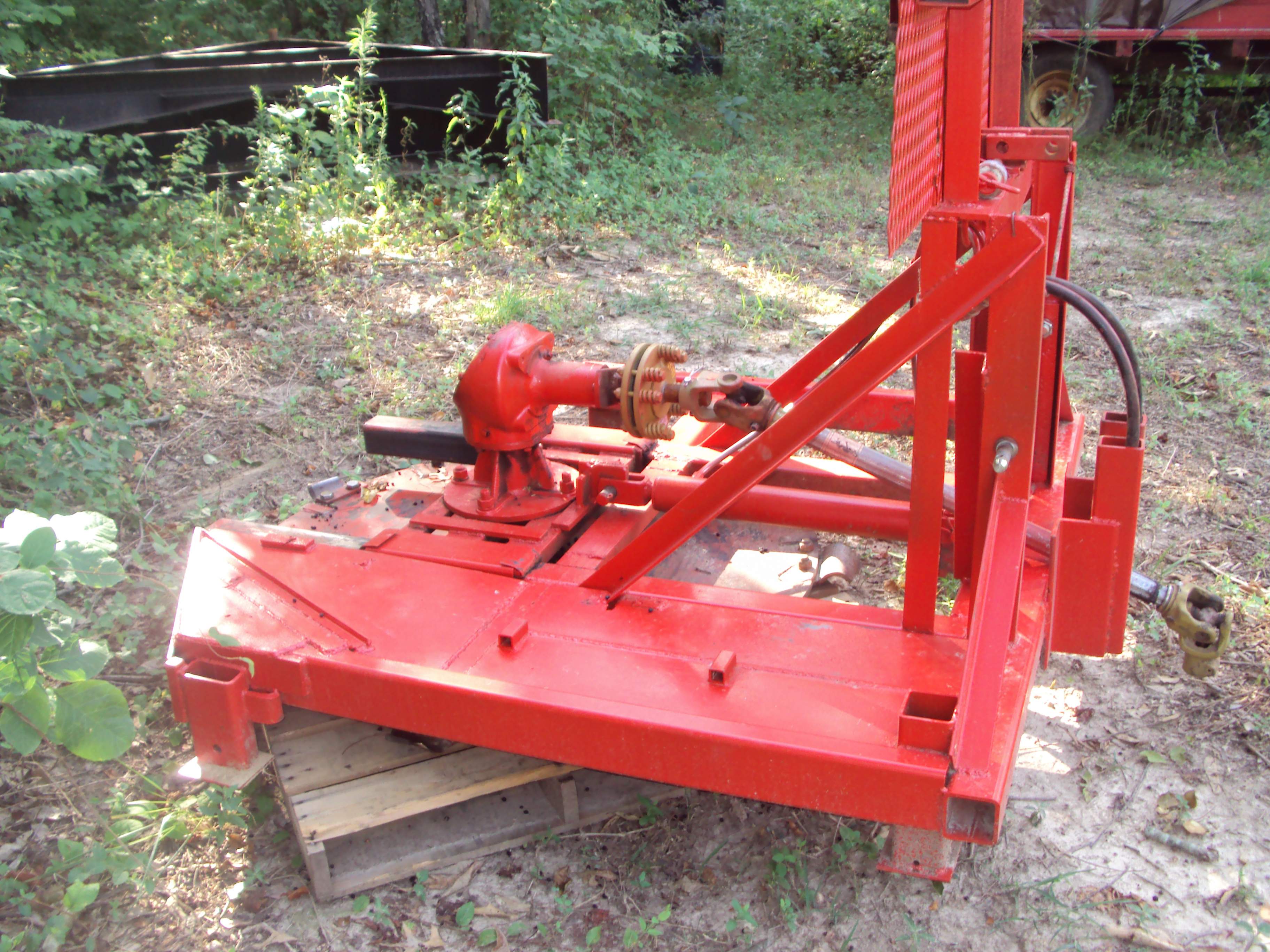

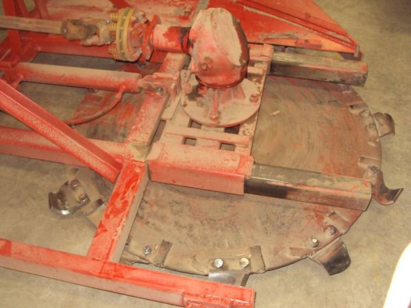

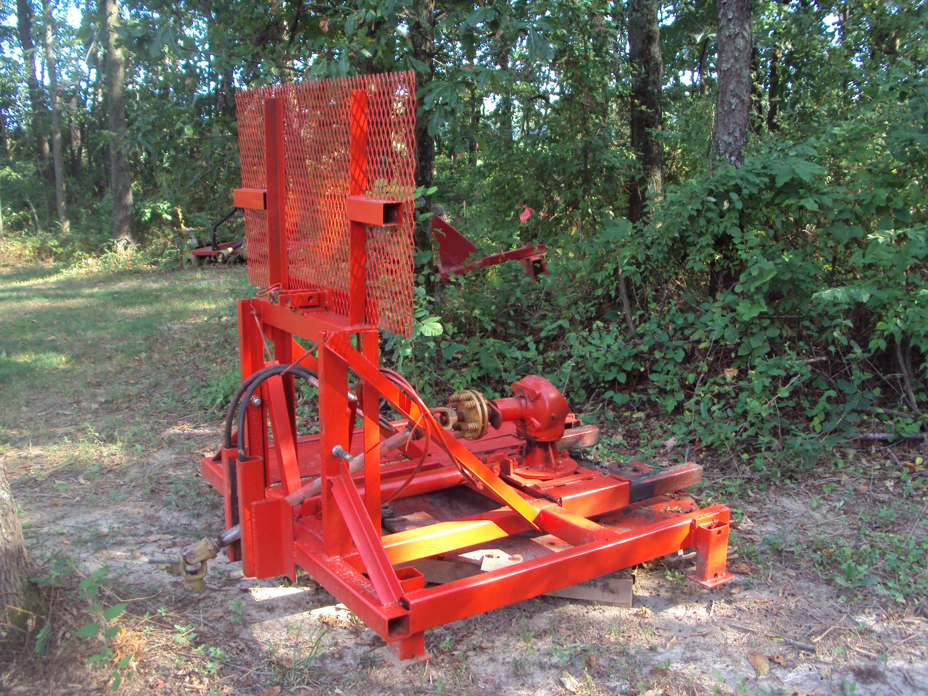

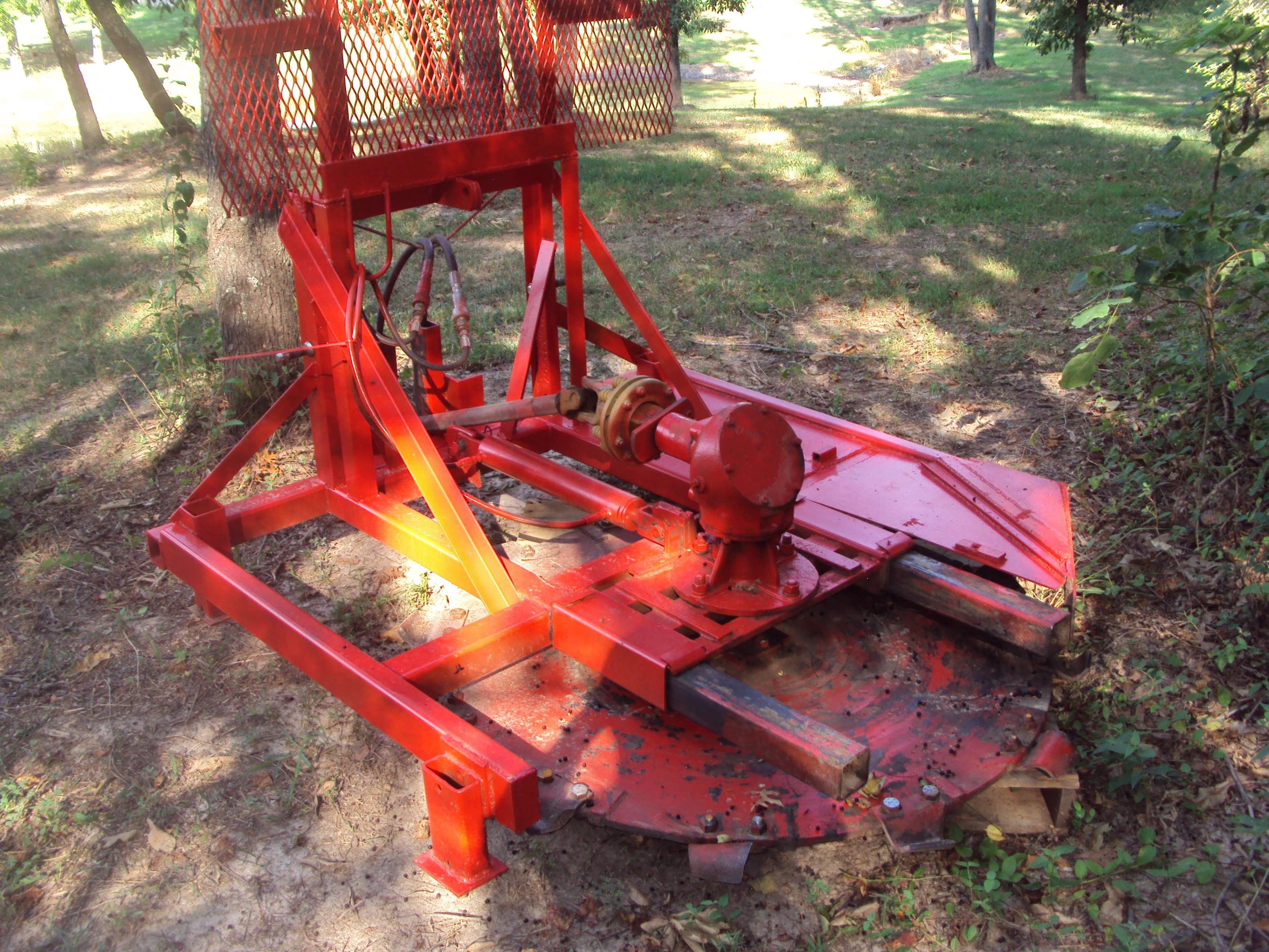

Has a 6' half inch thick wheel with teeth from a trencher. Hydraulics will slide the wheel back maybe a foot and half or you can back the tractor over the stumps. I bought this off an elderly gentleman who built it himself. It will flat chew threw a 8 inch stump in less then a minute, depending on how aggressive you want to be. If the tree is leaning correctly, I can go after it without getting the chainsaw out. I really like how there are very few grindings to pick up. If tractor is level and top link is set level, I can go an inch or 2 below grade. Adjusting the top link down and she will really throw some dirt and dig down. She can throw some chunks when cutting aggressively, if I take my time, she's not bad at all. Works pretty well on the homesite where we cleared out land in the middle of the woods. I already have done 20+ stumps, think I got my $1100 initial investment out of her already. DSC00328.jpgDSC00330.jpgDSC00329.jpg5Ed5Fa5Ja3L43I63J9c7148ba6242c6f5115c.jpgDSC00331.jpg

It runs 540 pto and originally was a 310 MCCORMICK-INTERNATIONAL ROTARY CUTTER (1/62-12/66). I have diagrams and part numbers for every part on the gear box from the seller. The heavy wheel creates a lot of momentum. Speed is very comparable to a regular bush hog cutter. My pto is rated at 29 hp, have to feather it up to speed a couple times to get it spinning. It's all the lil Mahindra wants.
