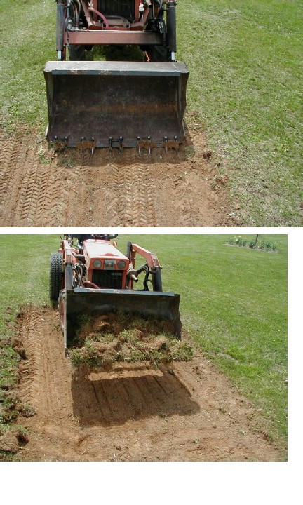

Here are some pictures of the toothbar I made for my B6100. I described the planning design in <A target="_blank" HREF=http://www.tractorbynet.com/cgi-bin/compact/showthreaded.pl?Cat=&Board=implement&Number=109898&page=&view=&sb=&o=&vc=1#Post109898>This Thread</A>. Because I continue to be "welding-equipment-challenged" I ended up just bolting the points to the bucket edge.
I've used my toothbar now for this small project shown in the attachments (peeling up sod for a new garden) and to move the dirt (about 4 yards I'd guess) in my <A target="_blank" HREF=http://www.tractorbynet.com/cgi-bin/compact/showflat.pl?Cat=&Board=projects&Number=156424&page=1&view=collapsed&sb=5&o=&fpart=>Garden Project </A> Thread.

I often wondered if something like that would work. I had thought about sickle guards for bucket teeth on my powermax loader but didn't know if they'd be tough enough. Definitely sharp enough!
Are these combine guards the same as sickle guards? How did you mount them? Do you have a close-up pic?
