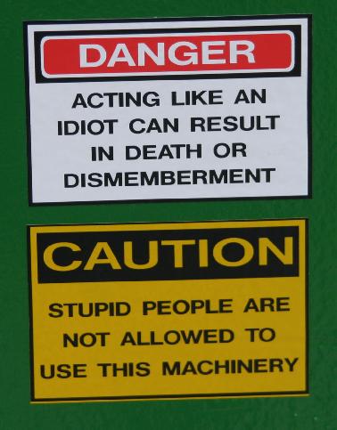

Do you have a clearer picture of your stickers? Where did you have them made up? How did you make your Texas stars?

Attached is clear picture of the warning and danger stickers I had made at a local print shop.
